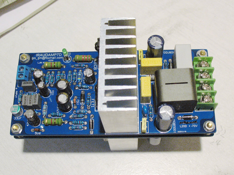

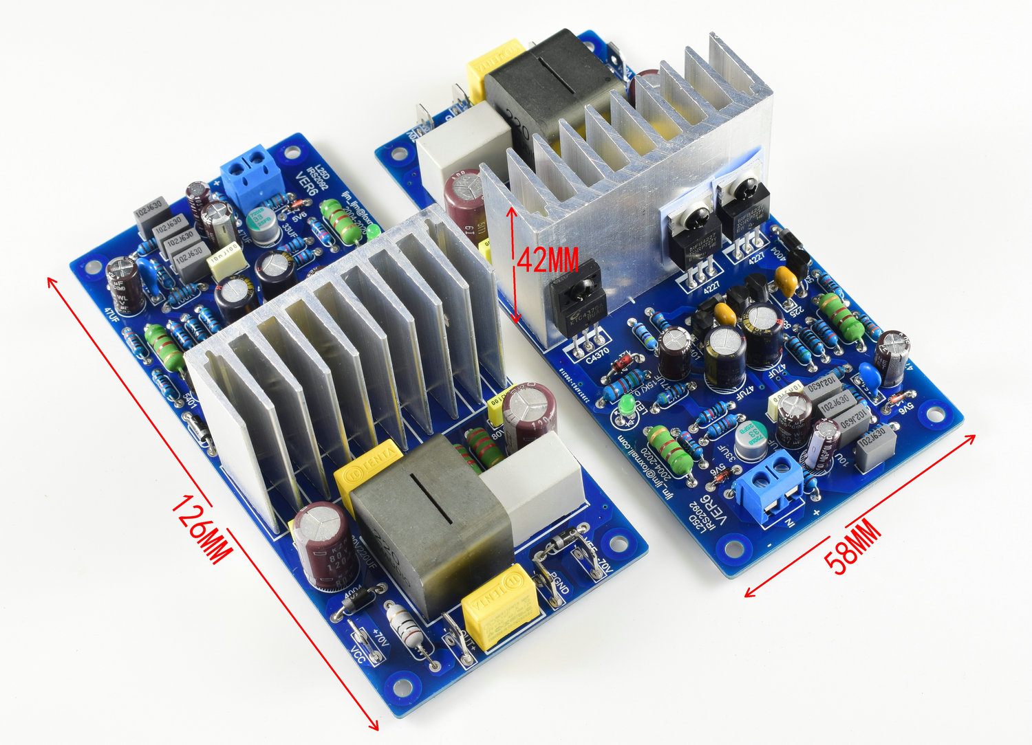

My design L20D IRS2092+IRFI4020H 200W8R
In the ebay listing I bought mine from, a year or two back(still not in a case), it said +/-72Vdc.
Maybe that is a different version of the L20 digital amp modules?
The l20d can use a wide range of voltages.
For example, + - 60V, or + - 70V, 72V can also be used.
Because the manufacturer's components will also change. So sometimes I change some components.
But basically it won't change much.

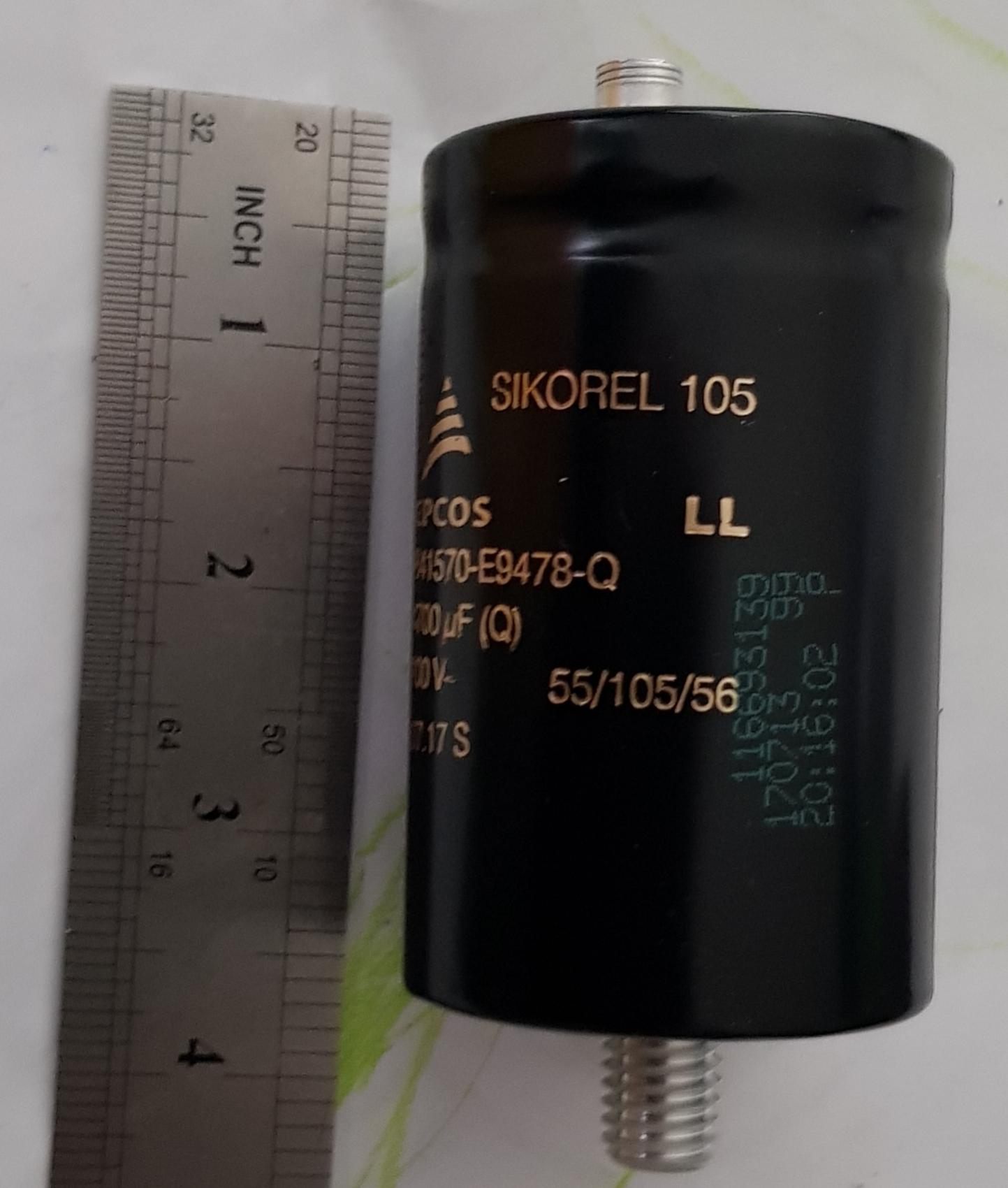

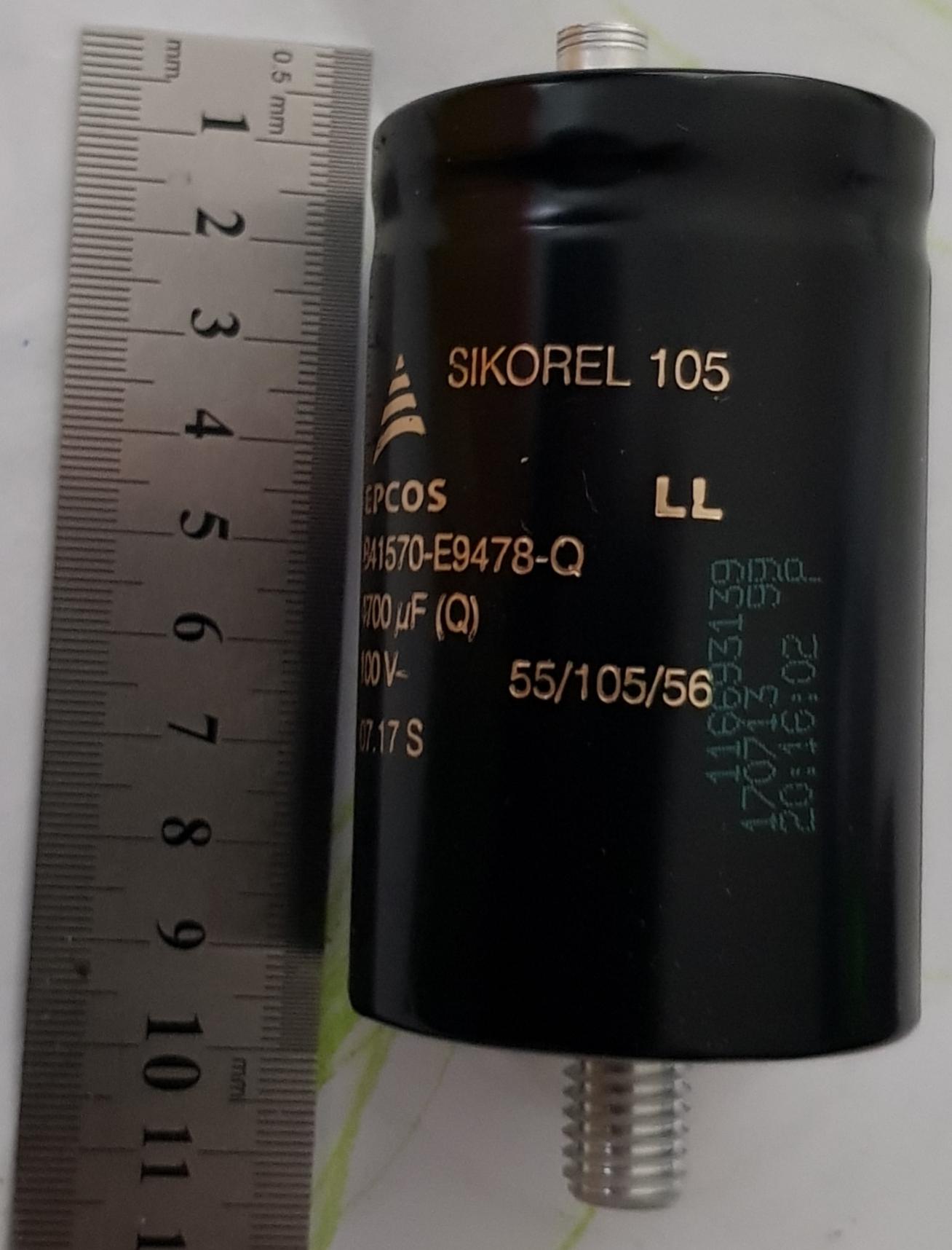

I did put in higher voltage capacitors, and I swapped the big resistors for higher rated brand name ones.

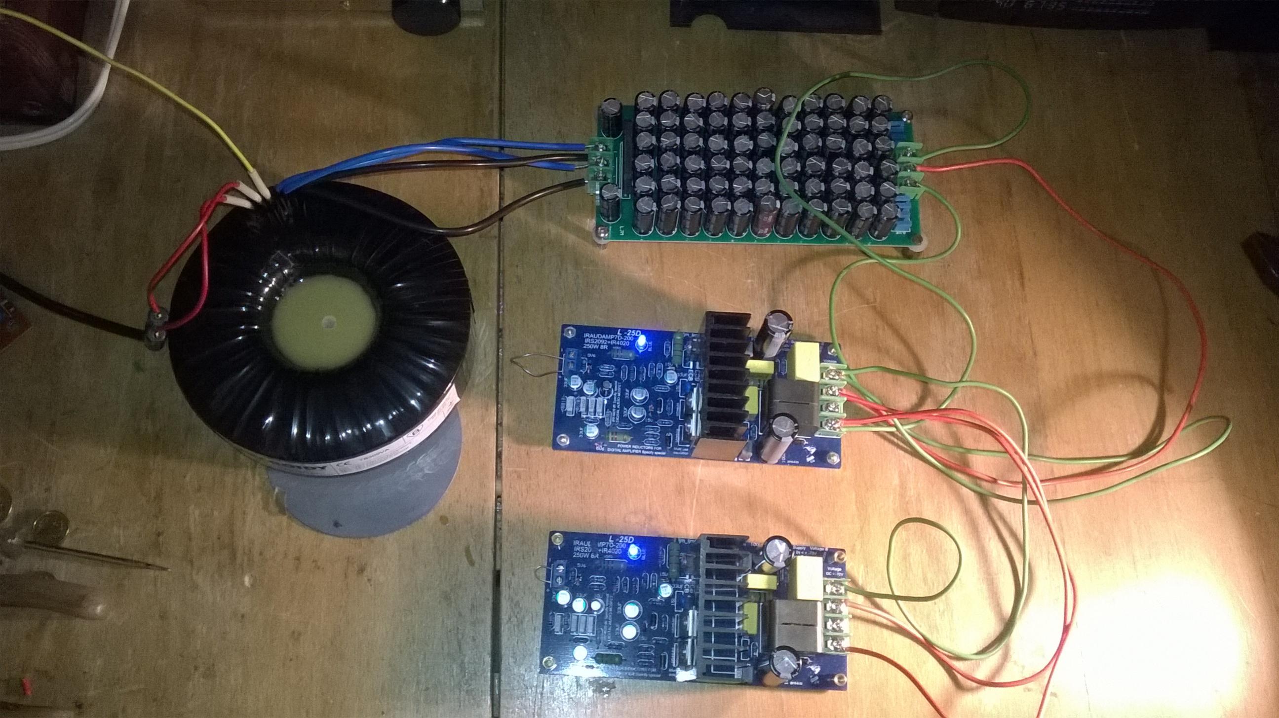

It's just sitting there waiting for me to either go with the +/-72Vdc SMPS or an "audio grade" toroidal transformer from toroidy and some 4x6800uF/100V Epcos capacitors(per rail).
In case of the latter, I'd have to get a new/used bigger enclosure.
Wow, I've looked at those "a ton of caps" boards.
I went the other way big cans that you bolt to the chassis and connect via screwterminals.
Edit: They were 4700uF/100V 4pcs/rail.

I don't recommend SMPS.
It is used in general in the family. Actually, it only needs a small transformer.
For example, ac36-0-36 200va. About $20.
It's good to use l15d or l15dsmd.
There may be many problems with SMPS. And its power, does not judge the real power.
I do have the 600VA 0-?VAC + 0-?VAC.
I do remember it's ordered to be about +/-70Vdc after the rectifier bridge.
I have the Epcos cans, so might as well use them when I get around to wiring it up and putting it in a case, that's all that's left.
I've got a soft start ready for it as well.
I think the MOSFET produced by irfb4020 IR company has always had a big error recently.
Different places of origin differ too much. It mainly refers to the temperature.
So I'm going to modify the MOSFET. Refer to iraudamp9.
I changed to irfb4227 MOSFET. Irfi4227 is also used. Basically the same.
