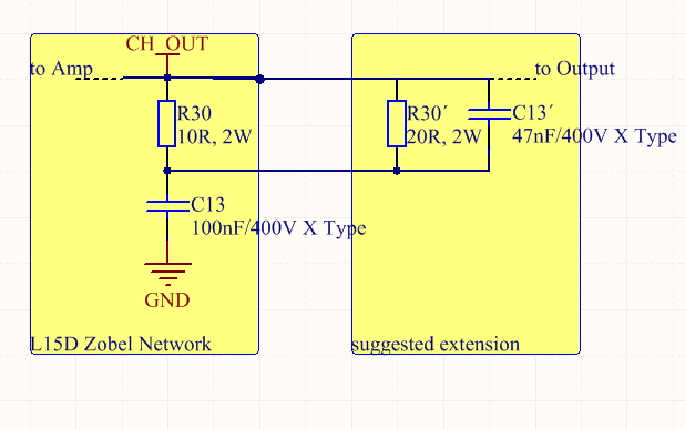

I´ve posted this request in the wrong forum probably (bazaar), so I try here again. (The thread seems deserted).
The modules (L15D) are working well, but when I have some signal on the input and no load on the output, then R30 (10Ohm 1W zobel resistor) starts to produce signs of smoke. There must be a hell of RF energy going into it.
This resistor is darn close to the power filter electrolytic.
Although this is no problem during regular use, there may be a problem when one of the dc protection modules cuts the load off. During start-up this happens regularly, but only for one or two seconds. Also, a cable might become faulty or somebody might unplug the speaker. There is no guarantee the load is there.
Has anybody observed this or knows alleviation to it?
I suppose that´s what R31, the 2k2 shunt for the load is there, but it seems not to work.

looking at the L25D board, which has a 10 ohm 2 watt resistor in that location ... it's part of the output parasite dampener and connected to a small cap that connects to 0 volts as well as to the output signal. What's happening is that the parasitics are just slightly more lively than expected and trying to bust loose. The load its self is enough extra dampening to kill the parasites. You could a: replace with a resistor with double the power rating. b: add another resistor in parallel with it .. about 20 ohms and a cap in parallel with the one I just mentioned that is about half the size of the cap that is installed there. The first fix won't kill the parasite, but will absorb it. The second fix will probably kill the parasite so there will be little to nothing to absorb. ... You might check the values of the resistor and capacitor and verify that they are correct. This sort of suggests that the cap or resistor may be off.

Is that what you mean?
Or do you mean another identical Zobel network with 20 Ohms/ 47 nF in parallel to the existing one?
put the cap in series with the new resistor in stead of parallel .. in other words .. in parallel with the old cap. in other words again, just raise the current capacity of the filter/dampener they put there ..add about half the current capacity. 20 ohms and 47nf sounds about right I did that trick on some iraud200's that were bugging out just like you said, and the problem solved .. you don't have to solder this to the board, you can connect the rc network straight to the boards output-ground if you like. If 20/47 doesn't do it, you can add another full 10/100 .. the network will be like having your speaker load there for ultrasonics.

I will apply both measures, does no harm: double the original resistor in wattage and add an external network (to the screw terminals) with 22R/47nF.
(The PP caps for the voltage needed tend to be quite clumsy, so there is no space under the board.)
I ordered some 22R / 2W metal oxide resistors and some 47nF 330V class-X2 polypropylene caps. It will take a few days, but I will come back to report.
-h
I changed all 10Ohm to 2x10Ohm/2W resistors and added the 22R/2W+47nF network as you recommended. The caps turned out smaller than expected and all fits snugly under the board.
I also ordered some 3n3/500V NP0 (C0G) ceramic caps which I fitted over the 1nF supply filter cap and, per recommendation from Bob Cordell´s book, across the output filter cap. This cannot harm.
The Zobels stay cool this time during off-load periods (don´t want to do an hour torture test🙂). So this worked, thanks.
