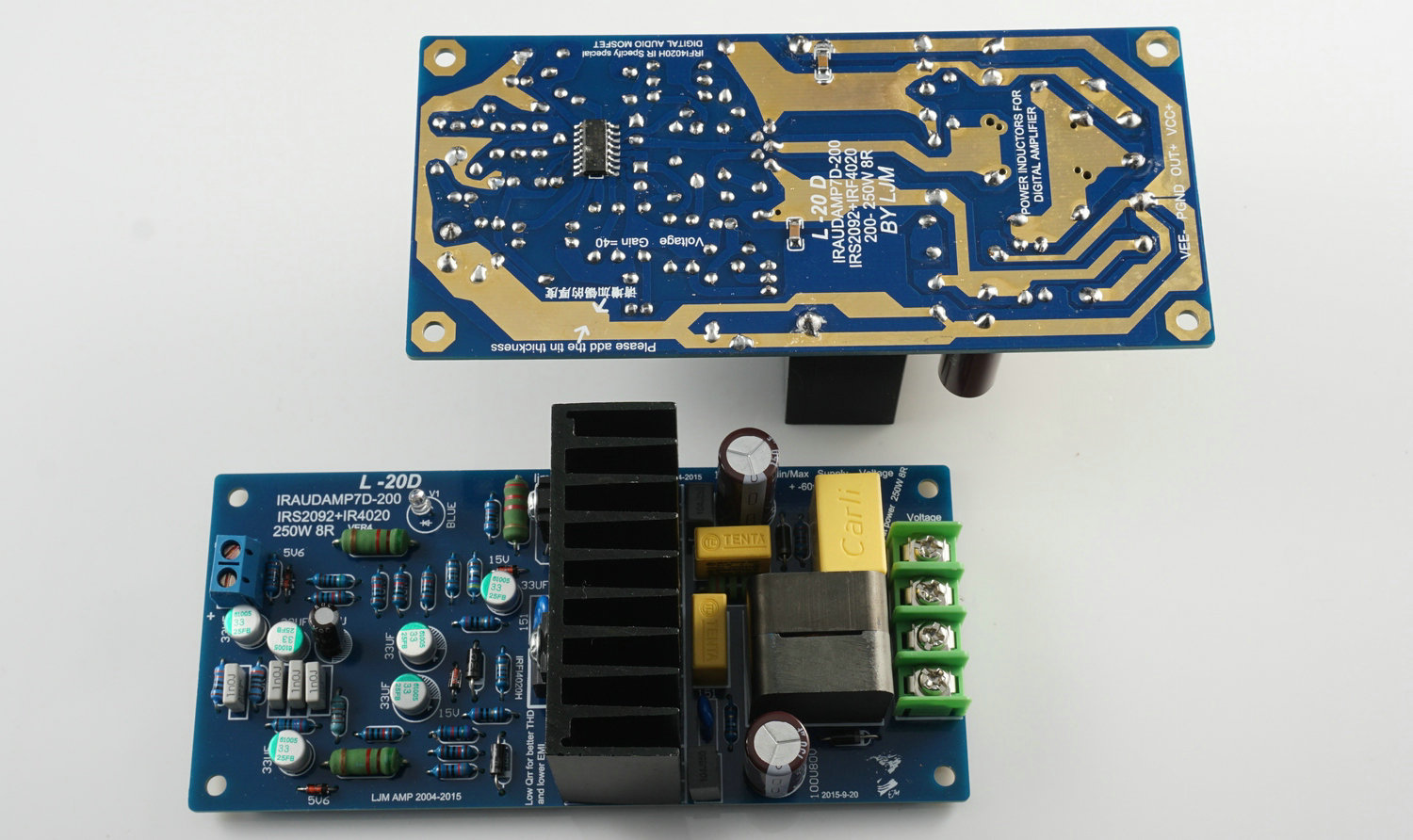

I recently received a pair of L20D amplifiers (assembled) from ebay. On the back of the board it says 'please add the tin thickness' with arrows pointing to exposed tracks. Am I supposed to tin these with solder? I was looking at LJM's photos at the start of this thread and he does not appear to have tinned his.

You can ignore it.
This is can use tin, increase the PCB conductive performance. Reduce resistance.
The bare position can be through the larger current.
You can ignore, use directly.
