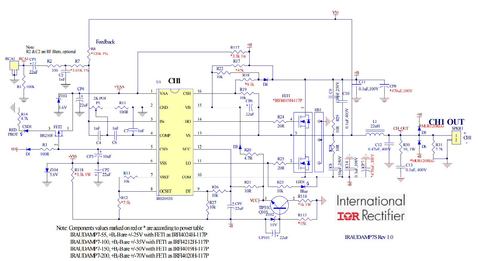

Hi Grib,
This is a sure electronic board. But it is carbon copy of IRAUDAMP7S-200 reference design of International Rectifier. I have attached here with some docs.

Apparently, this board implements the under voltage protection, so measure your left PSU voltage when the board shuts down to see if it doesn't drop bellow the minimum allowed.
If the voltage is correct, it's probably the OC limitation. You'll just have to read the IRS2092 application note, and try different couples for R18/R19 and R12/13 to increase the threshold.

I replaced R12/13 and R18/19. It seems like the amp work good now. Thanks for helping me to Fix the issue.

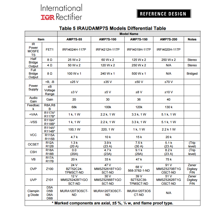

I need to run the my amp with 4ohms load. But the amp is not stable at higher volume level. Reason could be the over current protection. According to the data sheet, IRAUDAMP7S-200 is recommended only for 8ohms.
However the Model IRAUDAMP7S-150, this amp can be run at 4ohm load, But power MOSFET are difference in this model.
Do you thing it is a good idea to change the current sensing resistors (R12, R17, R18) of my amp (IRAUDAMP7S-200) as the IRAUDAMP7S-150 so that i can run my amp with 4ohm load? will it be create any harm to the component of the board?

As long as you keep a working OC protection, and that you keep it bellow the maximum that the MOSFET can handle, you should be ok (36A for IRFI4020, so don't exceed 30~32A).
The main side effet of running 4 Ohms speakers would be the change is high frequency response. You will most likely get a ~3dB boost or cut (I don't remember), at 20k, with a huge Q factor, so that would affect 14k (lightly) up to 20kHz (a lot). That would have to be confirmed by some else, I'm not sure.
