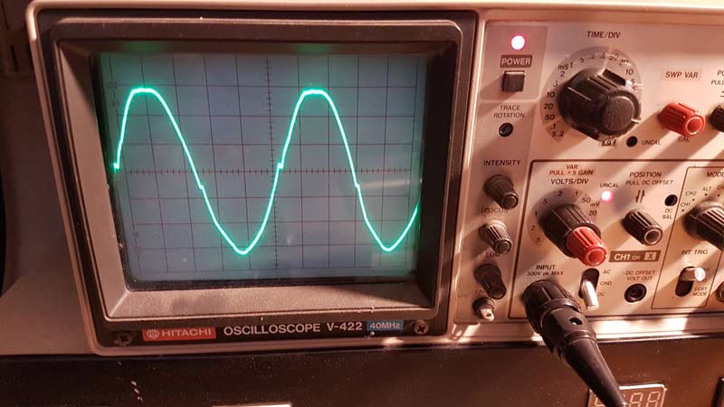

Residue
In my case I do not feel very confortable with the amount of carrier residue at the output. I'd like a bit less.

When you say if it's real what do you mean? The pict you see is the output of one of my LD20 modules, measured by me.
Very real, believe me.
All modules have the same leak. The designer of the board talked about it earlier on this thread, appears to be a choice. Other class D implementations (I have a few different class D amps.) do not have such a big leakage.

What you are seeing in the screen IS the leakage signal, a wave of around 400khz.
Oh I see.
We are talking about some volts of carrier here!
This of course is inacceptable. There must be something wrong with your output stage filter. Sure the coil and cap are intact?
But funny. If we were looking at the carrier here, the waveform would be a square wave. Your scope should be able to display this speed no problem.

The osciloscope is in 0.5v/division, so you can see around 3v p/p carrier residue.
And it is not a square wave because is taken after the inductor/capacitor output filter where the carrier is already filtered.
Are you sure your modules do not have this carrier at the output? According to someone early in this same thread, this leaked carrier is "normal' with this design. I think.
Ricren,
I investigated some more.
So your 3Vp-p align nicely with 1Vrms.
I can hear nothing detrimental on the tweeter. Sounds sweet and nice.
I have included a 100R/10nF (X-type) zobel down the very end too as Cordell recommends.

Yes, I was reading the same information, still I wonder about intermodulation effects of this carrier on the audible spectra.
Besides, I have other class D modules with a different design that not have this leak so I was wondering if this residue was ok.
Let's call it a day and move on, apparently this design is what it is. I'll use it for the woofer part of muy 3 way speakers for the time being.

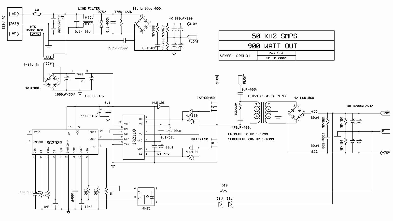

I have a question for you. D20 is a good amplifier. But there is more powerful version, D25 version, about 250watts in 8 ohms. I do not know if 250 watts are effective or peak. But a seller, told me that it can run from 50volt to 80 volts without loss of power. I do not think I'm wrong. You have already tried amplifier D20, what is your optimum voltage for working with D25? How much current does it need? There is good smps to work with 2 D25 amplifiers?
thanks for your advice
In your opinion, this smps 900watt + -70v is good for 2 boards?*

I believe you are the most suitable person to ask a question. I have amplifier D25. I want to work with +/- 70v and load 8ohm. How many watts must be power supply smps?
There is math formula, to know how many watts need to work D25.
Sorry for this stupid question, but I have problems with dimensioning power supply
whom do you mean? Does not matter.
However I have to say something about that.
I use 5 modules L15D (á 150W sinus).
Now those numbers are to be viewed with a gain of salt. While it may be true that such a module can output the rated power, no real life signal is sinusoidal.
Bear in mind that real music is hugely dynamic and that power demand rises with the logarithm. It is known that class-D amps have a very bad overload behaviour. Such a device clips harshly, very much unlike, say, a tube amp. Its useful musical range may therefore be much lower than its rated power would suggest if you want to maintain a safety margin. It is thus ludicrous to cater for its rated power.
To monitor all that, I made some LED display moduls with a µC that monitors peak and average power. To my very astonishment (I had read this before but only seeing is believing...) the average living room loudness dwells well below one watt. At pretty loud volume (not comfortable for longer...) the (pretty inefficient) midranges go to 1W occasionally, the mono subwoofer too.
The tweeters usually don´t even light the 20mW lamp.
So much for power consumption. With the fairly efficient speakers of today, it is beyond me who needs so much power for a home system.
So back to the calculation.
The SMPS I chose (connexelectronic SMPS500R), a 500W rated power supply, can output 750W short term. God forbid I ever come near that.
