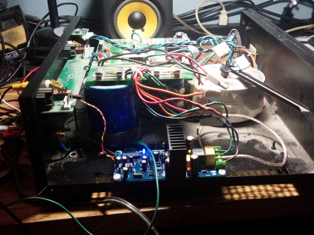

I bought a pair of the L25D (mono) a few months ago. The output inductors are running very hot, up to 80 deg Celsius. I afraid the whole amp will blow one day, so I open up the inductors, rewind with Litz wire, and now the inductors stay below 50 deg Celsius. Any comment on this ?
Thanks.
