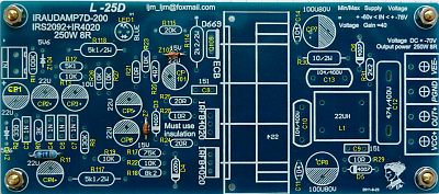

quality of the l25d board
the l25d board was a pleasure to listen to for me.. it has a slightly different sound from an old hifi transistor amp.. seems just slightly zippier. Its ability to power a 4 ohm load is questionable. The choke inductor for the output gets pretty hot, even when the board is not driving power. The heat sink seems a little under sized. Some other components may be under sized. Mine kept tripping way too early while running a 4 ohm load so I had to play with them, and that got complicated. They misbehave if they are sharing ground lines. The misbehavior can include tripping or even blowing transistors. My opinion is that the irfb4020 transistors don't really quite have what it takes to drive a 4 ohm load. Getting past that is hard, and I don't know ho much risk there is of the output choke saturating if the current goes high. .. the board accepts +-80 ... wouldn't go over +- 70

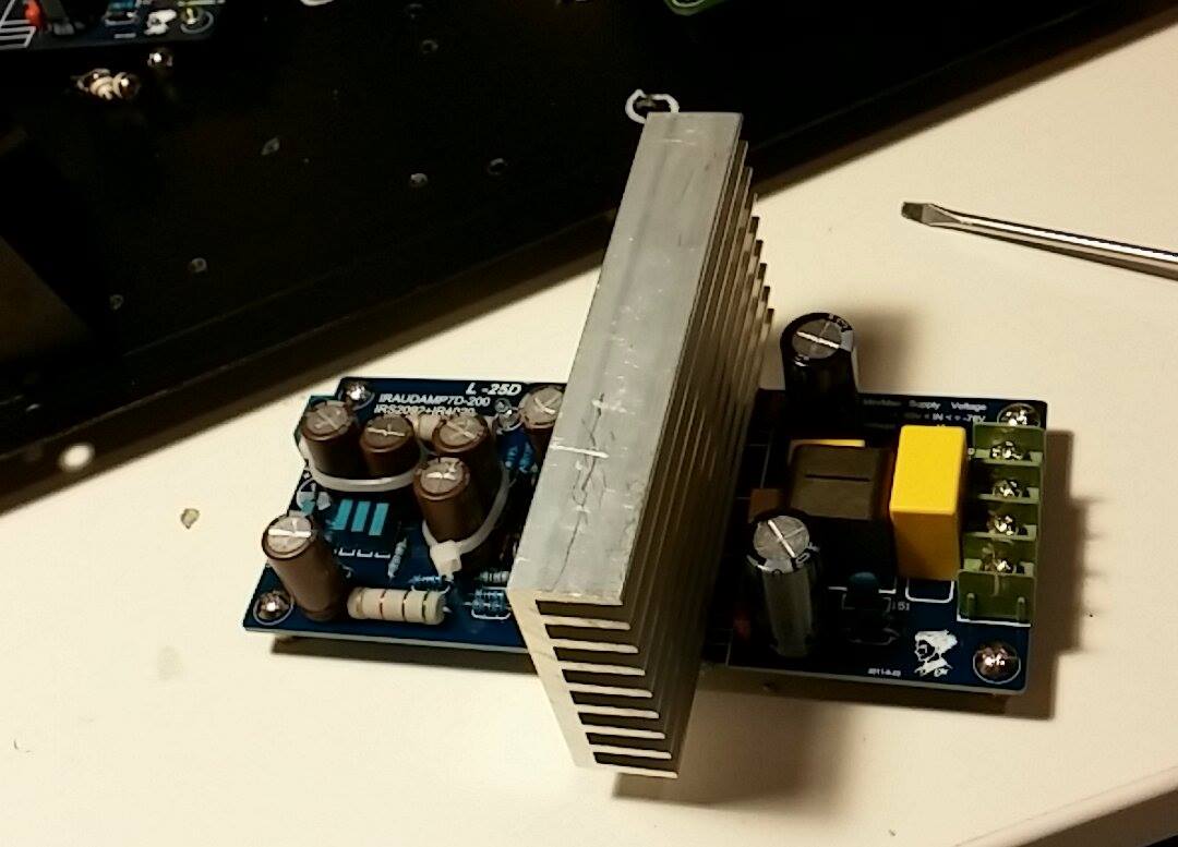

Here is my L25D
Upgraded heatsink
CP1 REMOVED and used Silver jumper cabel. Using Soniccap Gen 1 at the RCA input wire.
CP2 to 22uf/100v Elna Silmic II
CP4 to 22uf/100v Elna Silmic II
CP5 to 22uf/100v Elna Silmic II
CP6 to 22uf/100v Elna Silmic II
CP101 to 22uf/100v Elna Silmic II
CP3 to 10uf/50v Elna silmic II
CP7 to something between 300-1000 uf with 80-100v
CP8 to something between 300-1000 uf with 80-100v
C2 til 1n/400v Wima Mkp2
R114 to 2k2 3-5W
R117 to 5k1 3-5W
R118 to 5k1 3-5W

To much !
It makes sense to change the input capacitors to a higher grade Elna Simic II the rest is waste of money , My amps sounded better after some hours with the input caps changed , more relaxed , less bright . The bigger 820 uF caps did improve the bass .
Make sure you have your stereo amps carrier frequency 25 kHz apart or as close as possible ! That's a very audible mod in stereo mode !
My L15D's are my favorite amps , very open and analytic sound after the 2cent mods .

The input impedance of irs2092 is quite low. about 3.6k by memory.
With 22uF input cap, high-pass input filter is set at Fc= 2Hz
If you replace by 4u, it will set Fc=10Hz, ie impact low freq response.
I would not go lower than 10uF for the input caps of this amp. 10uF film capacitors tends to be big, which is not a good thing. They will act as antennas and capture the HF noise.
You can use non-polar electrolytic for best quality/size ratio.

100uf 50V ordinary brand caps will perform better than 22uf/100v elna silmic II on CP2, CP4, CP5, CP101.
