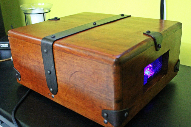

Post 612 is my amp , (almost) dead quiet , some noise with ear at the speaker , but no hum ! See the separation of input and speaker wires .

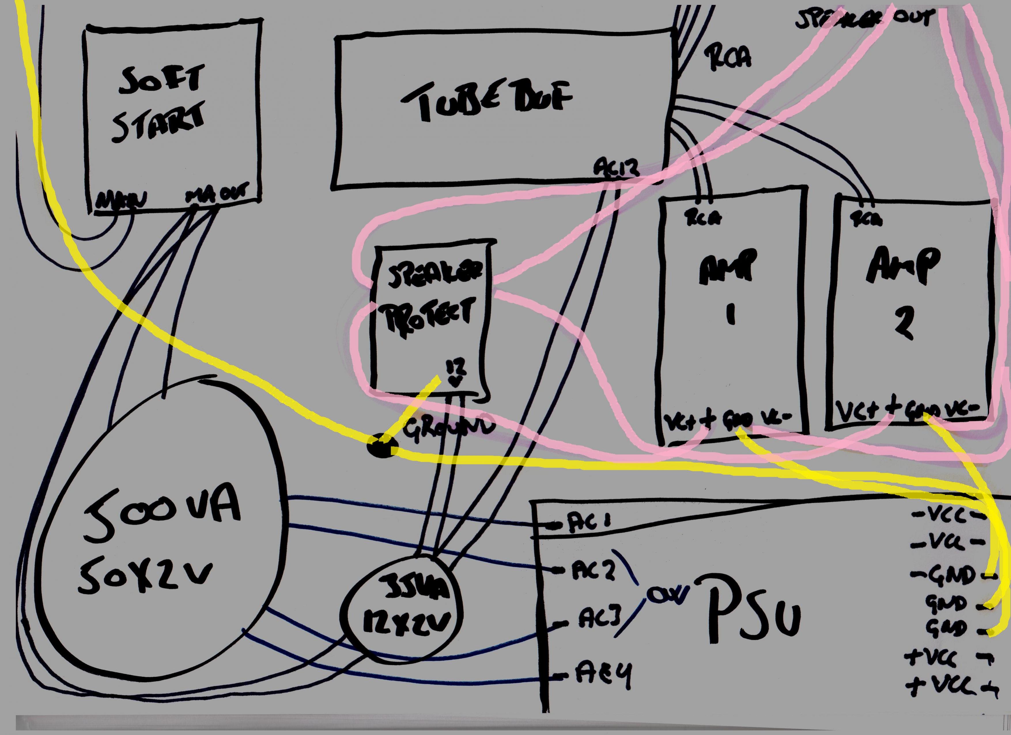

A bit busy today , come back on it tomorrow . You have two groundpoints . ALL grounds should go to one star point .
The fact that it's still humming with your RCA input directly coupled to the L20D's is a good sign , it's not in your tube buffer .
Isolate your star point from the chassis . Take one heavy wire from your PSU ground to the star point and connect all grounds to this point , Speaker ground , Amp ground etc . I'll make a drawing tomorrow or Saturday. Only connect the safety ground to the chassis .Try reversing the polarity of one of your 12V AC connections , either to the speaker protect or the Tube buffer

Here is a not so very good drawing of my wiring schematic
I Tried to connect the rca directly to the amp boards, didnt make any difference, still the same hum.
In the drawing the Yellow is the ground wires, and the purple are the speaker both positive and negativ.

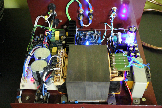

Steel bolt
Is your transformer getting warm ?
From the picture I can see that you use a steel bolt to attach it to the chassis .
Take the bolt out and see if the humming stops . If it does , use a brass bolt .
