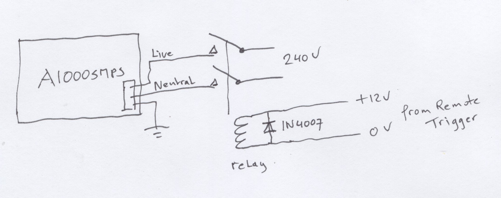

Has anybody added a 12v trigger to your amp(s)? If so, how did you do it? I've ordered a SMPS1000 and a pair of L25D mono's. I want it to power on like my rotel's do vs staying on all of the time.

I use 12V trigger from my Emotiva UMC-1 to power up my A1000SMPS with 5 L15D's . The 12 V from the trigger activates a simple 12V 5A dual pole relay in the Amp's mains supply . Works very well for more then a year now .
Don't forget a diode over the relay coil .

I'm a bit of a newbie when it comes to electronics, any chance you have a picture of the layout? I've lurked around here for a while and I'm sure once I get the actual electronics I'll understand it better, but for now I'm a bit confused (which is why my first AMP is coming as assembled components). I'm a software engineer by trade.

See attachment 🙂
