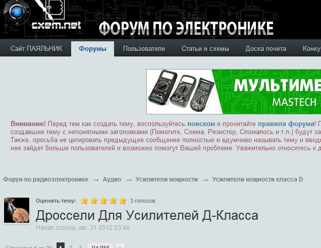

Good inductor Ei-33. F-400kHz
I google'd like crazy, but I couldn't find it... 🙁

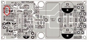

- Class D
- My design L20D IRS2092+IRFI4020H 200W8R
