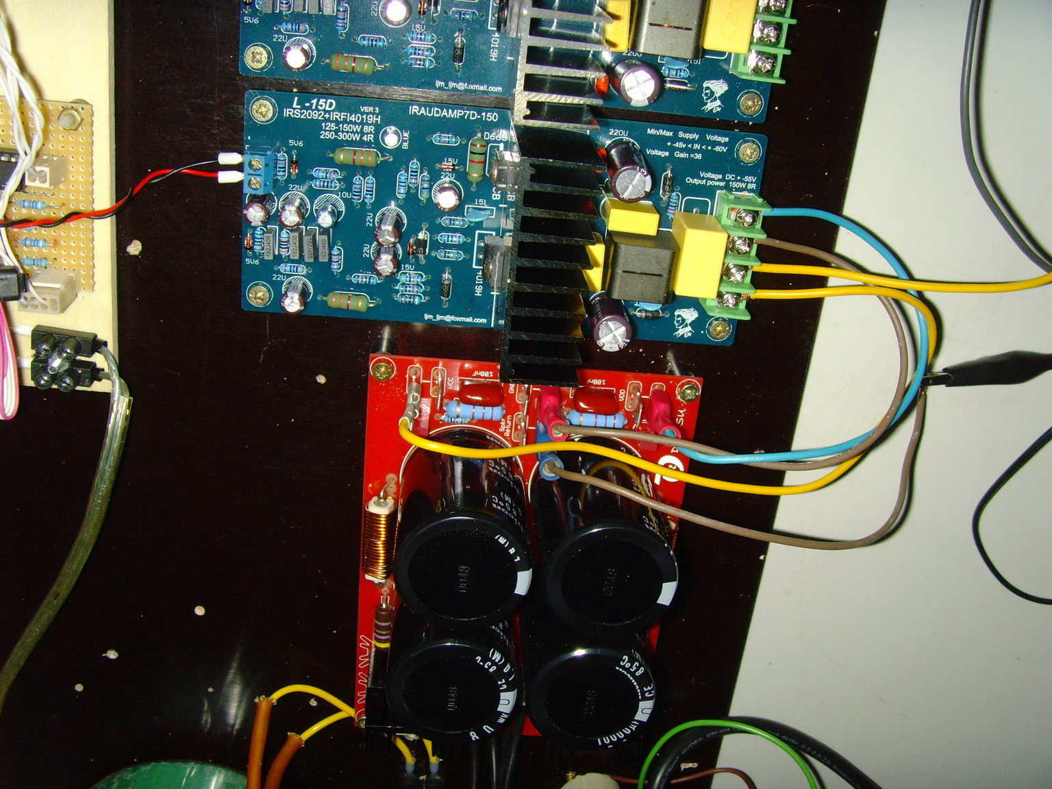

Gentlemen, please give me a hint how to operate the L15D.
I connected it as shown on the left image as follows:
From bottom to top: +46VDC, Speaker+, GND (GND Speaker), -46VDC.
The input is a 200mV sine wave and should result in a 7V amplitude output sine wave (gain of the L15D is 36).
But the only thing that I see on the speaker's output terminal, is the PWM signal.
What am I doing wrong?
Best regards - Rudi_Ratlos
P.S. Same behaviour on both channels.
Speaker is a 8 Ohm / 100VA resistor.

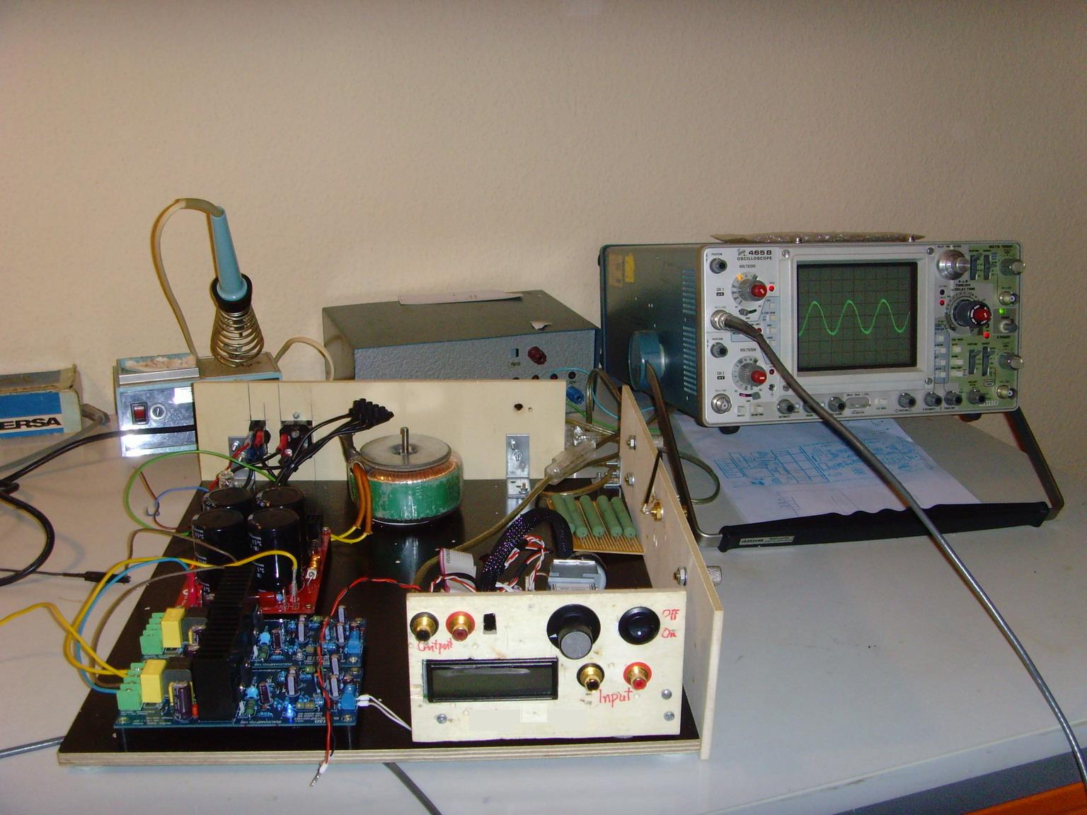

Indeed: this is my passive pre-amplifier, attenuating the input sine wave, not showing the connection
to my CDP on this picture.
Regards - Rudi_Ratlos

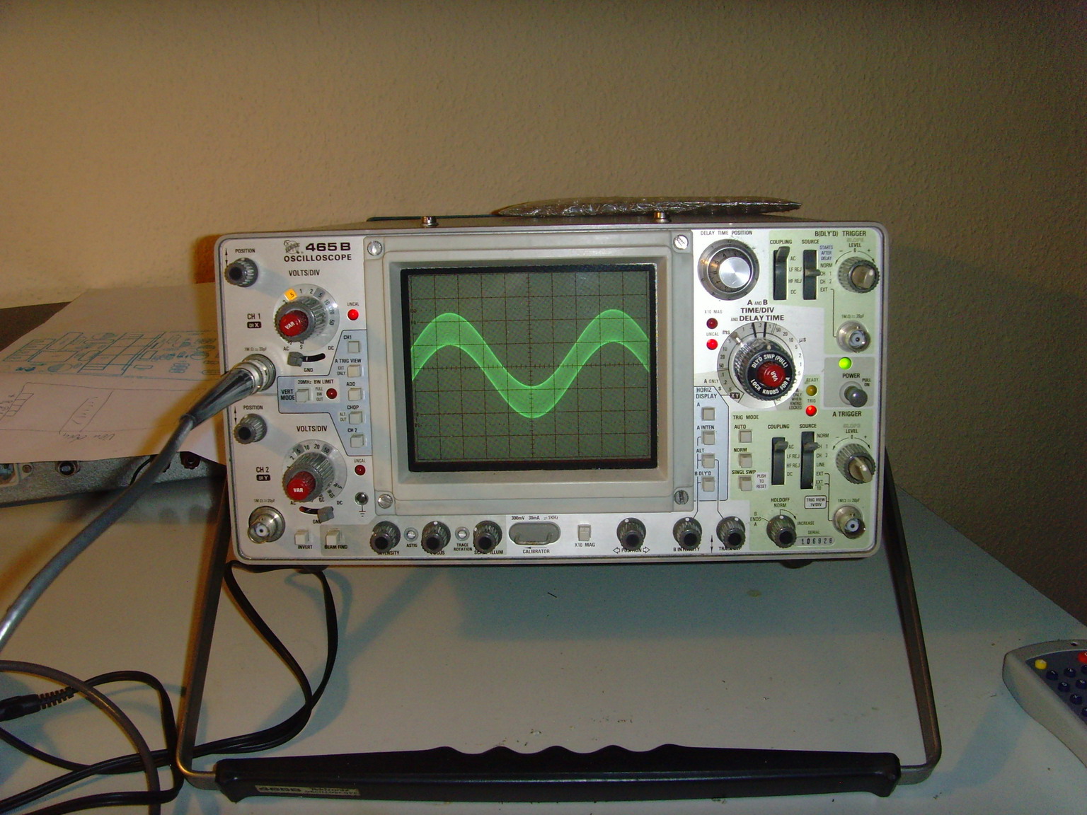

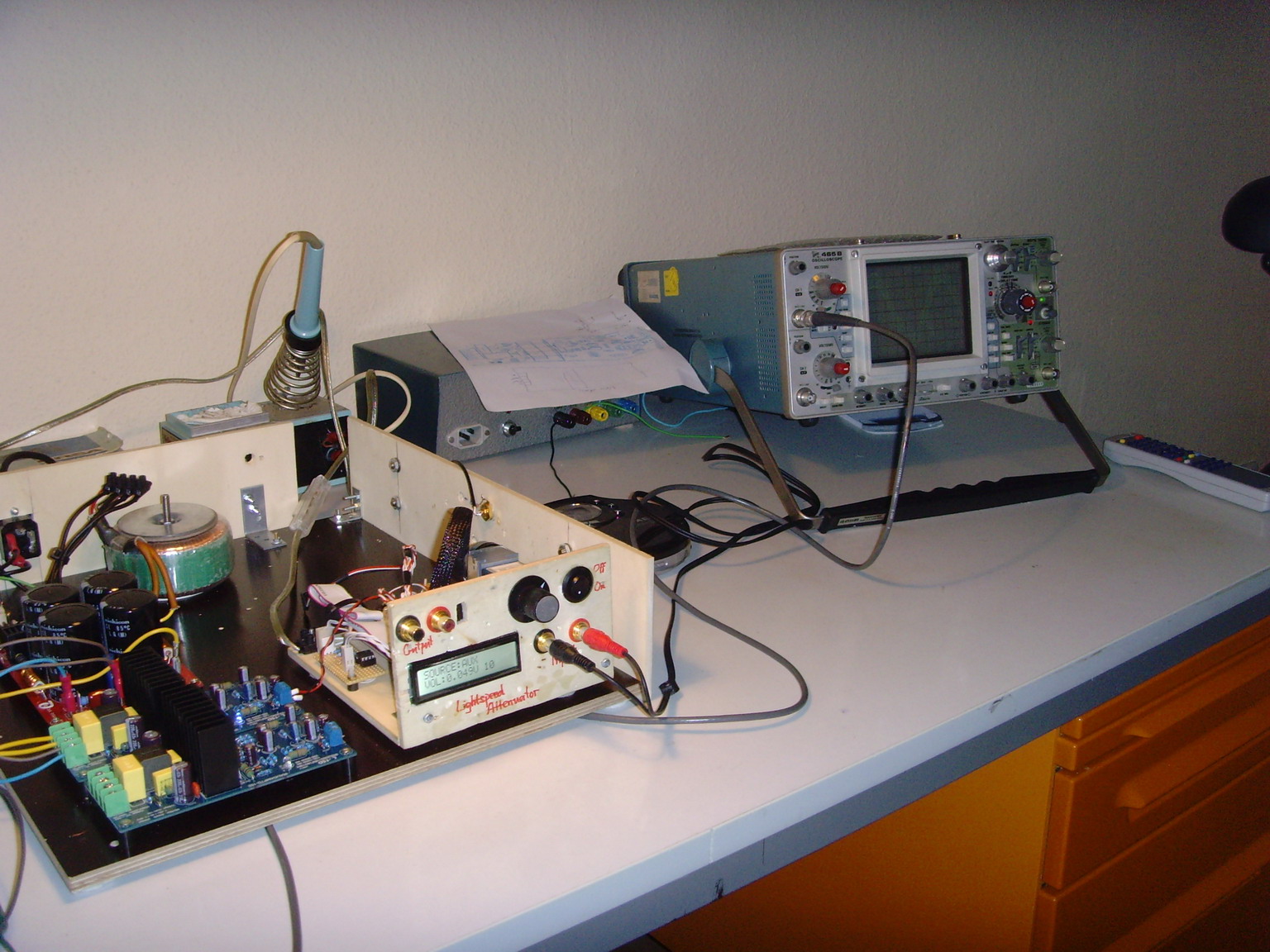

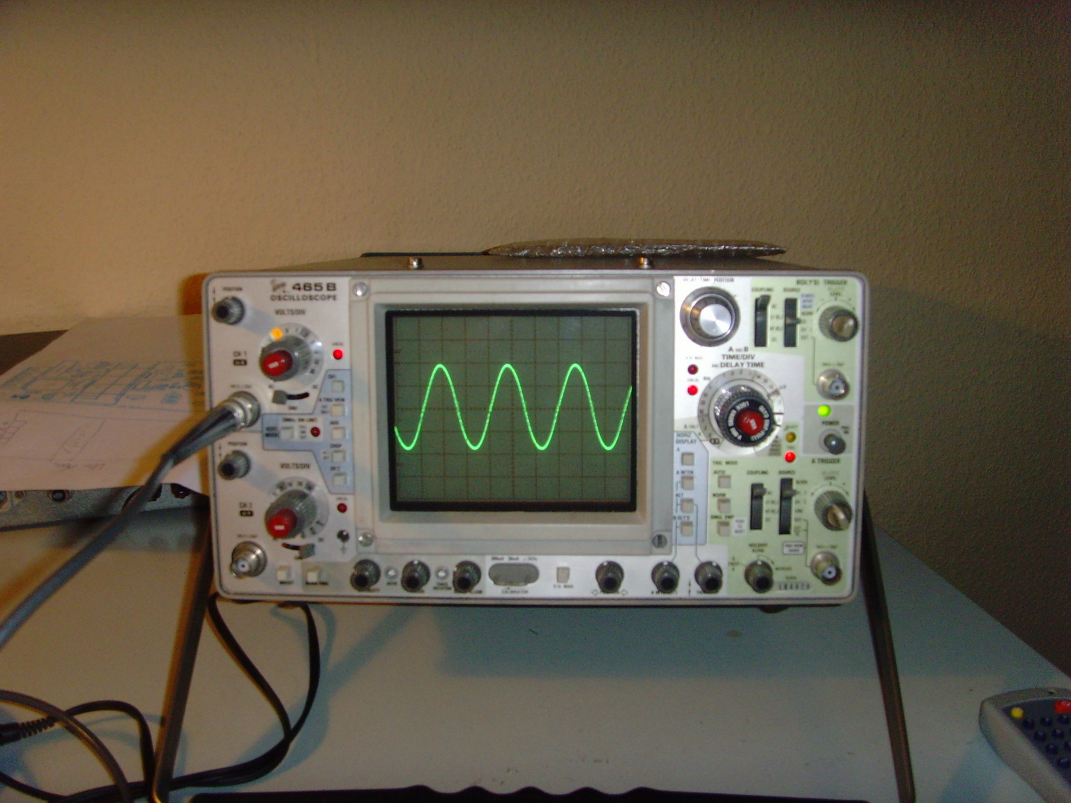

Rens,
the left image shows my current setup.
CDP connected to passive PreAMP - connected to L15D - connected to a big 8 Ohm resistor as speaker-substitute.
The 2nd picture shows the output with no input applied (Input + = Input -).
The amplitude is about 200mV, the frequency is about 70 KHz.
The 3rd picture shows the output with a 100mV / 1 KHz sine wave applied to the input. I call this "heavy oscillation", but I am not sure about class D.

Hi Rudi ,
I don't see any PWM signal on your scope .
To analyse if the problem is in your L15D , disconnect all sources from their power supply and the L15D and short the input of the L15D with a jumper .
Power up ONLY the L15D and measure with a battery powered multimeter on AC to see if you have any signal . It should be near zero Volts. Then try again with some sine wave from an external source and measure .
I see you have a 465 scope , do a differential measurements on channel A and B with 2 probes just using 2 two probe tips and adding the signals , so no earth connected to your L15D through the scope . The scope's GND to the L15D can be the source of the problem.
As you are in Germany you can probably rotate your scope's powerplug 180 degrees and so inverting the power supply . Give it a try .
As the signal is only a couple of hundred millivolts , you can also just check with a speaker , nothing else on the output , no scope . Begin with a shorted input , listen . All OK , than add signal ( from MP3 player or Iphone . etc . )
Then add the scope and see if it starts oscillating .
Cheers ,
Rens
Rens, thank you for your advices.
I rotated the scope's powerplug: no change of the scope's image measuring the output across the 8 Ohm resistor.
I shorted the input: Input + = Input - and measured DC (!) on the output: not measurable.
I read Rod Elliott's article: "Class D Audio Amplifiers - Theory and Design", especially his notes about "Output Filter Design"
and came to the conclusion that my pictures shown may be "true" (Typical Class-D LC 2nd Order Filter).
Then I disconnected the scope, connected a pair of cheap speakers, inserted my favourite CD, powered on and:
there is some beautiful sound coming out of the L15D, no noise or distortion to be heard at all.
Thank you once more for your support - Rudi_Ratlos

Good to hear it's working OK . I was confused by your 70 kHz claim . So the "oscillation" you claimed is just the residue of the carrier frequency around 470 kHz .
Hope you will enjoy this amps as much as I do !!
