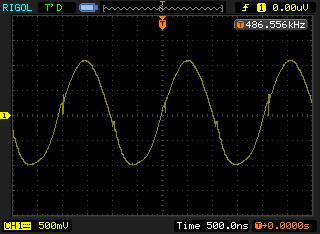

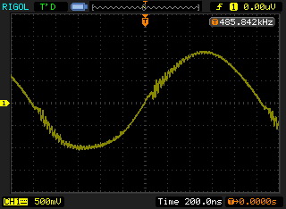

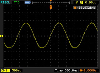

Therefor I tried to measure input/output with an oscilloscope, an learned that the L25D reverse the phase from input to output. Anyone else who has discovered this?
It's not a bug, but a feature of the IRS reference design. It was mentioned in an earlier post. I reversed the internal connections to my speaker posts for correct phasing.

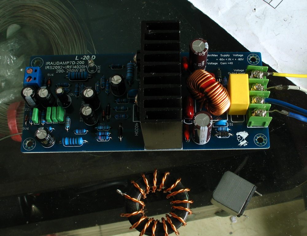

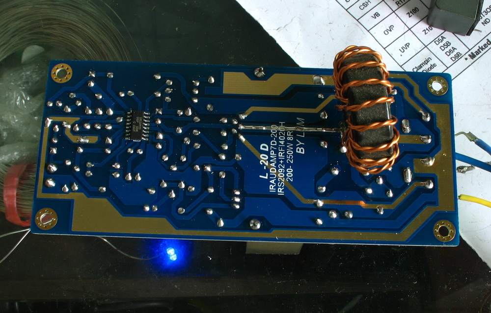

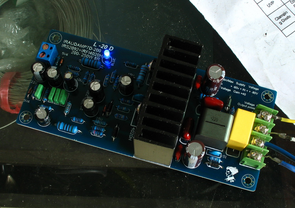

single 350VA would do fine for 2 boards, are you going to use your amps 24/7 at full power? are you kidding me?
Your inductor shouldn't get hot, I have a 750 watt amp that runs slightly warm all the time.
Which core did you use ?
I use a t106-2.
For inductance test I had done.
- 2 red ring inductor has the lowest heat, but it has the largest distortion.
Followed by iron silicon aluminum inductance, the best is 7 g17 series with minimal distortion, but it does have a fever. Especially in high power supply voltages.
Because it will filter out directly about the power supply voltage of the signal, the LPF in the absence of output continued to work in a larger current.
Although it can still be stable running, a lot of friends to use more than one year experience in different temperatures. But if increasing radiator, or join fan. It may be possible to raise more current allowance.
