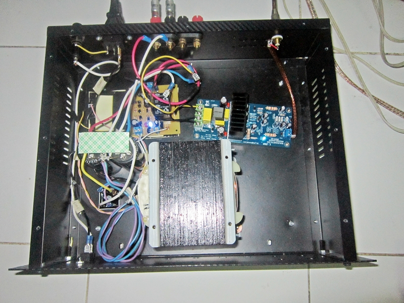

I am currently using this one as a subwoofer amp for my 4 ohms JBL GT5-12, because my IRS900 died after I accidentally shorted the output while there's an input signal. I connected it to the sub pre-out of my receiver, it has good and detailed bass but lean and not so powerful, also cone movement is kinda loose. Unlike my the previous IRS900 that makes my subwoofer sounded like an 18 incher, bass is much fuller and the cone movement is well controlled. ( both are using the same power supply ). There must be some cause why the L25d is not delivering full sounding bass.
I also noticed that the inductor is hot even when the amp is idle, I think it needs ram heatsink like the one attached.
Also when I tested it on full range, sound of the highs is a bit dry and sibilant compared to my other class ab amps, does anyone noticed this too?
I'll increase the self osc frequency to 450khz to check if the highs will improve.
The ram heatsink might alter your inductor's ferromagnetic properties .

Your inductor shouldn't get hot, I have a 750 watt amp that runs slightly warm all the time.
Which core did you use ?
I use a t106-2.
I use a t106-2.

I don't have an inductance meter right now so I can't check if it will change if I put a heatsink on top of it.
I use a t106-2.
It uses an inductor that looks like a Sagami 7G17A, but it has no label, that's why I am doubting if it is an original one.
I will also check if the inductor will run cooler if I raise the osc freq.
Its probably the wrong core material.
My first class d inductor was a power toroid and it got to 120 degrees c !

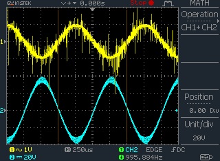

Therefor I tried to measure input/output with an oscilloscope, an learned that the L25D reverse the phase from input to output. Anyone else who has discovered this?
The "prove" is in the picture below, keep in mind that for test purposes I used a small transformer 2x30V/120VA. I normally use 2x45V/500VA for two amplifier connected to a Klipsch RF-82.
No problem to fix the bug, but I find it strange that I have not read about this before I discovered it myself.
