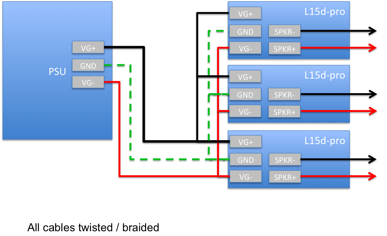

Hi Rens,
The schematics of the wiring.
I use a connexelectronics smps500r to feed them.
My grounding is floating as I have no grounding in my sockets.
Peter

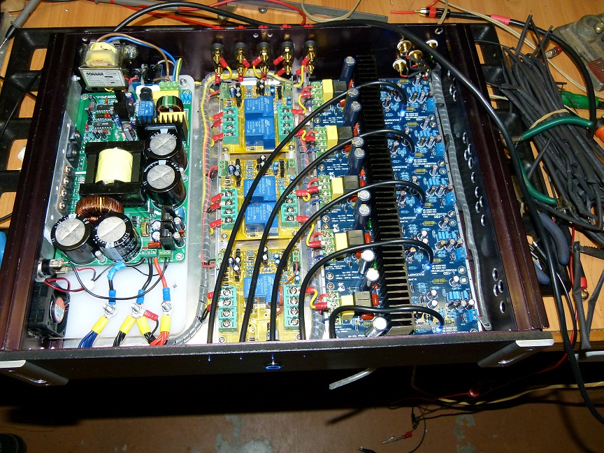

Try to connect each amp ground ( green ) seperately to the PSU GND and also the speaker minus directly to the PSU GND. I Use a M6 screw with crimp connectors as my star point as shown in the picture .
Hope this helps .
Cheers ,
Rens

Hi Rens,
Thank you for the input.
What about this solution to keep minimal wiring.
Hi Peter Henk ,
You can give it a try , but I dont like the shared supply wires either , I would go for seperate for each amp . I build a lot of amps and had a lot of ground loop problems in the beginning ( many years ago ) so started building with seperated supply and ground wiring in multy amp systems a couple of years ago and never had any problems since .
The speaker wiring might work as you drawn it , if not ground your speakers at the star ground . I asume the DC protection switches the High side of the signal .
I must also advise you to use high quality interconnects between class D amps and your sources . I had some very strange noises from my speakers when I just started with class D amps and used those cheap thin RCA Red/White cables that come in your CD player packaging .was all gone when I bought some dencent Interconnects .
If you still hear "His" or whatever with no signal , short the inputs at the boards and see if the problem is gone .
Good luck ,
Cheers ,
Rens
