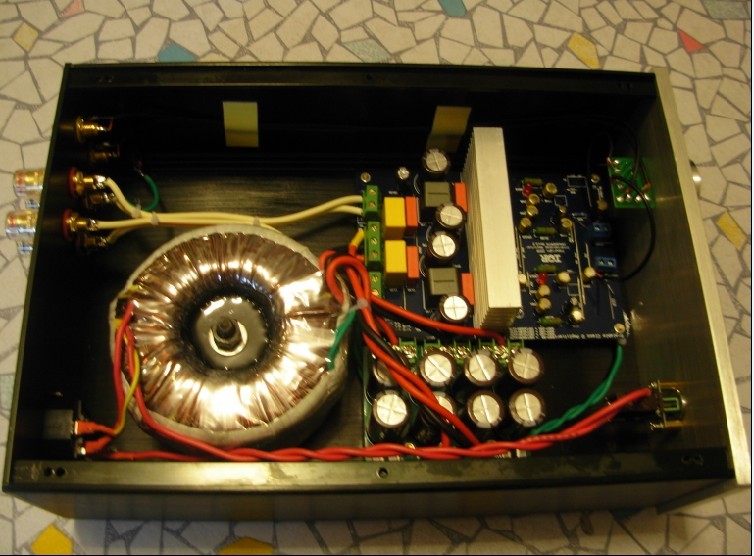

Okey.. another problem has occurd. I tried for the first time to connect it to my onkyo reciver from its preouts, and i there came LOTS of noise! I have on my test bench only used it with my ipad directly connected and then its no noise. WTF????
So the problems are as follow:
- Low transformer hum when no inputs are connected, but totally silent when RCA>jack>Ipad is connected. Works great.
- When onkyo reciver is connected Lots of static and noise.
Gonna try to bypass the tube buffrer when connecting to the onkyo..

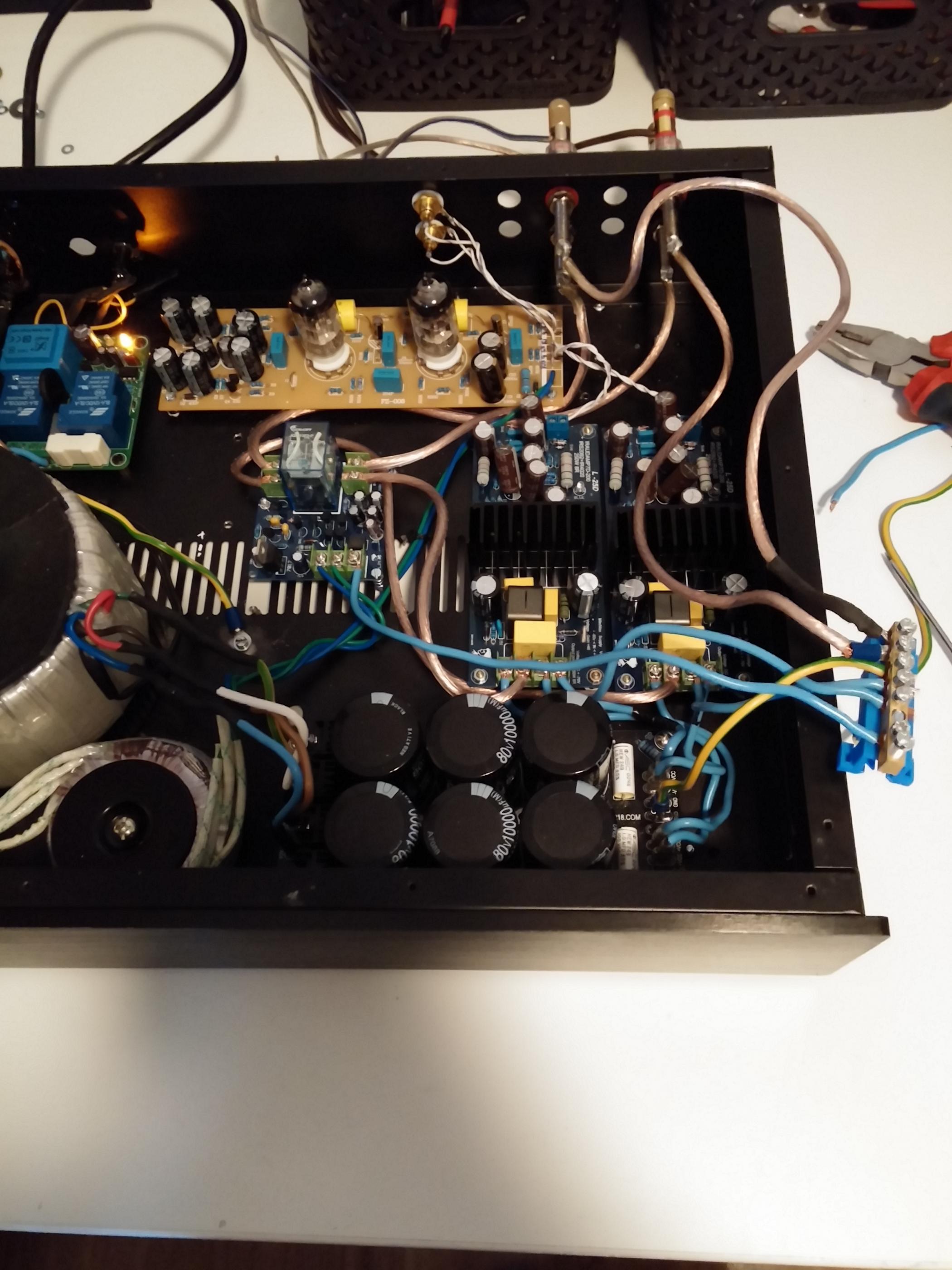

Im gonna try to use som shielded cables and twist the **** out of everything in this amp, and then we will see.
I tried connecting my amp directly to my dac and when connected it was dead silent, and sounded great. But then i tried again connecting it to my onkyo and got loads of hum and nosie when connected.
And i use some insanely expensiv Van den hul MC silver it65 signal cables, but im gonna try with some Tara labs cables, might do some magic.

hahaha Diy is funny. Its All Try and Fail.
I removed The Groudning for the Mains cabel, and poof the static that i got when it was connected to the onkyo is gone!
Can it be since the onkyo isnt mains grounded it cant use a mains grounded power amp? Ground loop?

Very dangerous lifting the ground of your chassis !
Did you try isolating your star ground from the chassis as I suggested ?
If that works you could reconnect the mains ground yo the chassis and be safe again .
Cheers ,
Rens
I know its dangerous to remove the safety ground thats what i want to avoid!.
Do you mean to ground everything together but not tocuhing the chassis? Can you draw it up for me? this damn grounding is Complicated! ive read so much about grounding these last few days!
I was also thinking about making a ground loop breaker? then i also can keep my safety ground.

So i tried a Floating ground, where all the components where grounded together without connection to chassis or mains ground. And safety ground connected to chassis. And i got a very high hiss noise and a high pitches klicking sound. So i guess this dosent work. See picture how i floted the ground.
Im starting to belive a ground loop breaker might be my only option?

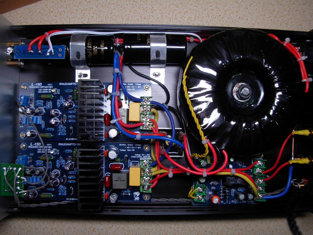

Hope I didn't make a mistake. I ordered a couple assembled L15d-Pro boards from China. Did so before learning of the two recommended sellers & unfortunately bought from someone else. Is there anything I should check regarding the components to make sure it's up to spec of the legit boards?
I will be using a SMPS500R to power the boards rated at 45V+-. Is this sufficient or should I bump up the voltage closer to 50V?

Hi Meerp1 - I think you'll be okay. Do a good visual inspection of the boards to check for any questionable parts and solder joints. Also look to see if the little LJM bust icon is printed on the PCB. It usually is though that does not necessarily guarantee authenticity. And then of course hook em up and test away!Hope I didn't make a mistake. I ordered a couple assembled L15d-Pro boards from China. Did so before learning of the two recommended sellers & unfortunately bought from someone else. Is there anything I should check regarding the components to make sure it's up to spec of the legit boards?

I have 6 of the L25D modules and only had 1 fail. So I can't complain too much @ $29/each. Seems like a steal to me. 🙂
I would think 45VDC+- should be sufficient - depending upon how much you like to push your speakers. 😉 On 8 ohm loads, this amp does sound very, very good.

Stay away from the tube. Over longer distances.
Maybe you can give it a try. Only use the mono. L25D.
It can let you know the cause of the noise.
If the mono. You can think another way. For example.
Mono amplifiers. It can eliminate the power ground noise.
