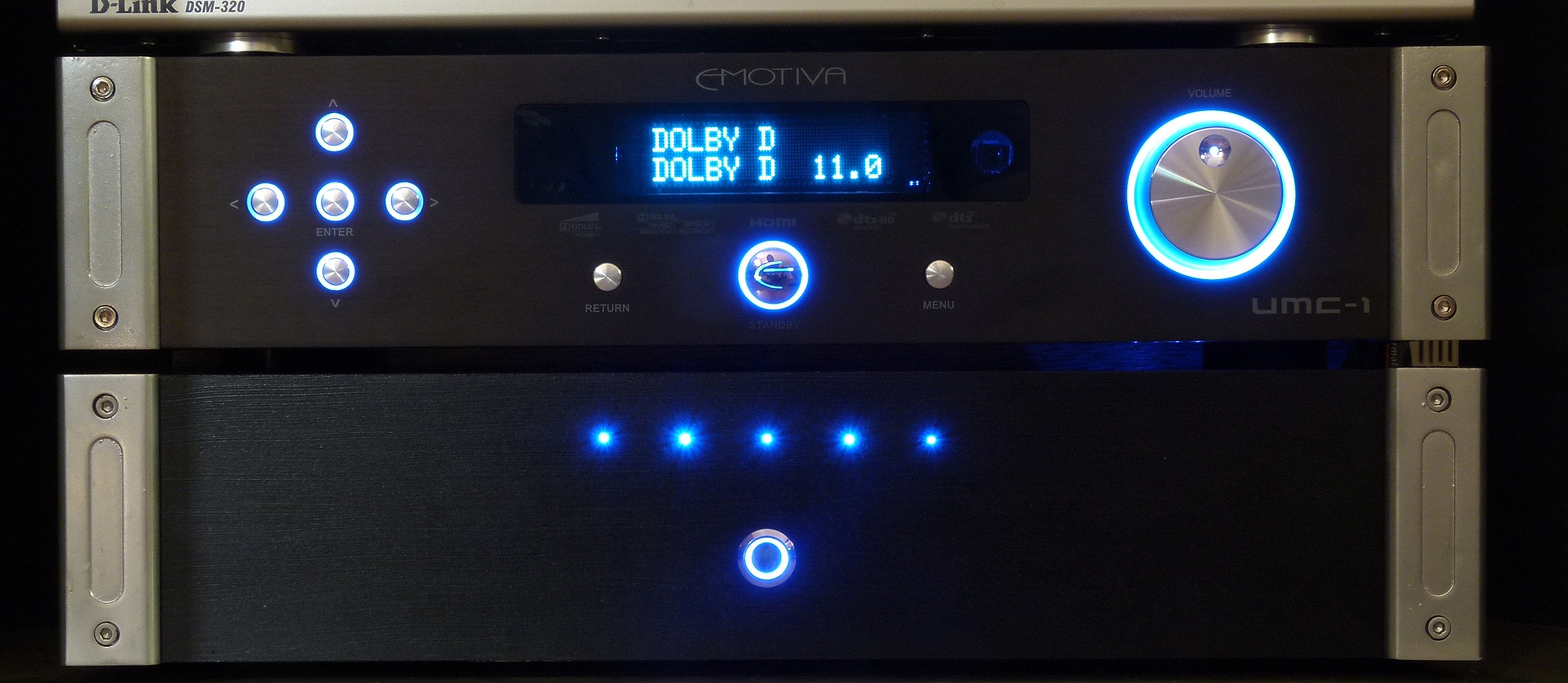

I can't believe there is nothing more to discuss about this beauty

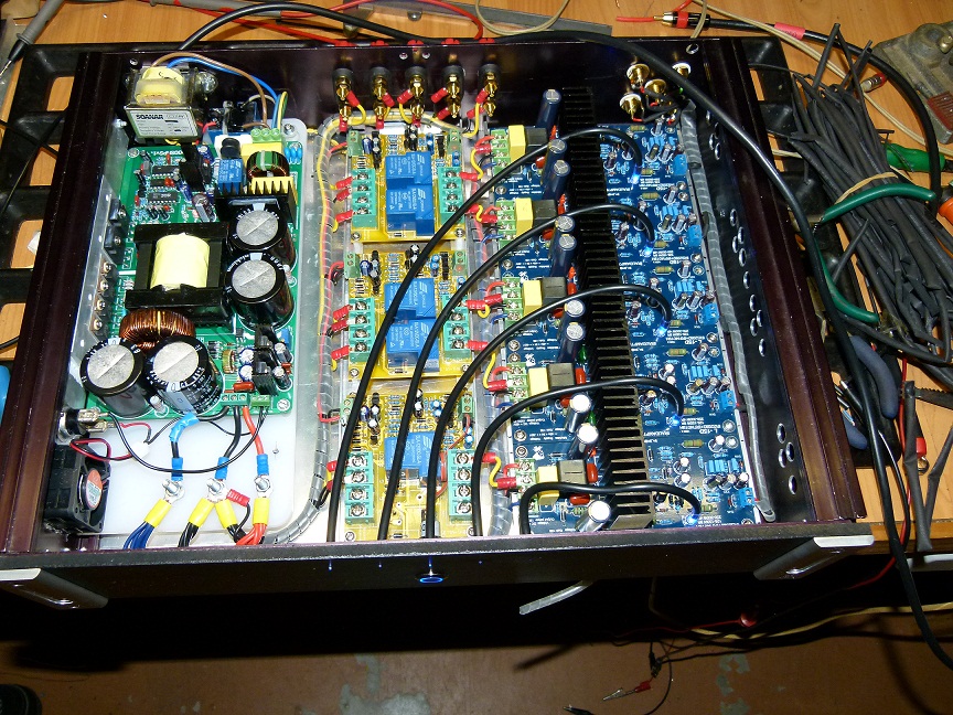

So I post a picture of my HT amp 5 L15D's fed by a SMPS1000 from Christi .
I changed the input capacitors with Elna Simic II and the decouplers with Panasonics 820uF low ESR's from RS .
I was a bit dissappointed by the damping factor I measured , only 30 after the 30 amp relays in the DC protection . So I'm upgrading to a FET relay now , still figuring out what FET's to use for the lowest Rdson and reasonable gate capacity .I used 18 AWG wiring for the output , but the longest is only half a feet , so that could't be the reason
As far as the sound , This sounds very good ! on my 3839 Tannoys
There is some noise , but hey , does one stick their ears in a speaker before listening to Nora Jones .
All I can say , from a well experienced listener , this is a good amp !
Attachement doen't work right now , so I post it later ,
Cheers
Did you listen to the amps before the changes?
Why do you think the low damping factor is caused by relay contacts and not the amp module itself?
Nice job on the amp construction.
What kind of case it that?
We did listen to the amp , I have one spare amp and that’s original .
We did some blind AB testing between the original and the modified and we ( The wife and son included ) all found the modified sounding a tat better . A little tighter bass and more transparent .
It was a mono test , so I expect it to be even better in stereo or 5 channel .
I checked the damping factor of the remaining four channels this morning and they were between 80 and 87 . After measuring the relay contact resistance of the low damping channel it was almost 0.120 ohms . I changed it and that solved the problem .
The other relays measured between 28 and 35 milliohms
So in the worst case my Amp internal resistance including the relay and wiring is 8/80=0.1 ohm
If I change the relay with 2 mosfets with an Rdson of 3.5 mOhms in series , my new damping factor will be something like 8/(0.1-0.035+0.007) makes 111 and I’m happy with anything above 100
I made the case myself from two Heat sink profiles I had laying around for the sides , I used 3mm aluminium sheet from the local hardware store for the front , back , bottom and top sprayed it black with a can of spray-paint and used 6mm MDF for the front on top of the 3mm aluminium, again sprayed black and covered with two layers of “Royal coat” decoupage finish satin , that gives an almost perfect ” Brushed” aluminium finish to match my Emotiva UMC-1
I cut a toslink cable in 5 and connected them with some 3 mm PVC tubing to the status LED’s on the amps and the other ends of the 1 mm fibres stick in the MDF front . Looks real good !
I used a plastic kitchen cutting board to mount the SMPS on the bottom of the case to safely isolate the high voltages .

I used 3 WLX-7 speaker protection boards from zoe_tsang .
They work pretty good . ( The only mod I made was a 24V zener in series with the flyback diode to improve the off time ) The circuit uses Songle SLA relays . I think I messed up the relay , because I did some pretty abusive testing on this particular one . I simulated 50 Volt rail voltage in an 8 ohm dummy load a couple of times on the input of the circuit and my Lab supply is current limited at 5 Amps . I wanted to be sure it operates as it should , because the Tannoy recones are ridiculous expensive ( and I had quite a few over the years 🙁 once due to DC on output with my Dynaco Stereo 400 the rest due to much partying 😀 )
I tested all other relais , but only once , so they probably survived .
I don't have an unused one , so don't know the original contact resistance .

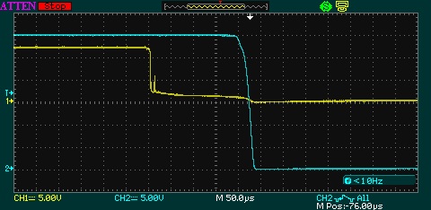

I received some PVI1050 couplers today and did some interesting measurements on the speaker relay on this link A DC Fault Protection Circuit for Audio Amplifiers . I put 30 volts over the Fets (IRVP44Z just for testing) in to 8 ohm dummy load . The switch times are very good 50usec offtime (Leds in series 30 ma,Fotocells in series ).The coupler is a bit slower , 200useconds .This Fets have only 3000 pF input capacitance and the ones I ordered (IRFB3077PBF) almost 10nF, so I put 20 nF parallel to the PVI1050 output . The switch time went up , about 100useconds but the big surprise for me was that the fet keeps switching off in 50 usec ! So very safe within SOA .
When I have my bigger Fet's I'll make some drop in PCB's for the WLX-7 boards and keep you posted . Before I switch the mechanical relays to the Mosfets I will document some measurements on the old one and compare them to the new ones .

Yellow is Leds Blue is dummyload
Typical americans, we do everything big. If some is good, alot is even better, then massive would be a awesome.... I spent very little money on it, I did all the work my self. Some people on the theatre forums spend more on their speakers and amplifiers than I did on my whole house. I saw a guy on there with 15 amps at something like $40K USD each. Just stupid. This is why i love the diy and LJM modules. I can spend $500 or so and have an awesome amplifier that could sound just as good as commercial amps.
I would have never believed that the mechancial relays were that fast opening the circuit. With the addtional fet protection, the speaker protection circuit would almost totally invisible, meaning the protection wuold kick in prior to hearing any such problems prior. It is a shame the LJM modules remove all of the AMP7 protection features. External is more robust than using the power mosfets anyway. Good testing information
