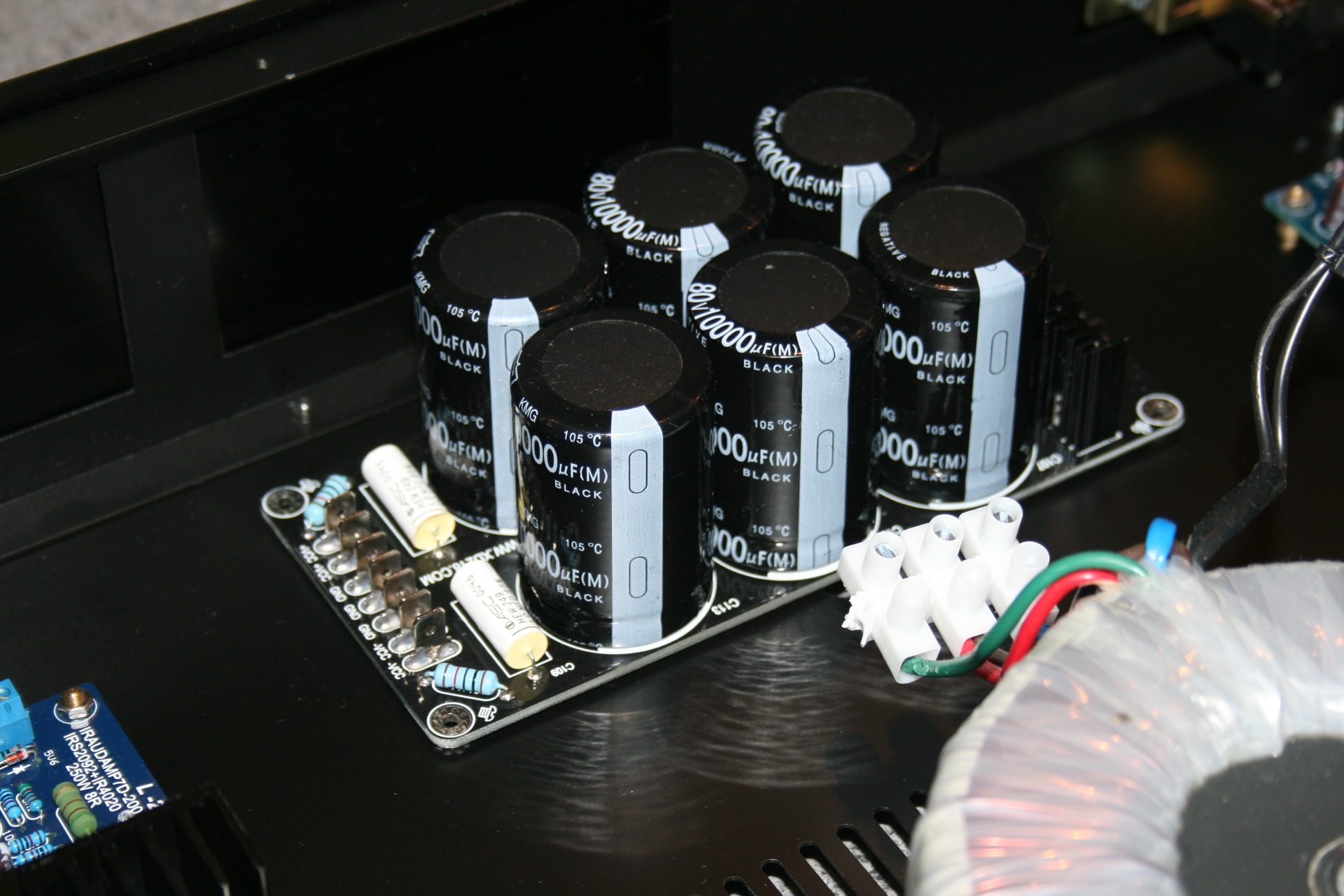

I've got 65,600uF total (32,800uF for each L25D). Hopefully that's sufficient.
about 10 times too much with smps, and still too much even if you use 50-60hz transformer... but it never hurts to have it like that 😛I've got 65,600uF total (32,800uF for each L25D). Hopefully that's sufficient.
I'm using a linear PS... I know that too much capacitanceis a no-no in SMPS, but in a linear supply would this amount have a negative effect or is it just a matter of diminished returns beyond a certain pt.?
The inrush current of too much capacitance can damage the rectifier diodes, but I doubt that will be a problem in your case.

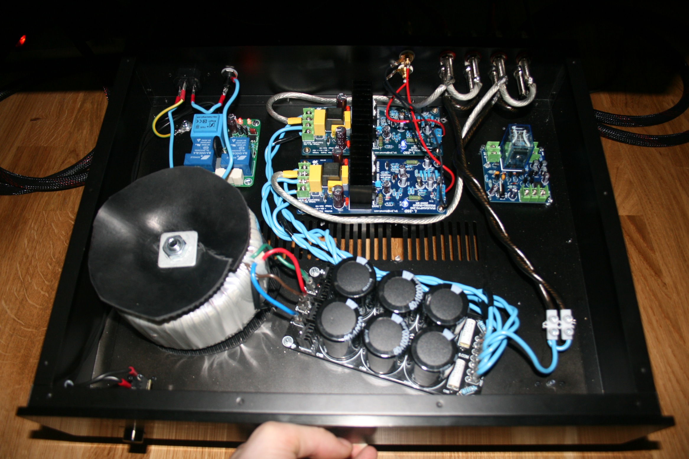

So i just finished my l25D amp. with a 650watt 2x50vac and 60 000uF psu thats feeding the boards with 70vdc.
When i crank up the sound to very high volums one of the bords just shuts of and the otherone continiue. Then i have to turn the volum a little down and it comes back!
Any ideas why?
Any ideas why?
the amp reaches hard clipping and protection mode is activated!
