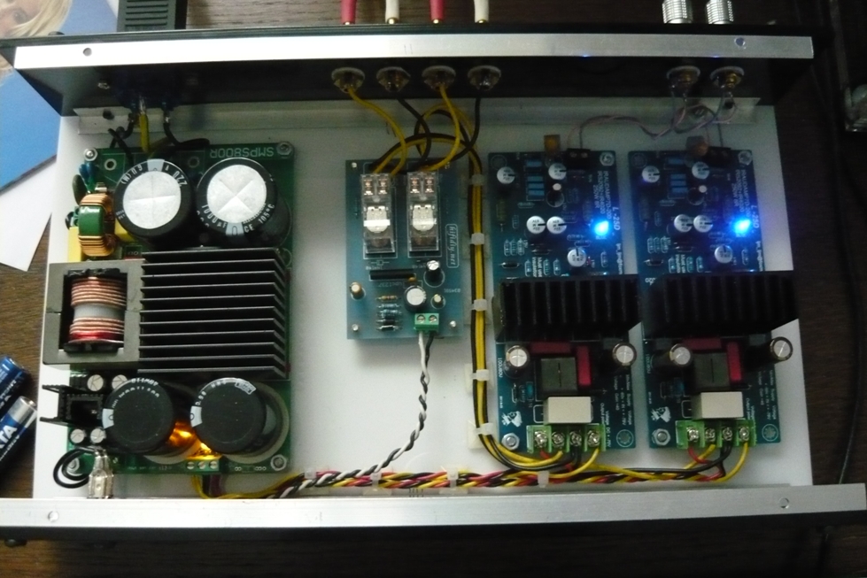

My design L20D IRS2092+IRFI4020H 200W8R
Since I will be using a power supply of approx +/-72vdc to +/-75vdc, I will be replacing the 2W resistors with 5W ones; additionally, the stock heat sink will be replaced with 76 x 50 x 22.2mm one, with a 5mm thick baseplate. I expect the devices to run noticeably cooler than stock. My speakers are 4 ohms.
The amps will look like this:

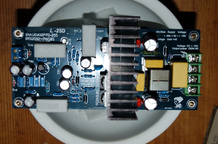

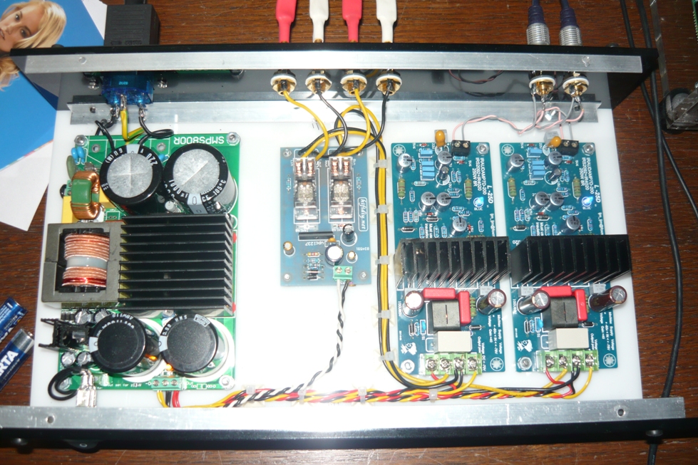

Good thinking! On the first picture you can see temperature ratings of mine L25D runing on +/-72V, stock resistors, speakers are 8ohm. I will replace these resistors with 5W vertical ones.

I started thinking about those sand cast resistors and remembered they are not non-inductive and so they probably aren't the best choice for this circuit.
I will be using Mills MRA5 5W non-inductive resistors instead, with the same larger heatsink as above.
Here is the board with Mills resistors:

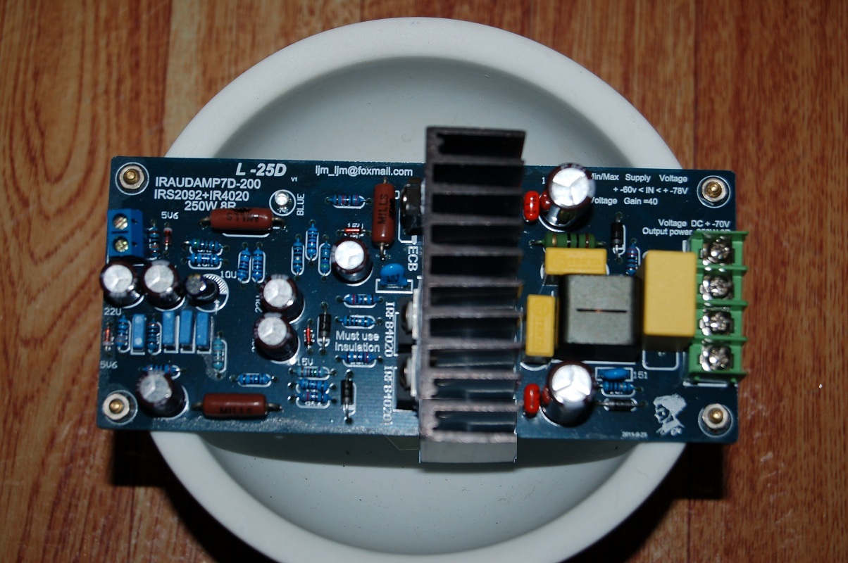

they can be inductive, they don't conduct any high currents, they just drop DC voltage at low currents

L25D runs much hotter than L20D?
Just finished building my first L25D with Connex 500w smps +-72V. It runs much hotter than my L20D amp with the same smps. Mains power consumption at no signal idle is 24w (both channels) compared with 14w for L20D.
Is this due to the extra power mosfet employed or is something amiss with my L25D? Ebay listing for L25D indicates power consumption at 7wpc idle. Can anyone check?
Remember that these amps peak efficiency is @ full rated power. Efficiency drops off as power output goes down and below roughly 20w drops off rapidly. An L25D running at the same power output as an L20D would be less efficient and have to dissipate more heat.
