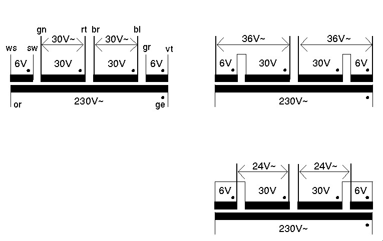

Hi Jim, I have also a powersupply question. I want to use 1 of my 2 highend toroidals (450 VA) for my L25D boards I recently bought. These are dual supply 36-0-36 and 6-0-6 output. When I add in series I achieve 42-0-42 and total DC about 59-0-59 Volts ... Would this work with the L25D ?
are you sure the 36V and 6V outputs have the same current rating ? (same wires) typically, on such transformer, the power rating of each secondary is different.Hi Jim, I have also a powersupply question. I want to use 1 of my 2 highend toroidals (450 VA) for my L25D boards I recently bought. These are dual supply 36-0-36 and 6-0-6 output. When I add in series I achieve 42-0-42 and total DC about 59-0-59 Volts ... Would this work with the L25D ?
6V output is typically for lower current needs, usually built with a thiner wire than the high power 36V output.
If wires don't have the same gauge on each secondary, if you put them in series, available power will be limited by the weakest.
In addition, the secondaries are probably center-tapped, 36-0-36 & 6-0-6, as you have described. Therefore, you can't put them in series and have access to the "center". You would get 48-0-36 or any other variant of 36-0-36-6-0-6. If the secondaries are isolated, then you could put them in series as you have suggested. However, alkasar's comment about the current rating is the overriding limitation.are you sure the 36V and 6V outputs have the same current rating ? (same wires) typically, on such transformer, the power rating of each secondary is different.

Here is an pic attachement with 30 V main voltage shown as example instead 36 in my case. The 6 V wires are definetly mentioned to inrease or reduce the 30 V. This toroidal is sold only for highend pursposes. 8 wires out. All same thickness.
