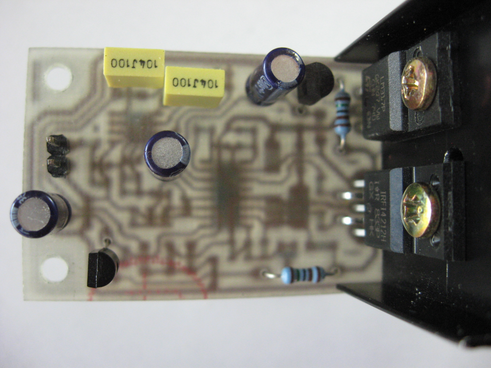

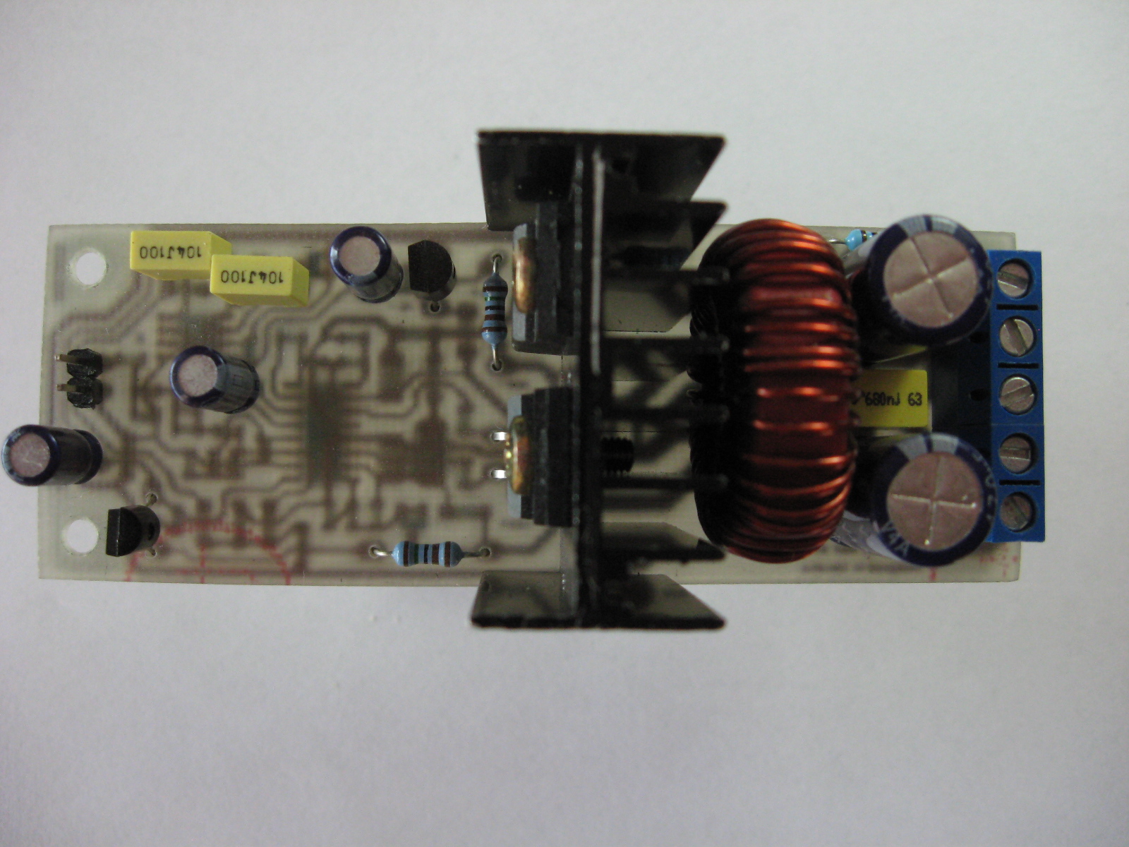

Hi luizcpimenta,My class D Amplifier...
can you give more informations, i.e. in what your design is different from LJM's, how it works, sounds etc? Just a layout with no infos isn't of much information.
Hi luizcpimenta,
It is exactly like the circuit LJM, except the bias, which put off the board.

My concern is, how can we tell we're buying the genuine article and not some knock-off. What are the clear and distinguishable markings that separate the true original (authorized by ljm and his 2 distributors), or a fake?
I guess the question should be if the so called genuine are indeed genuine. It's very common in this part of the world to do a design initially with reasonable quality components for advertising purpose, then cut the price as much as possible no matter what parts are used. Sometimes entrepreneurs without too much experience are submitting designs to factories to assembly large lots and they have the freedom of choice for the components and unless careful supervision from the one who ordered them, fake parts are very likely to be used.
There are several pictures in this thread where can see details of components which are used. some of these posts are: 320, 402, 412, 469, 471. can see very clear that the inductor has no marking at all, and on one of the pictures can barely see the marking of the transistor, similar with the one which I mentioned in the other thread. A cheap inductor will have less saturation current (possible damage at high power, low impedance or shorted output) higher core losses (higher temperature) and will be less linear (higher THD level) of course we can't hear the difference because the human ear can't tell the difference between 0.1% and 2-3% THD, because it's higher TDH threshold and also speakers are usually having much higher THD than amplifiers, so is easy to pick up any THD values and declare them knowing that very few can measure them, and those who have equipment to do so, will not buy these boards.
Regarding the layout, is a poor layout even for a class AB amplifier, and terrible for a class D amplifier. there are no close placed decoupling capacitors near the D-S of the power transistors, no GND copper pour and the only reason why the transistors are not flying away is that they use larger DT setting, leading to slower transitions but higher THD. and probably the biggest flaw is the lack of protections anything but what's included in the chip. with 100-220uF caps on each rail, if someone would be tempted to use a minimal capacitance on the power supply, these modules will be damaged instantly once the volume is cranked up.
I am surprised why peoples are so amazed by so called "very low price" while fail to understand that for this price they get less that minimum necessary for a reliable amplifier, and for the similar price others offer more.

The boards from the pictures I've posted were purchased by a customer of mine from the same "authorized" source. In fact he bought several modules, he's building multi-channel amps for public announcement and he had to try them. They failed the tests, 3 of them being damaged in less than 5 minutes. later on he bought few boards from my site and after successfully testing them, now I'm making a custom version for his multi-channel application. I asked him to send me two of these boards, I've been curious why they failed. If you notice, reading some older posts in this thread, I also had a good opinion about them till I got them in my hand.
I'll make some time next week and make some THD tests for the boards after (if I can) repair them and post the results. since I don't have an AP unit yet, only a Kenwood VA2230, accurate enough but no PC interface to save the graphs, it will take some time, and not sure is worth the effort while dealing with rigid attitudes.
Next I expect to be accused that I try to advertise my own boards, but before writing this, ask yourself's why I haven't opened a single thread at class D section trying to promote something. Even at Connexelectronic section (which I pay for) is quite silence and I'm also not inpatient to make more waves. Eventually everyone can do what he wants with his money and spend them more or less wisely. But keep in mind that while consciously purchase low-quality or substandard parts boards, you do nothing than to escalate the phenomenon.
