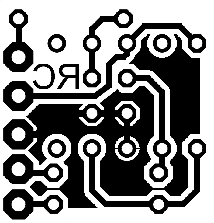

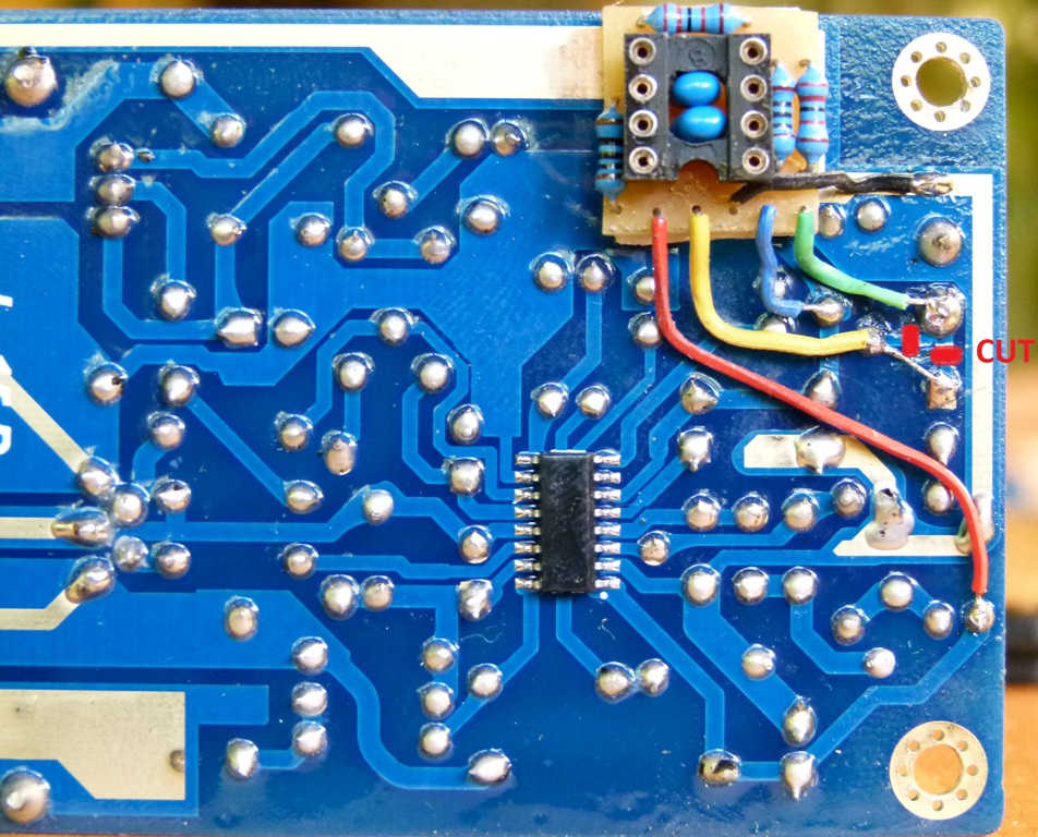

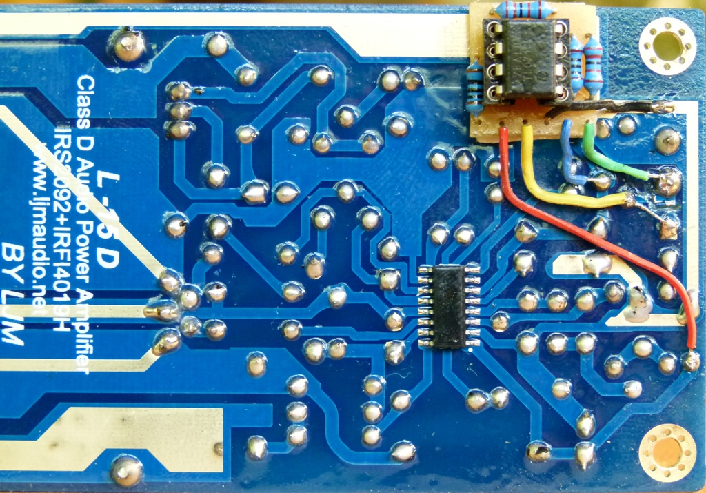

Tiny phase inverter for L15 , 20 and 25 D
I build this tiny phase inverter to drive 2 of the 5 amps in my HT amp with 5 L15D’s with opposite phase to avoid bus pumping .
The schematic is from the reference design IRAUDAMP7D REV 2.8 page 32
The PCB measures 16 x 16 mm and fits well under the amp with double sided tape . You’ll need some higher stand offs .
Works great
The scope pic is driving my front channels in a 4 ohm dummyload .
The decoupling caps are mounted in the IC socket
Works great
