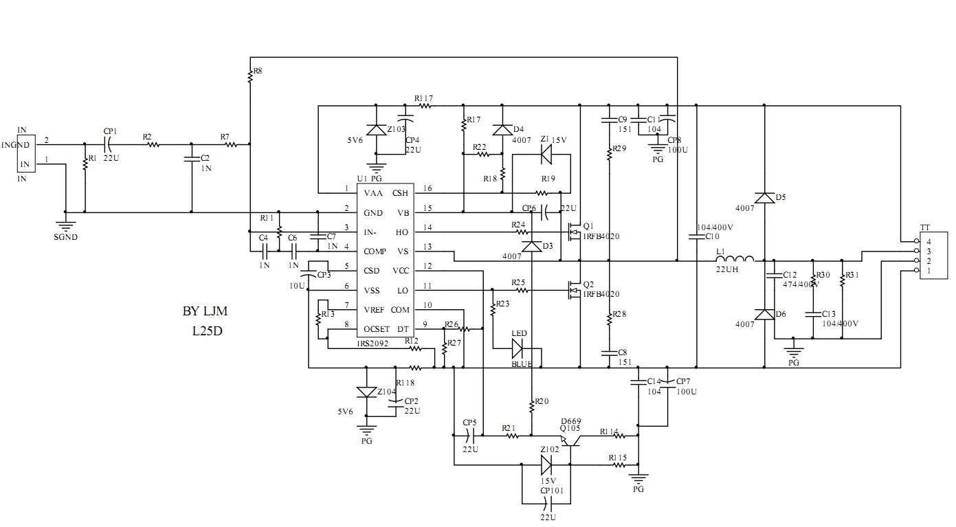

What is the input impedance of the L15D and L25D boards? The input sensitivity was listed for the L25D on eBay as 1.6V.
I am planning to build two monoblocks(in one case - 2 of everything except fot the case) for 4 Ohm 200 Watt 83 dB(1 W/1 m) speakers. I am thinking about using a passive pre-amp (just a 10K logarithmic potentiometer), specifically the TDK 2CP-2500M /10. My understanding is that a CD Player or a DAC(I am planning on having only one source) at 2V RMS will not need any amplification to be loud enough for the amplifier, so a real preamp is not needed. The sound quality is somehow influenced by the input impedance of the amp and the output impedance of the source. Keep these Low and High respectively it should sound great.
L25D Schmatic

Unsuitable for "Passive" Preamplifiers
So I finally found the input impedance of these amplifiers. It is 3.23 KOhm. This makes these amplifiers very unsuitable for "passive" preamplifiers.
For my needs I will have to spend a lot of money and get Hypex UCD HG with 100K input impedance. I would really prefer not spend so much money, but the passive solution is the best for me. The extra expense of the Hypex is compensated by the fact that I do not have to buy an expensive active preamplifier. Or does anybody know what I can do to make the L15D/L25D work for me? Are the hypexes passive friendly because of the opamp on board? Can I modify the L15D/L25D to take an opamp? Questions about questions, sorry guys about the long post, just trying to get a good system together without giving "the man" too much of my hard earned money.

@dechrlm : what is your source ? Most modern dac have an opamp output able to drive as low as 600hms. I used a simple stepped attenuator pot with L15D and my dac: result was just excellent. Maybe you could give it a try ?
Alternatively, if your dac output is weak, consider replace the output opamp in your dac. This might be the easiest and cheapest ;)
Introduce an additional active stage can only result in degradation, not noticeable in the best case. If not necessary, i think it is better to avoid.
