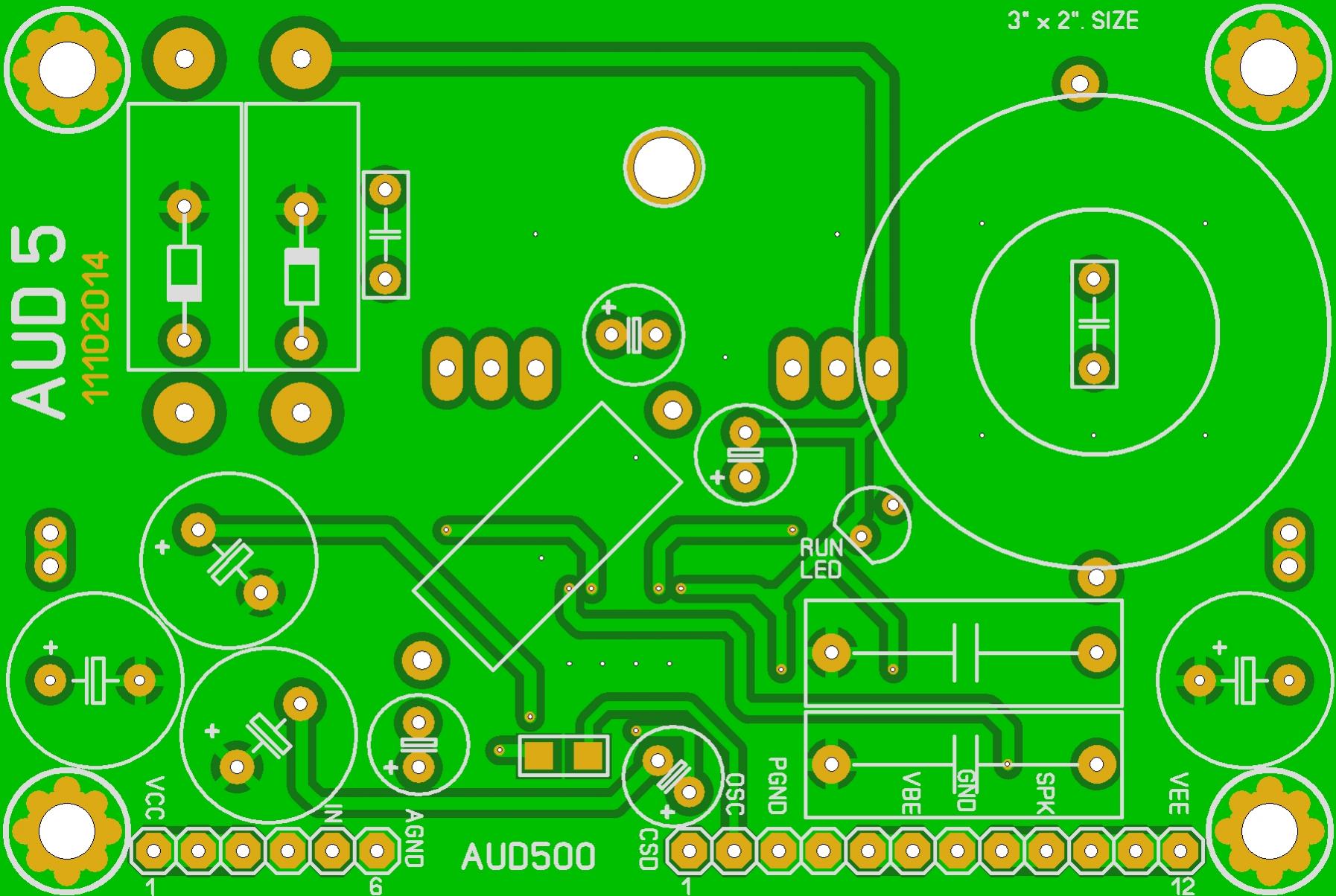

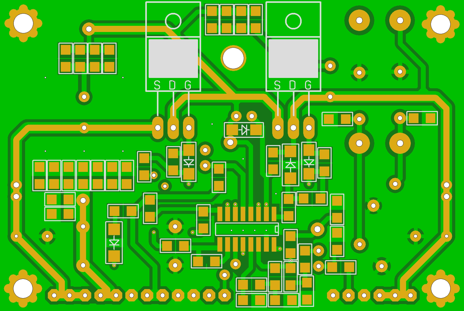

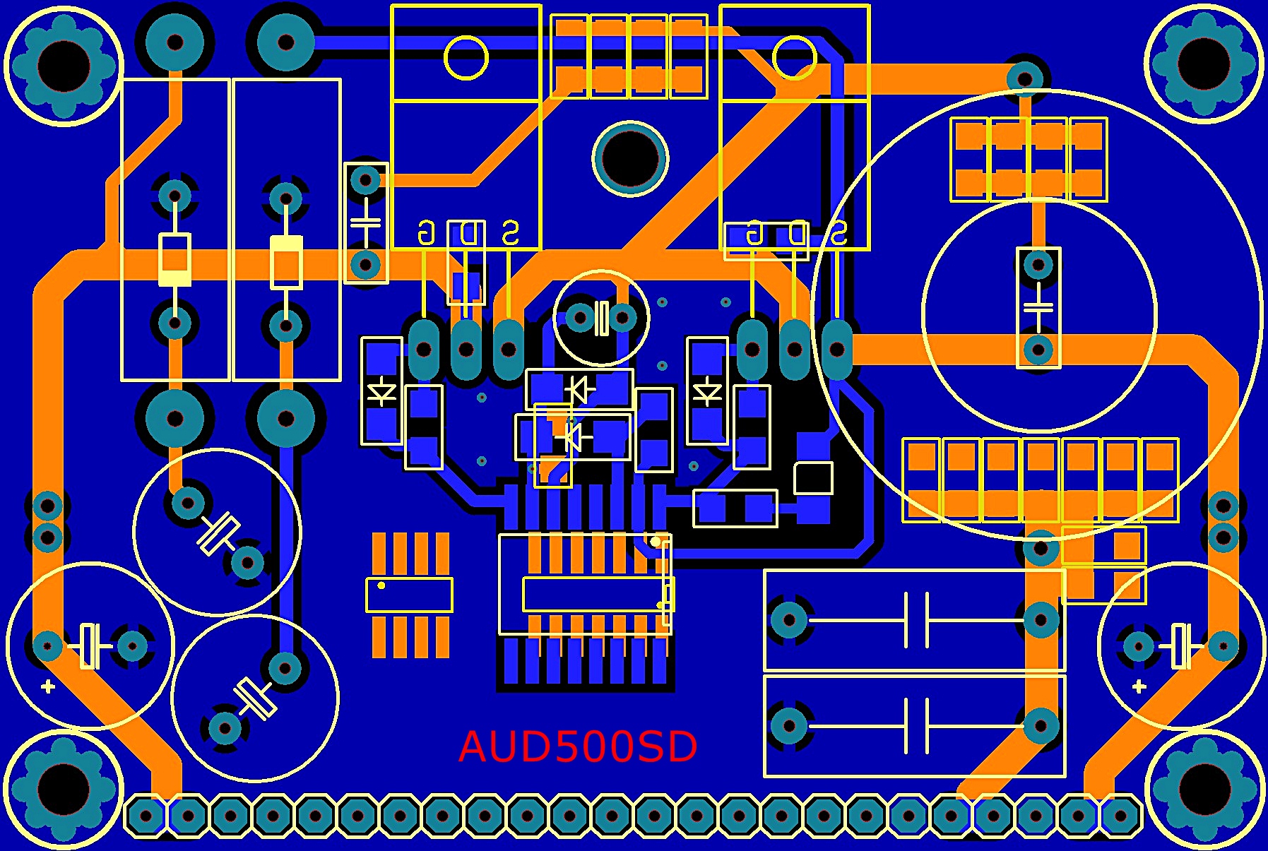

Hi All,
Success of my (smd ver.) AUD1000SD/1500SD , I start to design a small AUD500SD {size L=3" & H=2" vertically mounded} its for home theater purpose(those who are loved HT)
attached my design 🙂(not completed)
max. supply +/-65V
max. output 1000W@2R, 525W@4R 260W@8R load
Regards
MANOJ
max. supply +/-65V

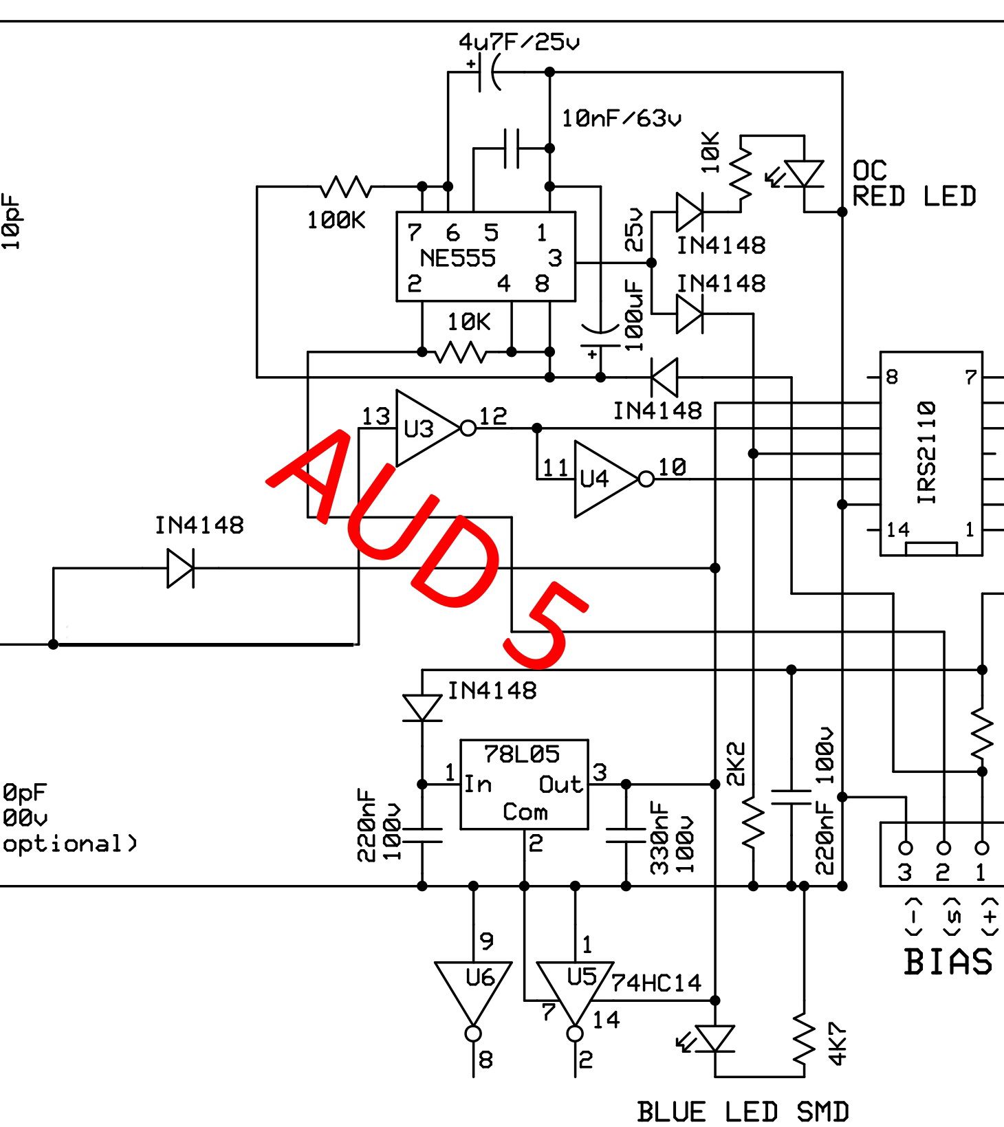

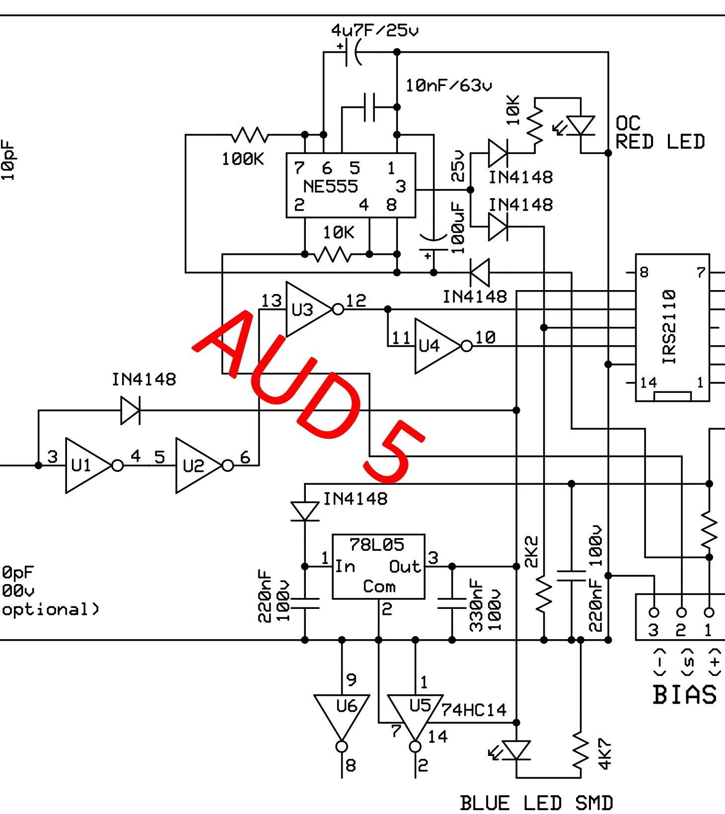

Hi Mr. manoj,
I have a question about the inverter IC,
Is there any special purpose to use 3 inverters on serial mode before feed it to the
HIN of IC IRS2110 (Picture 1)?
What happen if we only use 1 inverter each before feed it to HIN and LIN of IC IRS2110 ( Picture 2) ?
Warm Reagards
Syaelend
Warm Reagards
Syaelend
only for noise canceling (pure signal)
Regards
MANOJ

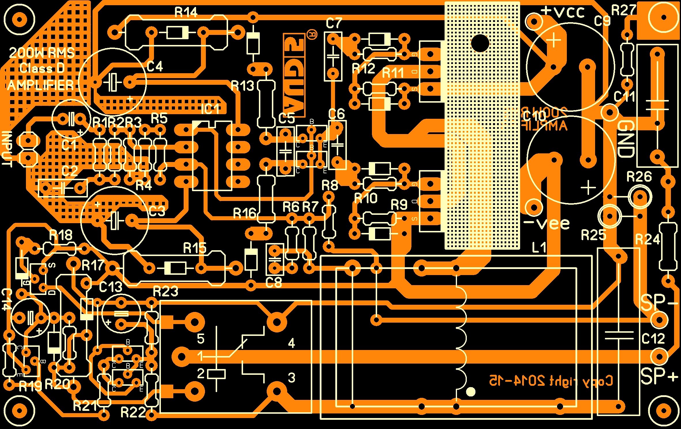

Hi All
my new simple class D amp AUD200U
8R @ 125W , 4R @ 250W & 2.6R (3x8R) @ 380W True RMS
8R @ 250W , 4R @ 500W & 2.6R (3x8R) @ 775W Peak RMS
cost @ INR 950.00 only ( material+man power )
Size 10 x 6.4 cm only
With DC protect
Optional Temp Protect ( add INR 100.00)
Optional Signal Limiter ( add INR 100.00)
Optional OC Protect ( add INR 250.00{PCB size 12 x 8 cm})
