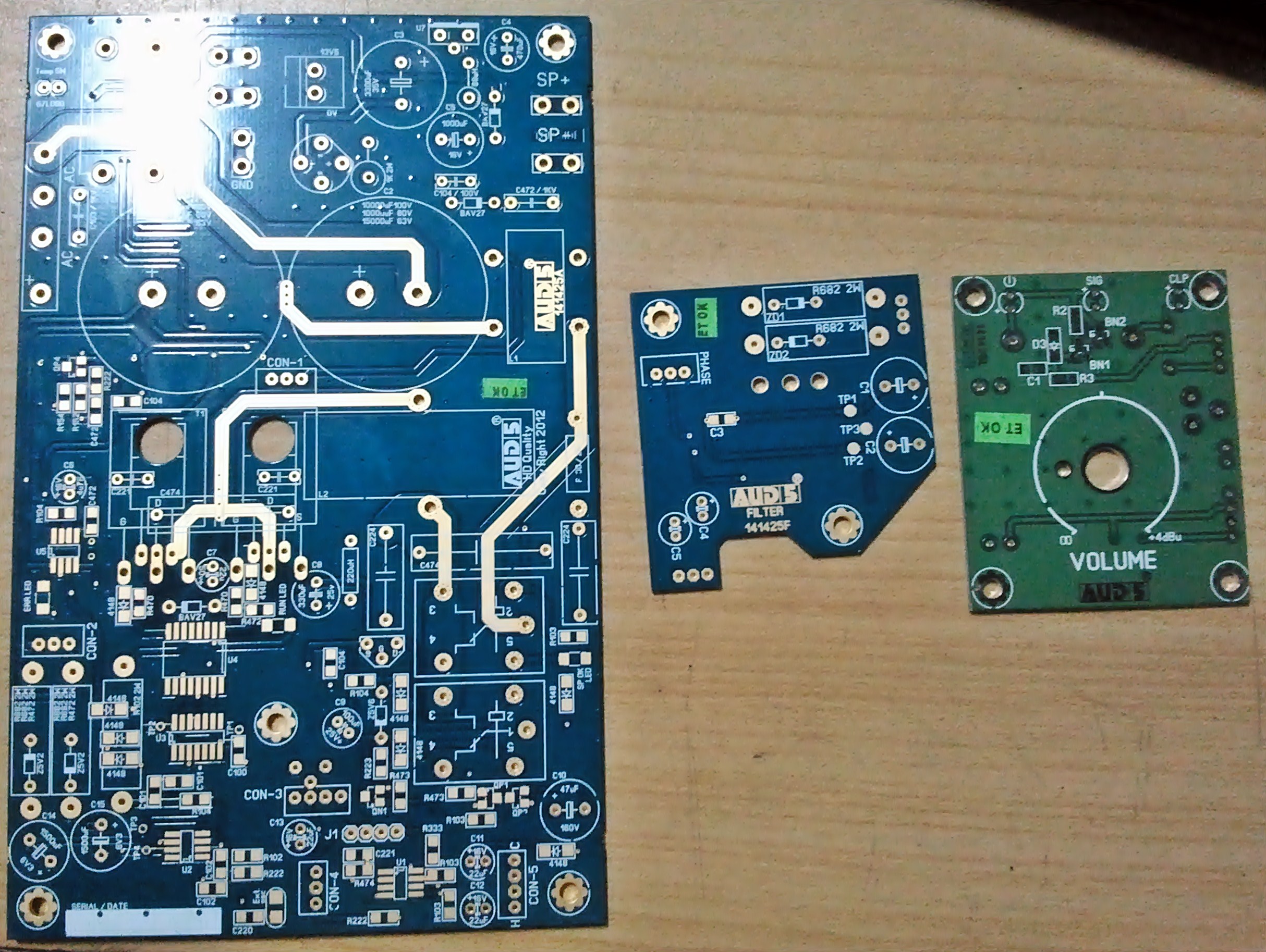

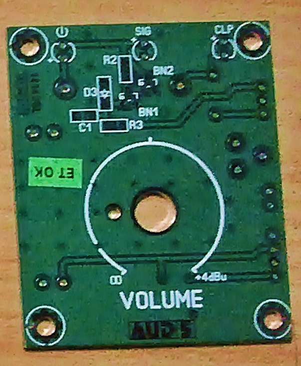

Hello Manojtm
greetings 141425L for Volume and Limiter with LED indication can this limiter be used for AB class amplifiers
warm regards
andrew
warm regards
andrew
Hi andrew,
I used APEX CLIP+SIG+POWER Indication circuit with little modification
Regards
MANOJ
Regards
MANOJ
Hi andrew,
Use any NPN Transistor. I used BC847 SMD

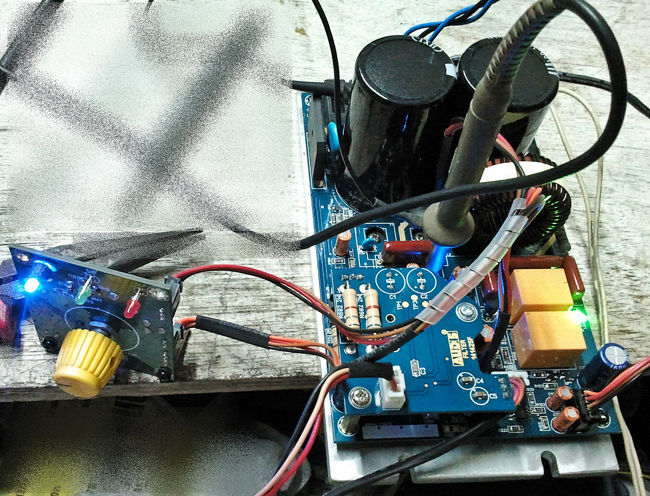

Hi All,
Video shot attached to FB just now { using my mobile cam sorry for the clarity }
https://www.facebook.com/photo.php?v=743477502375395&l=7469160341489528029
Regards
MANOJ

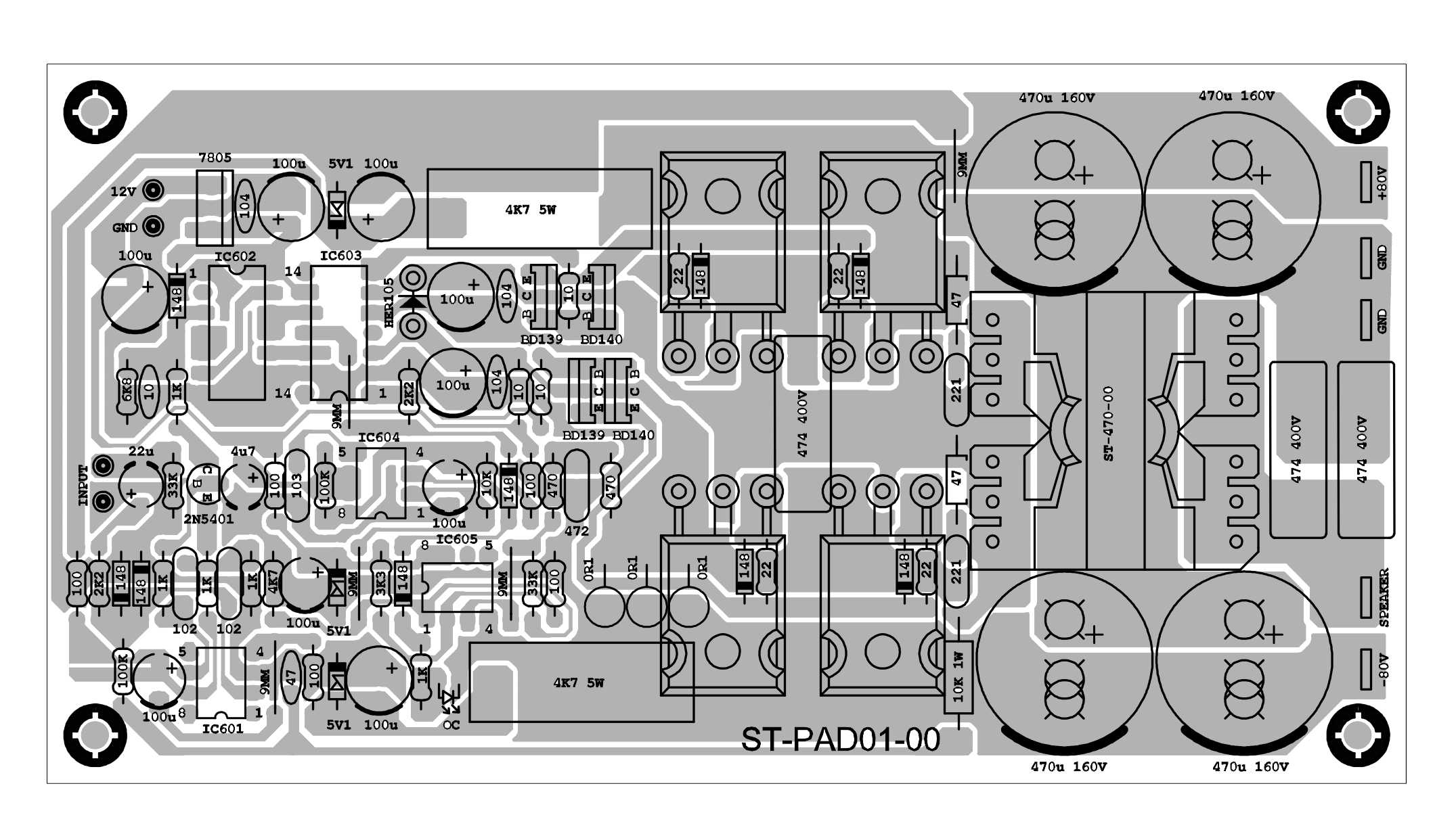

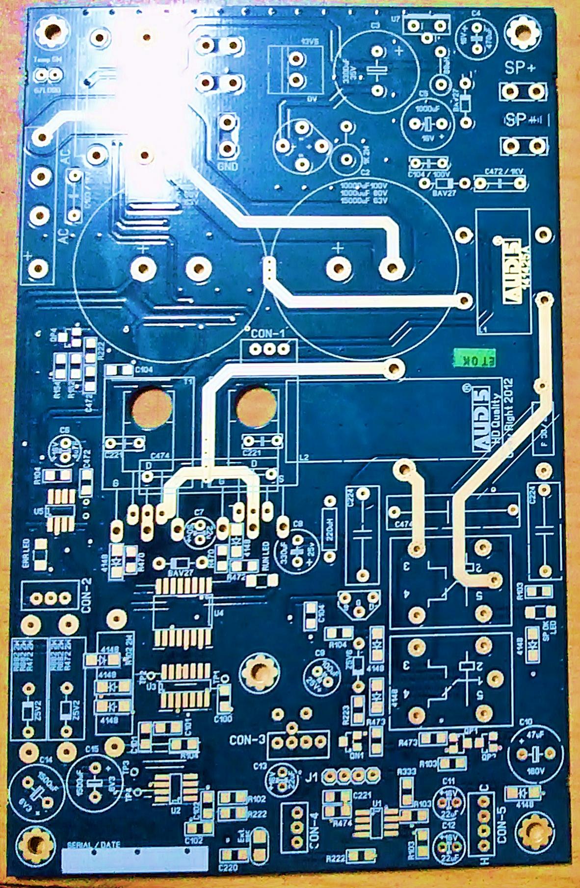

Hi Mr. Manoj,
Regarding to AUD600 Class D amp. I have a question..
Is there any problem if we use CMOS IC CD4049 instead 74HC14.
The advantage is we don't have to put IC 7806 regulator.
Thanks in advance
Syaelend
Thanks in advance
Syaelend
Hi Syaelend,
for cd4049 use same Bias volt (12V) don't need 7806 reg. IC
NB: using TTL/high speed ic will give noise free sound
Regards
MANOJ
Regards
MANOJ
Dear Mr. Manoj,
If we use TTL at this case 74HC14, is possible if we use 7805 regulator IC instead 7806?
I try to Re-design the PCB OF AUD600 including OCP feature.
Please give me some advices...
Best Regards
Syaelend
Best Regards
Syaelend

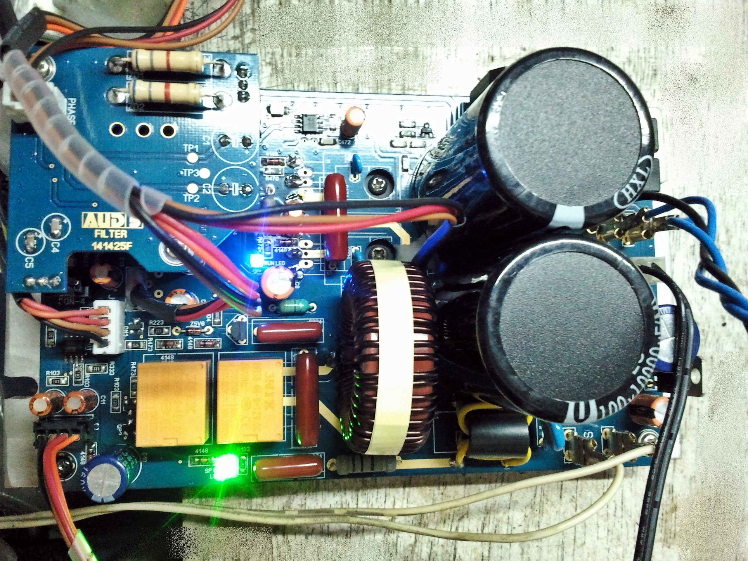

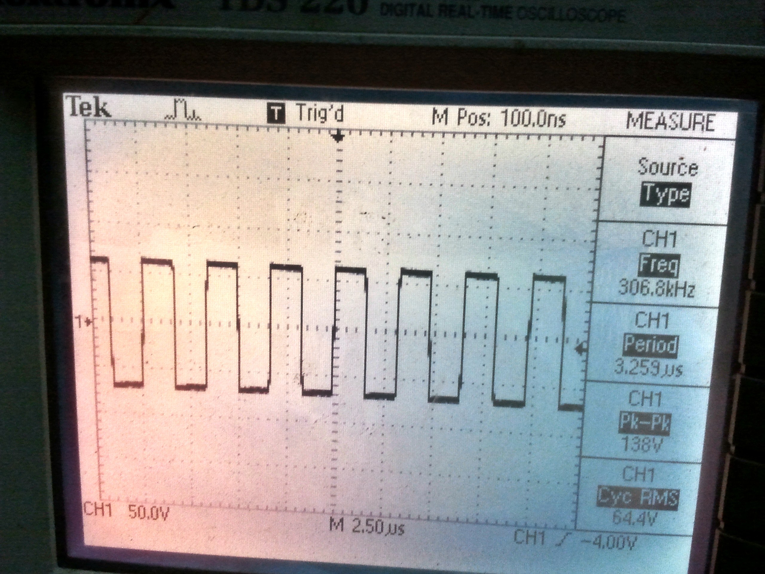

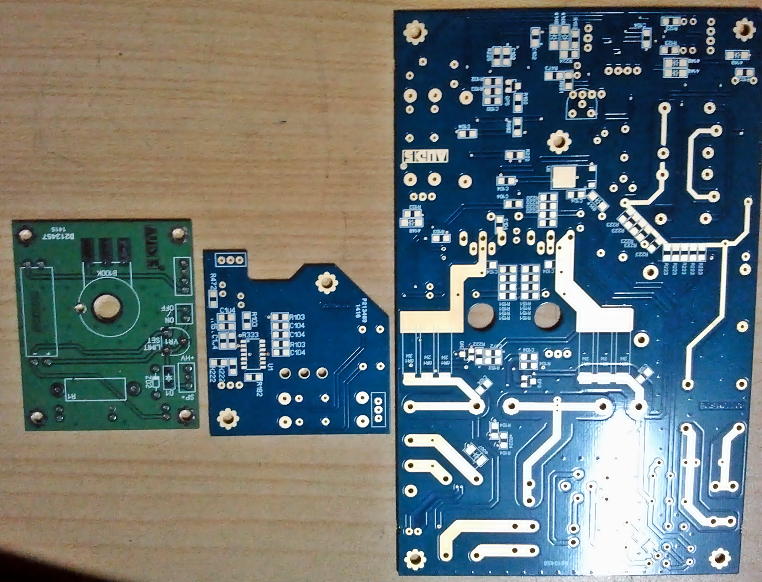

work stable,my new AUD1000/1500 design. it will support IRFP250 MOSFET with 300KHz without any noise and it will start without signal,(3x 8R load)2.6R load with +/-75V DC supply rail working cool
Regards
MANOJ
