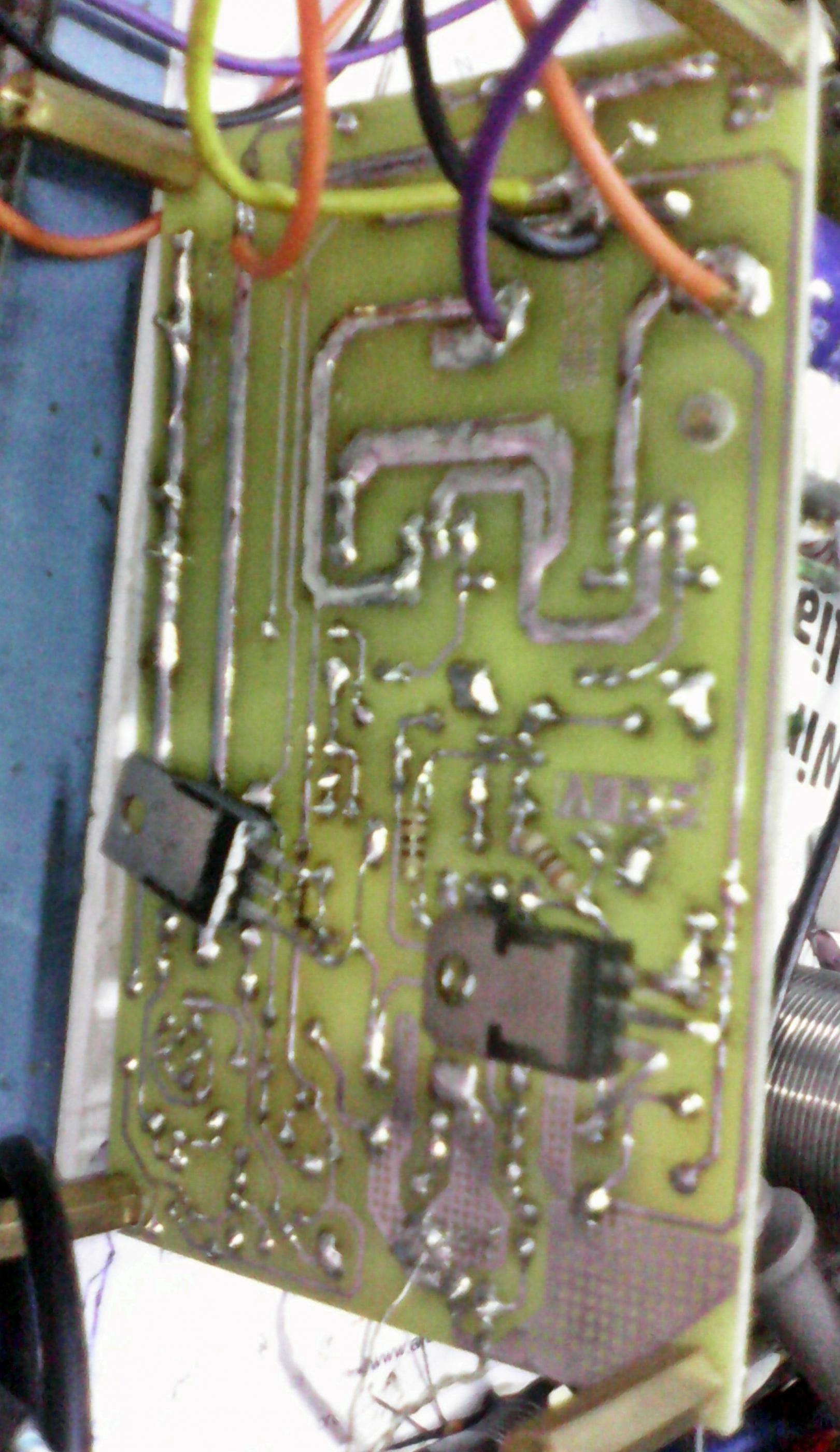

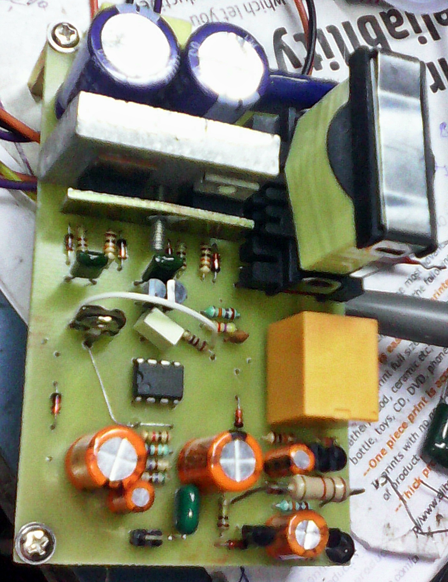

test PCB only. done some modification(picture shows) and now its run good
Supply +/-45V DC (+/- 47V DC max.)
fsw=@170khz
filter= used ETD29 {@80uH}
Temp:
MOSFET - max 55 deg. at 2.6R load on Full drive
FILTER - 37 deg heat only
added DC offset preset
Application:

Sir Manoj
Test pcb only means?
made only 3nos. PCB for testing. i need to redraw again (b'cz some components fitted on solder side)
Regards
MANOJ

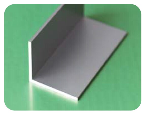

will you redesign it with large heatsink?
and if yes then will all the protection will be onboard?
Regards
Sabir
Hi sabir,
Yes. I planed to use 3mm thick and 80x80 mm L shaped aluminium 🙂
( picture shows 6mm thick one )
Hi sabir,
Hi Sir Manoj
sounds cool.. and what about protections. I am interested in your projects. i have some questions. do reply to pm
Regards
Sabir
Hi Sabir,
AUD200U
Protection:
Temp: used KSD9700 85deg. NC type Thermal switch
DC Protect : detect @2.7V 5ms 10A Relay and ON delay 3.3sec
OC Protect : @18A sense @45ms
MANOJ
AUD200U
Protection:
MANOJ
Hi Sabir,
AUD200U
Protection:
MANOJ

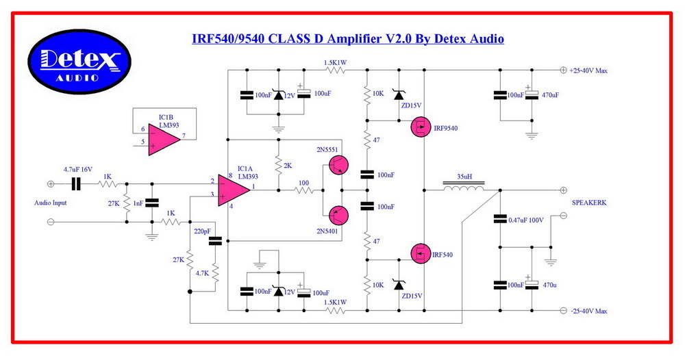

Hi PRAPORSHIK,
AUD200U
it is old simple class d amp using MOSFET irf9540 and irf540 with one comparactor ic.The circuit i modified and to get best result
<90% efficiency
can support up to 2.6R load (3 x 8R load)
Low noise
Regards
MANOJ
AUD200U
<90% efficiency
Low noise
Regards
MANOJ
Hi PRAPORSHIK,
AUD200U
<90% efficiency
Regards
MANOJ

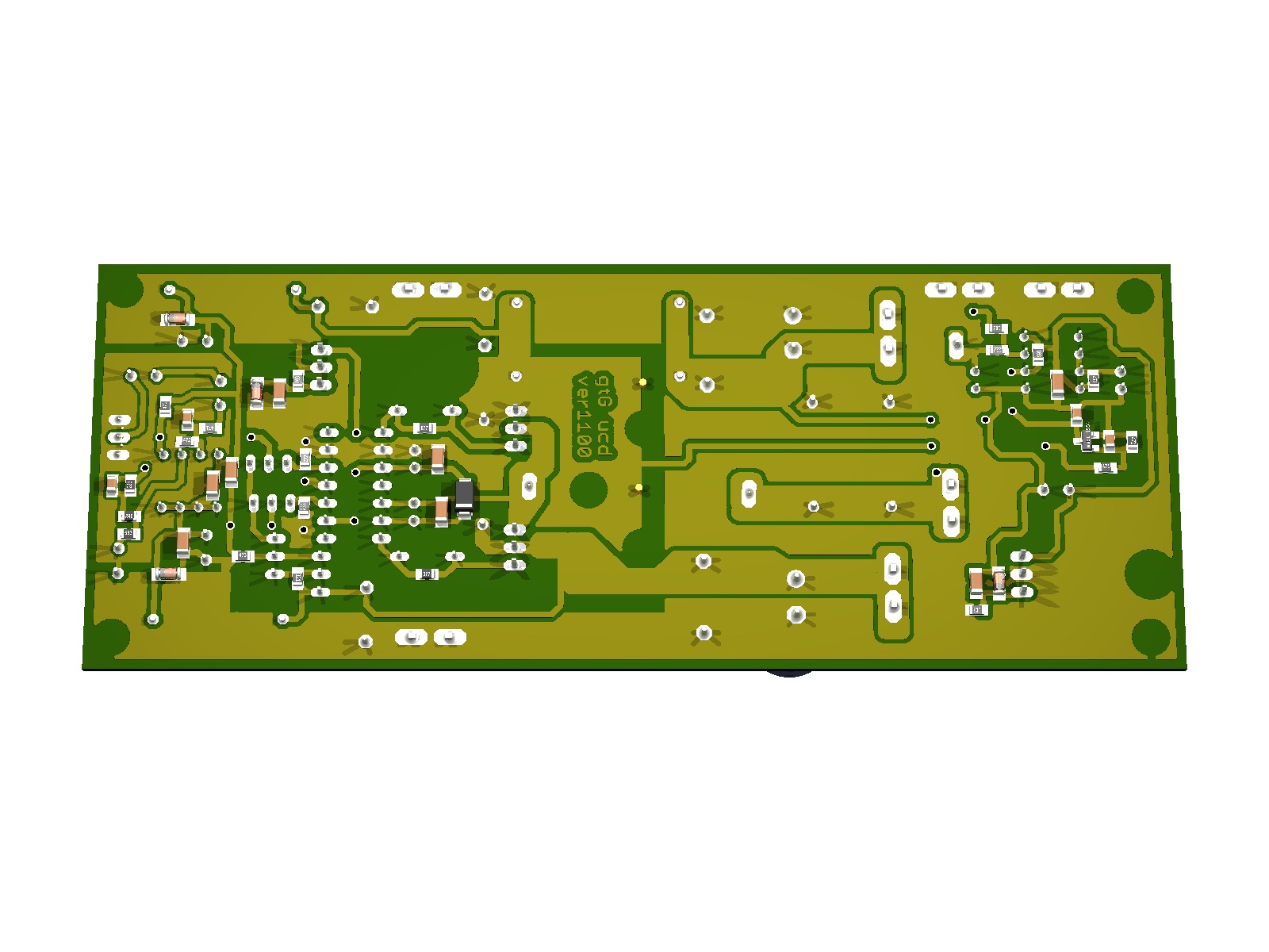

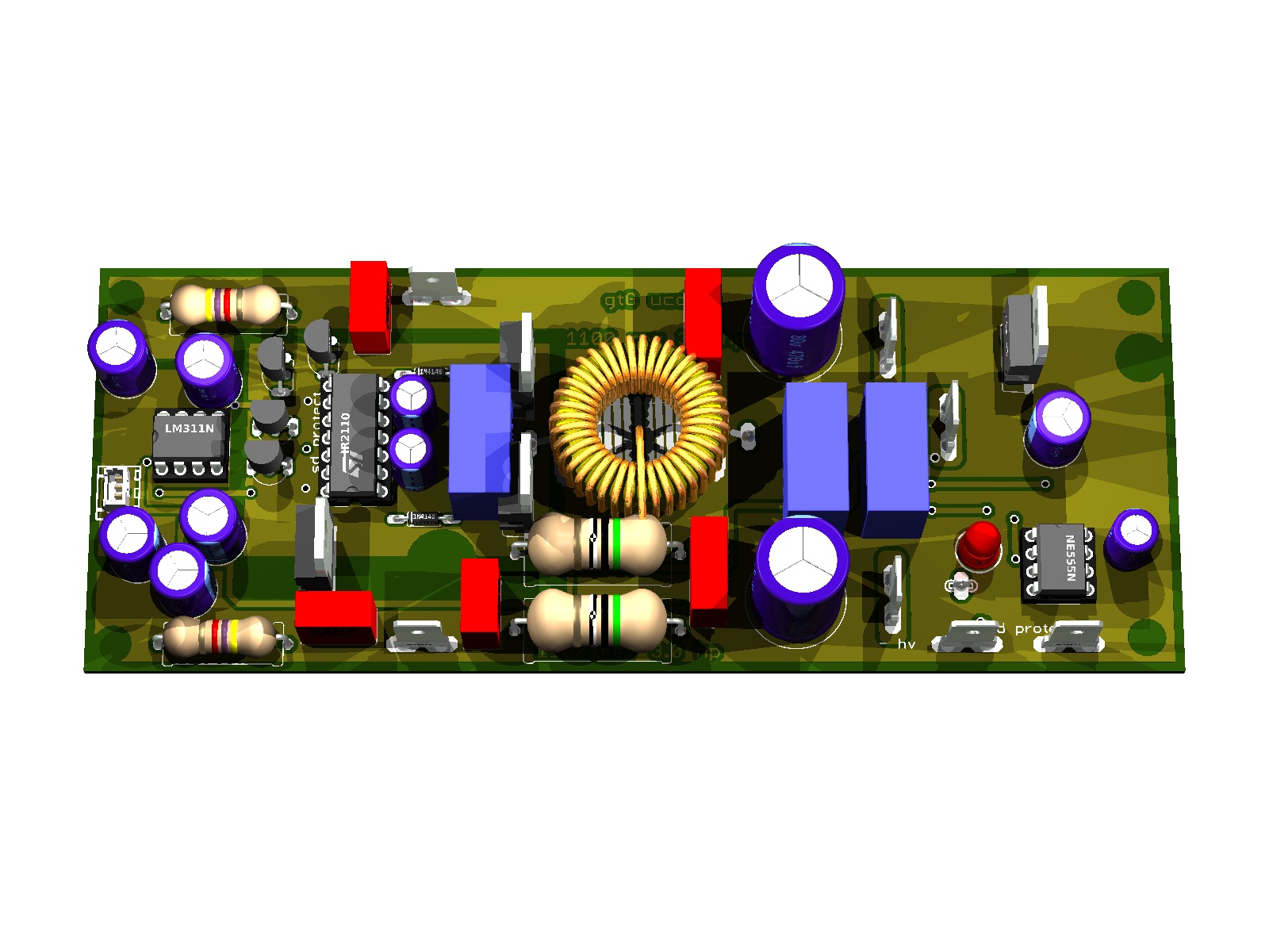

please show diagram
hi sir please post the protection side
Hi Stewin,
Definitely i will do. pls give more time
Regards
MANOJ
thanks sir . i,m waiting. meanwhile my ucd project with protection but it has smd parts.
gtG ucd 1100 rev 3.0 hp with protect semi smd pcb bottom.pdf33.6 KB · Views: 265
gtG ucd 1100 rev 3.0 hp with protect semi smd top components clear.pdf23.9 KB · Views: 265
gtG ucd 1100 rev 3.0 hp with protect semi smd bottom components clear.pdf24.1 KB · Views: 267
gtG ucd 1100 rev 3.0 hp with protect semi smd bill of materials.pdf45.6 KB · Views: 280
