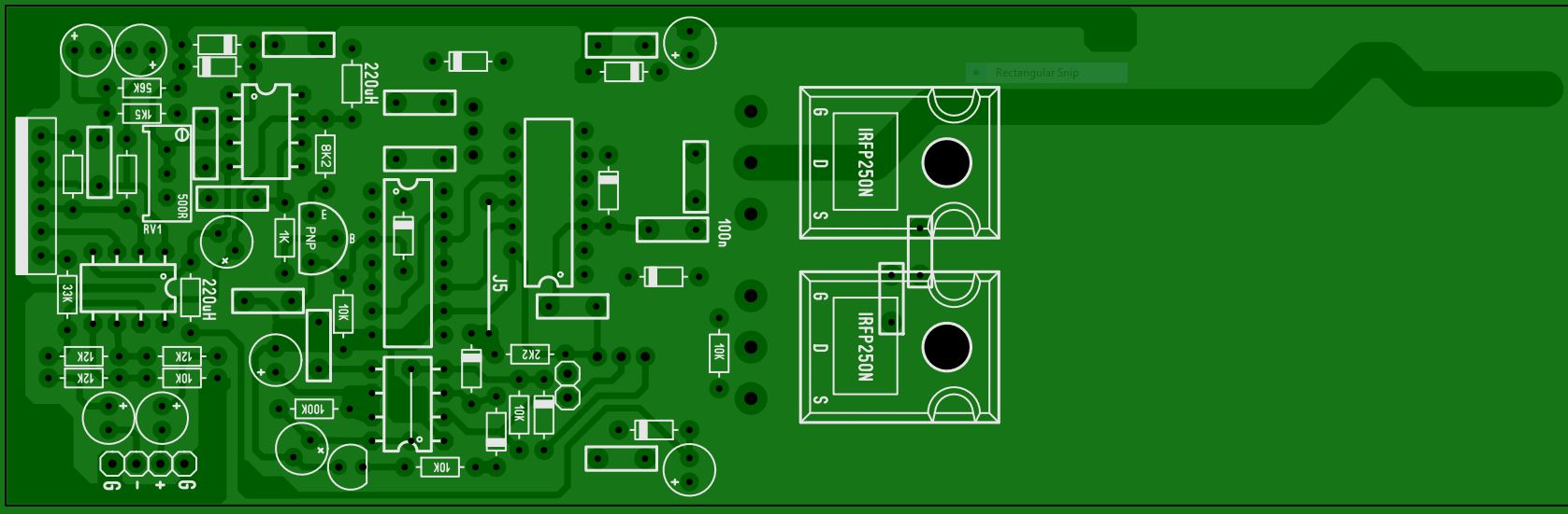

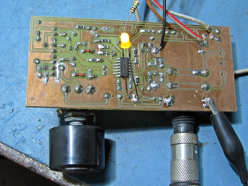

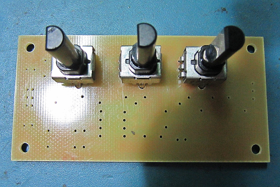

My class D amp
AUD-LIMIT PCB ready now 🙂
4x9 cm size
Regards
MANOJ

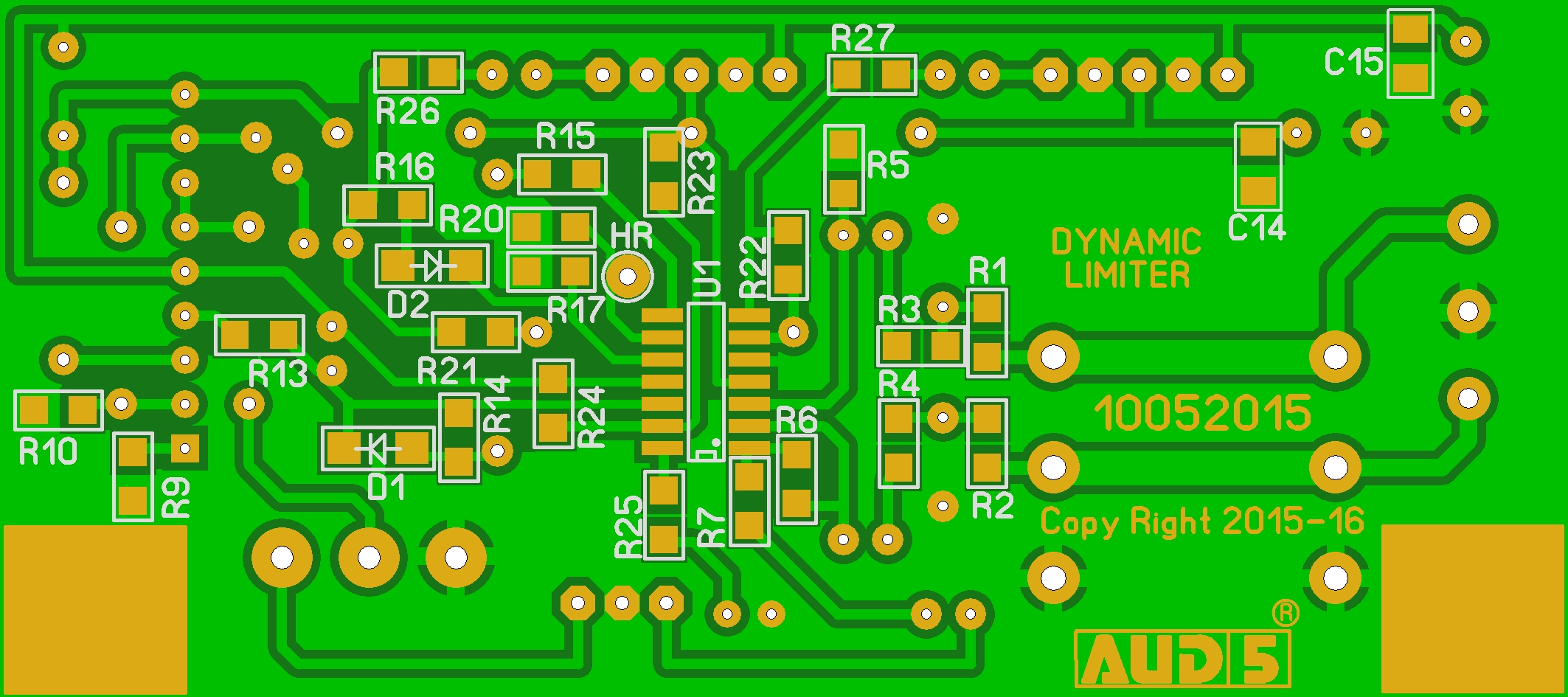

AUD-Limiter tested result
modified parts
R24-1K,R16-1M,R4&R3-22K,R28-4K7,C6-22uF
signal input and output limited level
100Hz - 1.18v p-p
250Hz - 1.21v p-p
1KHz - 1.28v p-p
10KHz - 1.32v p-p
Regards
MANOJ

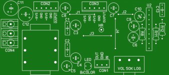

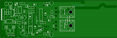

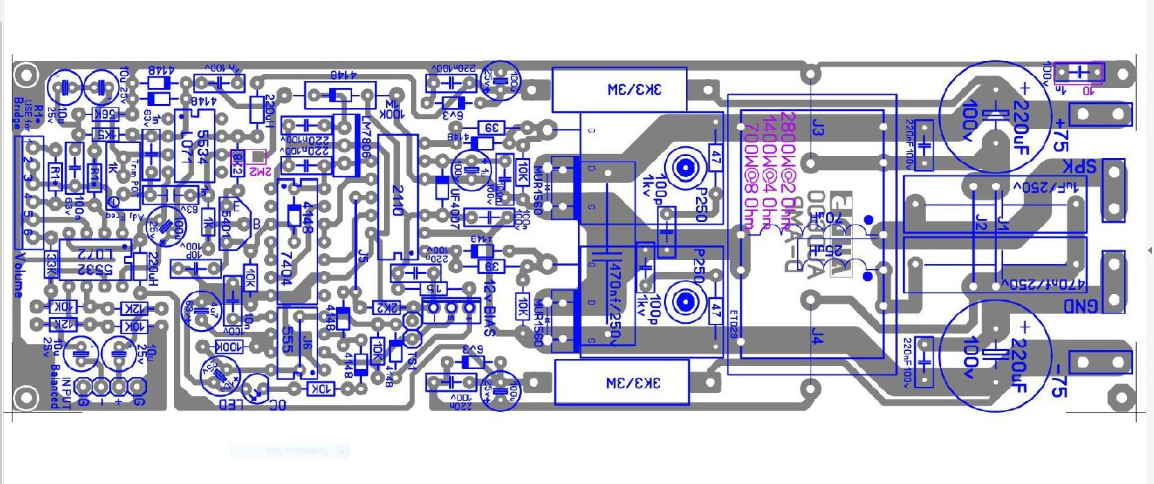

Hello monojtm do you have a more clear image of this layout ? I really want it to make a re-drawing for Sprint Layout 6 also if you can please send me the schematic to my e-mail vargasmongo@gmail.com
I already begin yesterday but image is too fuzzy no good for my eyes 🙁
I mean if you can of course
Best Regards
Juan
