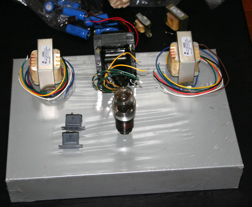

The OT's arrived today. Even these 'budget' 125ESE's are pretty heavy. Not as heavy as the power trafo mind.
The additional psu chokes allow me to run the tubes a little hotter so 80mA might be OK. neat idea to consdier doubling up on 125ESE's, but it adds quite a bit of iron to my 'simple' project.
Just adding an extra socket to allow some experimentation with 6A3's sounds simple, but I need to think a bit more about the heater supply - my power trafo has only one 6.3V and one 5V winding and with DHT it means the heater supply to my 6Sn7 will be bobbing up and down with a bit of the output signal on it - could be a cause for trouble ?? I could add a Hammond 167 later on I suppose.

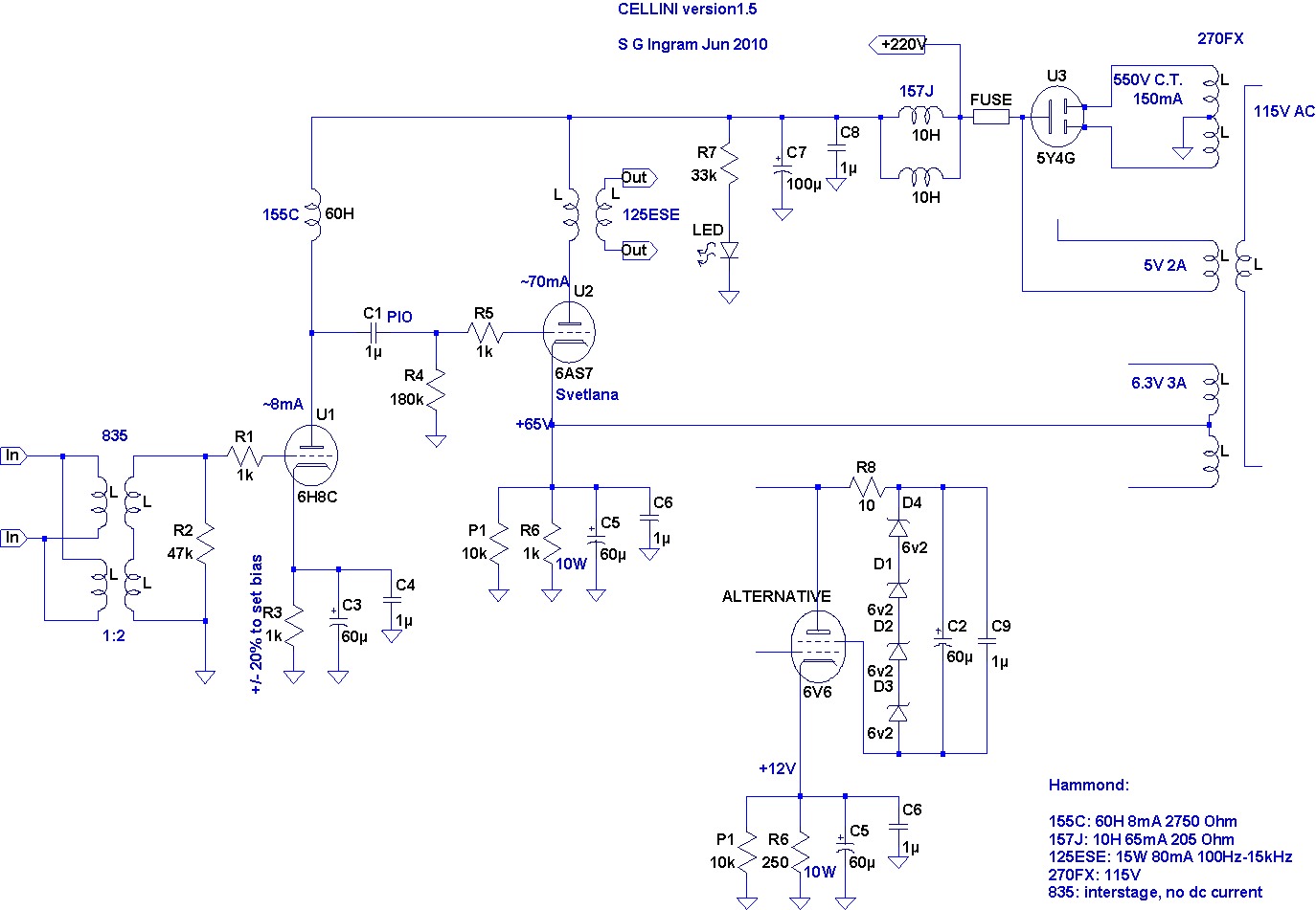

Hi,Whilst tube models for spice seem to be available on the web I'm not so sure about the trafo's - I suspect the idealized models in spice are inadequate, especially for the OT ?
Anyhow, this time around I think I'm going to stick with the old fashioned pen & paper approach.
although they might not but it's fast and easy.

Ok, you've drawn me back to the simulator - mainly because I think there's too much reliance on the quality of the tube models to make this very useful.
I found on the web one of the good models, triodep.inc but I also found reports of an error in the 2A3 model. I've corrected the model and I'm attaching the updated model file. You need to change the file extension from 'txt' to 'inc' in order to use it of course.
I'm also attaching my spice model file. You need to change the file extension from 'txt' to 'asc' of course.
The results I get, at 1W into 8R shows very little difference in harmonic spectra between the 2A3 and 6AS7. The 2A3 has lower H2 distortion. I've set up my model to run 8mA through the 6SN7's, 60+ mA through the 2A3 and 75mA through the 6AS7. I've also included Hammond's data for the OT, it has a 9.58H primary with 90 dc resistance. I've used the 2k5 tap to determine the turns ration and hence inductance of the secondary. I'm also using an 8R load rather than 4R. Lastly, in the case of the 2A3 I've bypassed the input transformer to allow for the higher mu of the 2A3 so that the output swing from both cases is more or less the same.

Wow, I've just seen the curves for the trioded CV6 - they are very nice !
This will be interesting, 6AS7 vs 6V6.
The trioded 6V6 is very well suited for Cellini as an alternative because the grid potential is so low at -12V it allows me to drop the value of the cathode bias resistor and increase the plate voltage considerably. Since the 6V6 wants more plate voltage than the 6AS7 this seems to be a great convenience.
The 6V6 has lower heater current to boot.
I'll try this whole thing without the input transformers first. The higher mu of the 6L6 certainly doesn't need it unless I want to wire up for balanced input.
Funny thing is, I was looking at Tetrodes many moons ago when I had even less of a clue as to what they are (http://www.diyaudio.com/forums/tube...omplementary-feedback-pair-2.html#post1912948)
p.s. can you spot the missing diode in my schematic ?

the pieces are starting to come together - although SWMBO says the chasis is too big (17" x 12") so that might have to change
IME, it's hard to change a SWBMO. But don't let me stop you trying 🙂

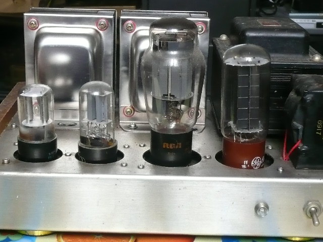

I built my using lesser irons.6SL7->6SN7->6AS7<-5U4
View attachment 6as7gkse1.pdf

It looks good.
This is quite a different beast than Cellini, you have a lot more gain and you've used it to enable some global negative feedback. This must reduce the THD a good deal. Did you have a chance to compare the sound with and without nfb ?
