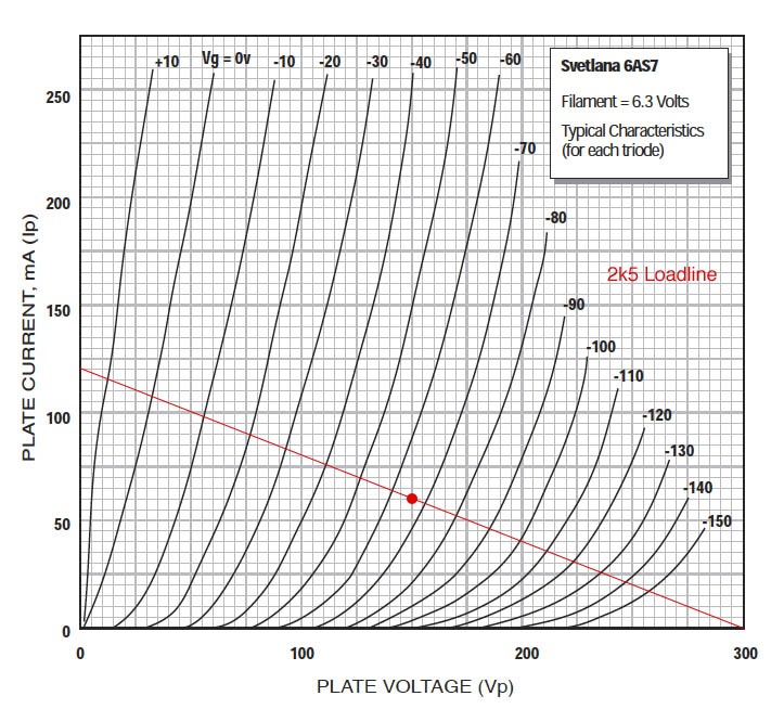

I've attached the curves for the 6AS7 from the Svetlana datasheet and I've drawn on what I think is the 2k5 loadline for the primary of the 125ESE output transformer.
I've positioned the loadline to intersect with the operating point that I often see used in published designs for this tube - B+ around 210V, Ip around 60mA (which is half the max rating).
Looking at the plate voltage with respect to the cathode means with Vgrid at -60V I use 150V plate voltage on the curves
Plate dissipation is therefore around 150 x 0.06 = 9W, within the max rating.
Have I got this right ??

Edit: forgot to take into account the -60V cathode bias 🙂
Load line looks fine.

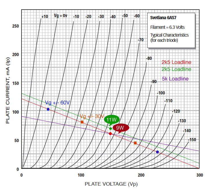

Power vs Distortion on 6AS7
So if I understand what I'm doing here, I have biassed the output to 9W plate dissipation, about 70% of maximum rating which seems a safe place to be.
Looking at the curves the 60mA plate current means higher distortion for a +/- 60V swing on the grid. See plot. Looks like the current swings + 42mA /- 33mA about the operating point (blue dots) and based on some calculations I've seen somewhere on the internet this is roughly 6% THD [1]. At a +/- 30V swing on the grid (orange squares) this drops to around 2.5%.
Increasing biass to operate at 11W (85% max) gives me 70mA plate current and lower distortion. With the same +/- 60V on the grid it looks like the current swings +41mA / -35mA about the operating point and this is roughly 3.9% THD. This tube wants to run hot.

I'm not 100% sure, but I thought that formula [1] was only for the second harmonic, not THD? I should check for myself...

p.s. Yes, you are right, the formula is good for H2 only but I figure that H2 is so dominant that the error margin of my caculations are much larger than the distortion contributions from higher harmonics. I guess I could also run a simulation.
