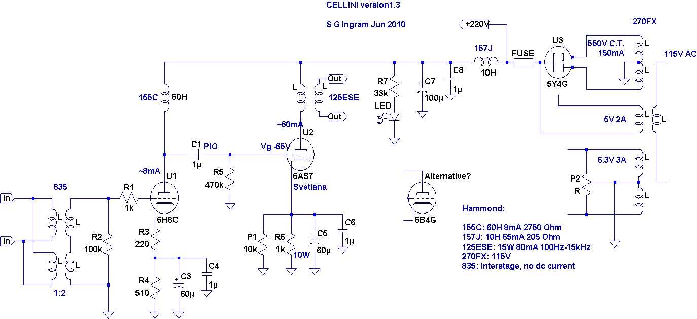

I'm afraid I have lots of questions...
Thanks for the advice (unfortunately, I'm no longer young, but I can still learn....)
So let's go back to the 6SN7. I like the idea of sticking with Octal bases (that's all I have !). I also like the idea of using up those 835's and configuring them to give me a 1:2 step up along with a bit of ground loop isolation from the source.
Would I wire them as shown in the attached schematic - i.e. with primaries in parallel and secondaries in series ?
The resistor R2 is recommended to terminate the transformer, but I've no clue what value to use here ?
I've added a potentiometer, P1, in parallel with the Cathode resistor to give me the opportunity to tweak the bias. Any concerns ?
The idea of the 6A3 does appeal, although to use the Octal bases I'd plump for the 6B4G. Is fixed bias the best option ? Would this tube operate happily at lower plate voltage or is this a waste ? Could I add some capacitance after the rectifier and boost B+ instead ? Would fixed bias be a good idea for the 6AS7 to save on a 10W cathode resistor ?
Looks good to me. The resistor at position R2 can be exploited to critically damp the input transformer's resonance (which is created by its leakage inductance and its distributed capacitance) if you know the resonance frequency. This will typically lead to a lower value than 100k but you must keep in mind that the input impedance will be R2 / 4 and your source must be able to drive that. If you don't know the transformer's specifics, 100k or 47k will be fine.
It'll scratch when you turn it (pots don't like DC on the wiper), other than that it should be fine.
Yes and maybe: with fixed bias you'll have more power and a different sound -- less SE-like, but tighter bass. I'd say, it's definitely something to try as a hack later on. You may or may not like the result.
Edit: oh and regarding P2: you should either use the center tap, or use the pot to create the ground reference for the heaters. Don't do both at the same time (P2 will have no effect in your case).

Try to stick to the 6AS7 in this one, the 125ESE OPT is rather BW limited and the low rp of said tube will drive it better than a 6B4G or similar. I use the cheapest EDCORs in my kitchen amp and the 6AS7 goes below 20Hz without any problems (though higher harmonics due to core saturation).
Gain: Well, you need about +-70volts peak to drive the 6AS7, so (as Kenneth mentioned) it depends on signals coming in. What is the gain of the 6H8C in your circuit? A 6SN7 will give you a little under 20x gain, which means 2Vrms into the amp will be just fine.
Bias schemes:
In my amps I use a combination. In the RCA datasheet for 6AS7 it is recommended to have a small cathode resistance which provides 7.5volts of cathode bias. (If memory srves me that was the value). I have 100ohm resistors providing me about that voltage, and then a negative voltage for the grid.
In the kitchen amp I only have 135volts on the plates, and I think the grids are at -60volts or so. I get about 3Wrms out of that amp. That's about what you can expect out of your amp. Dont let that stop you, those watts are sweet😉
In my livingroom amp, I have 190 volts on the plates, and the grids are at -85volts. This amp uses One-Electron UBT-1 OPT and even though I use the 16ohm tap into 8 ohms, I can only swing so much current thru it, and end up with a mere 6watts rms. The 6AS7 really needs a lower impedance OPT for max power. Still, the 6watts are wonderful, and when my buds are over for movies, they can't believe the slam and volume the amp gives us.
Anyhow, the bias has been stable and to me gives a good compromise between available voltage swing, distortion, and power.
You will have a bit hum unless you do a bit 'aikido' b/c 100UF just isn't enough with this low rp tube. I use 1000UF in the kitchen amp, and it is ok. My livingroom amp runs twice as hot, and even with 3000UF I still have a little hum. I was actually comfy the way it was, but this forum has poisoned me, and need to get it better. I am now including a CCS type Vregulator and it is promising. For the 'aikido' trick, read about it on tubecad, it works.
However, for this build, I recommend going KISS and just get it done as you've drawn it. Enjoy this amp as you sit up late and design your next one, having learned a lot and not been boggled down by too many things to try and never get anything finished.
Btw. I would reduce R5 to <200kohms. Omit P2 and attach one heater end to the cathode of the output tube. The positive bias of the heater will eliminate any hum from that source.

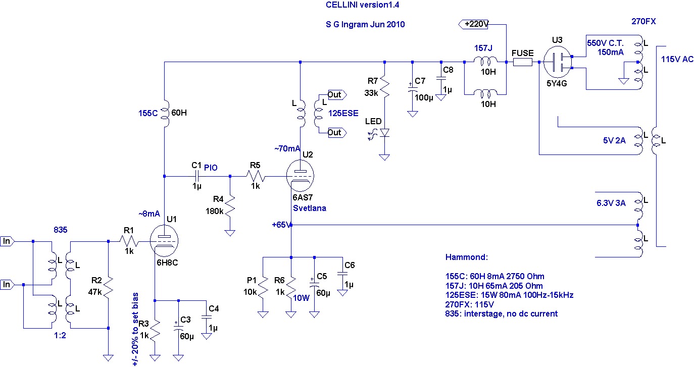

The resistor at position R2 can be exploited to critically damp the input transformer's resonance if you know the resonance frequency.
I've had no luck finding that information, would the answer be to test it - i.e. look for evidence of bad behaviour by feeding the trafo with the 1kHz test signal off my scope and looking at the output from the secondary ?
...Also you should check if the OPT will work okay with the 6a3, since it has much higher rp than the 6as7.
Good question - I checked, rp for the 6B4G is only 800R, which is close to the 6AS7. They are both so much lower than the impedance of the OT primary that I don't see their differences in rp having any affect. But with direct heating I might anticipate a hum problem.
I use the cheapest EDCORs in my kitchen amp and the 6AS7 goes below 20Hz without any problems (though higher harmonics due to core saturation)..
On my recently posted schematic I have downsized the cathode bypass cap for this reason. I figured that 60uF would produce some fall off by 20Hz whereas a larger cap would potentially allow more distortion from the OT. I guess the risk is that residual low freq. AC flowing through the cathode resistor will modulate the bias and cause some IM distortion with the signal ?
Gain: What is the gain of the 6H8C in your circuit? A 6SN7 will give you a little under 20x gain, which means 2Vrms into the amp will be just fine.
I had wondered about the heater bias, I've read that it's advantageous to bias it positively with respect to the cathode. I thought I could do this by hanging a potential divider off B+ and hooking that up to the heater C.T., aiming for 10V above the cathode of the output tube - but strapping it to the Cathode is simpler and that appeals to me.

OK so the design is 'final', next step is to order any missing parts.
I've removed the un-bypassed cathode resistor from the input tube (to maximize gain), added a grid stopper to the output tube (mostly out of a habit from SS days), lowered the input trafo termination resistor, lowered the grid-shunt resistor on the output tube, connected the C.T. of the heater winding to the cathode of the output tube and doubled up on the psu input choke (my friend says he has a couple more somewhere) because the current rating of these things is 65mA and I expect to draw 80mA per channel.

Hi,run a simulation.
I've been waiting to see what's gonna in sim..
I've run. See what you'll get.View attachment 6as7gcellse1.pdf
View attachment 6as7gcellse11.pdf
Whilst tube models for spice seem to be available on the web I'm not so sure about the trafo's - I suspect the idealized models in spice are inadequate, especially for the OT ?
Anyhow, this time around I think I'm going to stick with the old fashioned pen & paper approach.
Joined 2009
Negative!
As much as I like the 6AS7 the 2A3 must be as close to perfection as possible. But between the kids, the house, the dog, even the wife, and all other things, more than 10years have past with only the 6AS7 as my companion thru late nights and good wine😉
Seriously though, my 'dream' system is a 2A3 SE amp driving the mids/highs and a 6AS7 PP driving the bass...and I'm not waiting another 10years before that is realized🙂
But for the price, I really do like the 6AS7. It's main hitch being low mu, but made up for the way it handles even 'poor' OPT.
I suspect I'm not alone when I consider that my time is limited and that I'd like to think I'm going to all the effort to craft a nice amplifier based on using good parts and a good design. Then we find ourselves looking over our shoulders because the 2A3 has this cult following and the 6AS7 does not.
The reputation of the 2A3 gets repeated over time, perhaps growing out of proportion until we reach a point where everyone has to have the same tube - prices go up, diversity goes down.
Still, it would be interesting to hear opinions on the relative merits of the sound of the 6AS7 vs 6A3 (I don't care so much about the differences in mu so long as the circuit delivers enough sound) - are differences large or small.
