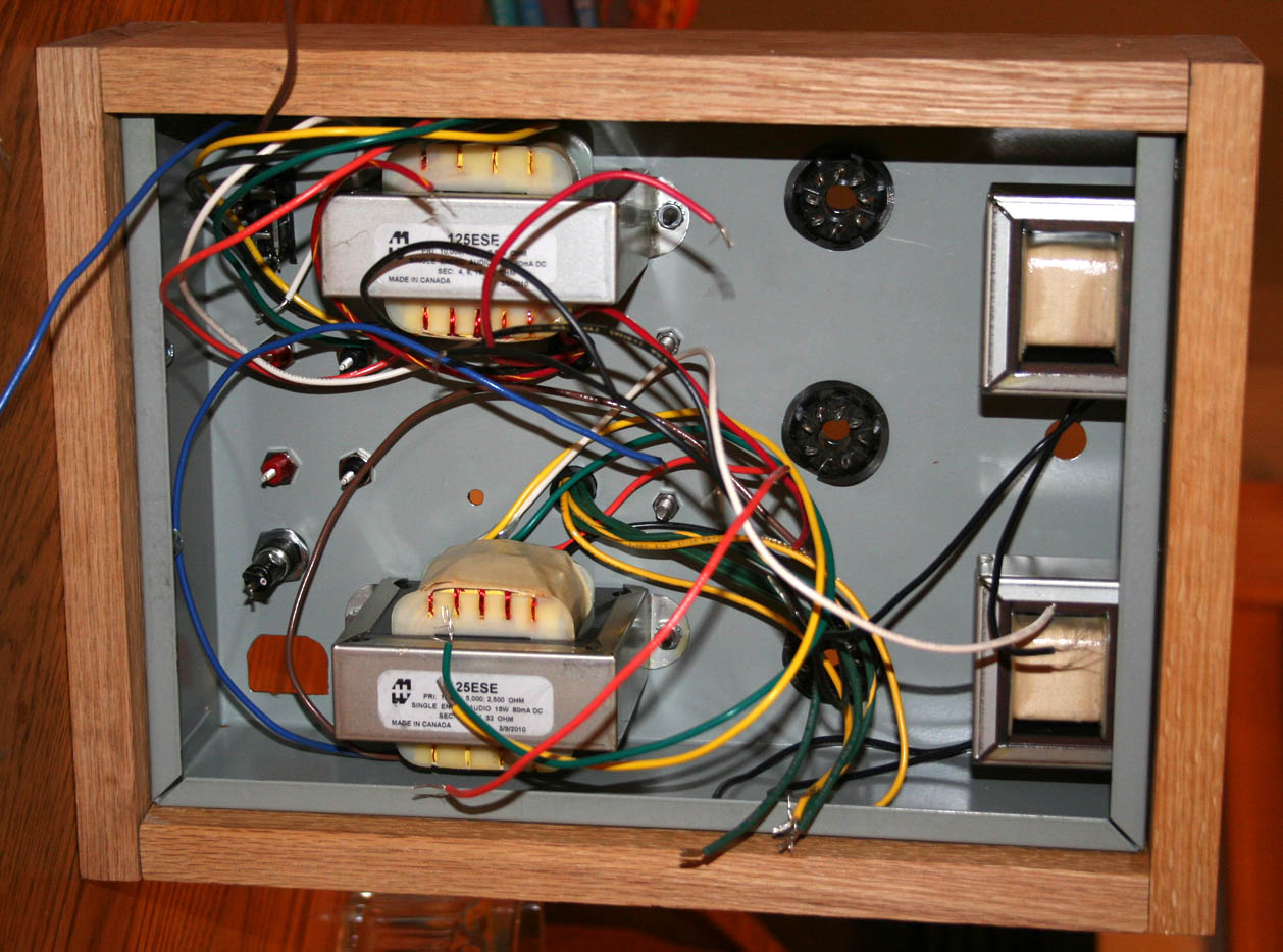

I worked late, but a complete first assembly isn't there yet. Here are a couple of photos of the first test-for-fit assembly. I guess I will have to live with the limitations of my workmanship for this one - and hope to goodness I fit the wiring in there, it's a bit tight.

Not really trying to rain on your parade, but probably am.. Sorry.. 🙂
Mounting the OPTs directly under the power transformer is probably not such a good idea. Even though they are mounted in different planes there is going to be some stray field from that power transformer that could couple into those OPTs, inducing hum in the output. (This is somewhat less of an issue with amps using global feedback.)
You can test this by powering the power transformer (make sure all leads are insulated so they cannot short).. Place a 600 ohm resistor across the primary of each OPT and measure the voltage across the secondaries of the OPTs. Anything more than a mVrms or so is a cause for concern.
It is also extremely tight, where are you going to put the supply capacitors and cathode power resistors assuming this is cathode biased? I hope you can get it to all fit.. Better to use a box that is a little on the large side than to try and cram everything into a very small box.
One potential option would be to build the PSU in a separate, but identical box.

I think there will be a lot of things to discover over the next couple of weeks. Not only have I no experience to fall back on with regards transformer isolation but I can see there being a big thermal issue with the cathode resistor on the underside. I'm not even sure how much B+ I'm going to get either or whether there's enough room to keep the heater wires away from trouble.
I was about to order a new 17 x 12 box to replace the one I cut in half and use it as a test bed chasis but decided to 'practice' cutting holes in this one first before rushing to make a mess out of a new one.
Now I figure I may as well do some experimentation with it (I have a pair of 6C4C tubes on their way and this might be a preferred option for a 'final' version). If the cathode resistors generate too much heat I'll have to figure something out, maybe cut some ventilation holes, move them the topside or design a compact fixed bias source...
p.s. it will be interesting to see how much flux leakage we get from the power trafo through the chasis. It's still possible to turn those OTs and screw them into the sidewalls of the chasis.

Not too late to move the power transformer to another chassis.. 😀 That would buy you a lot more space to build in, and solve the magnetic issue..
Sounds like you are having fun as well as learning, and you can always rebuild it later..
