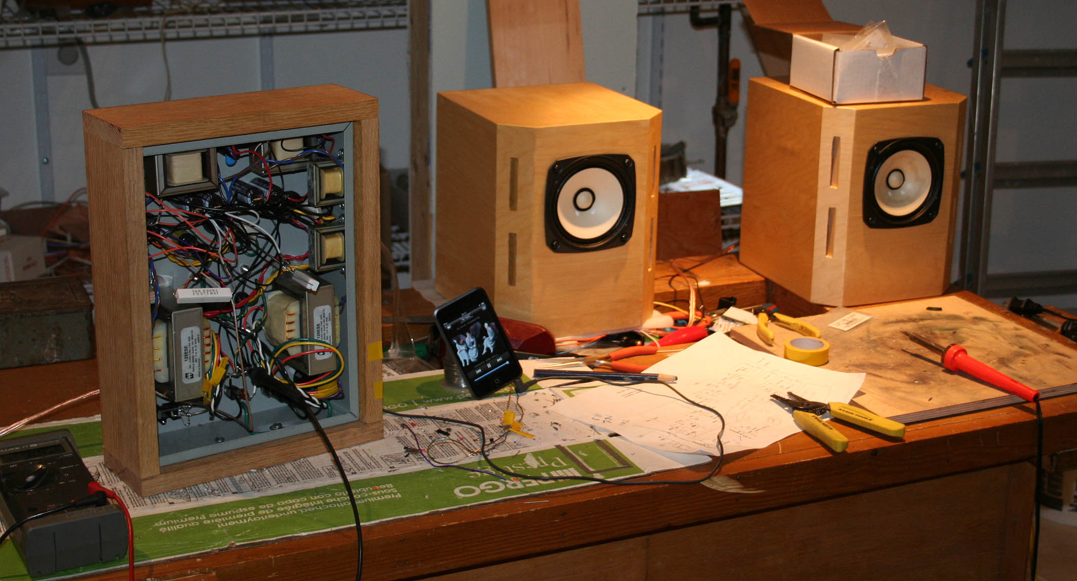

It works !
Instead of fixing the hum I decided to go for gold and do some temporary wiring up of the input tube and install it.
Added 0r33 in series with the rectifier heater circuit since it's not fully loading the trafo the voltage is probably a bit high.
End result - powered up and voila, 3 glowing bottles.

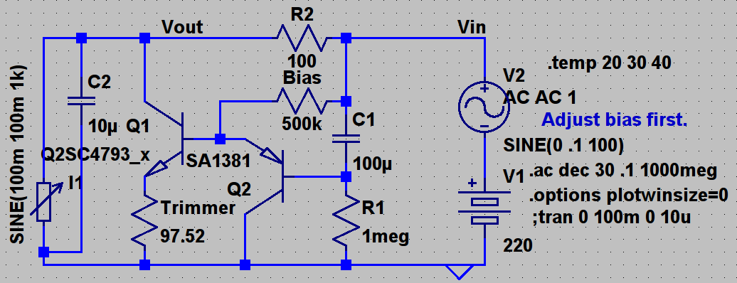

If you're adventurous, maybe you could look at feedforward regulators. They can be simple (especially for the low currents involved in HV), and offer the possibility of completely "tuning out" the mains ripple, without a low of NFB. - keantoken
I'll post my adventure in the simulator. I'm not familiar with HV design much but here is a quick attempt at a simple design. Don't know how solid state compares to burning state here... Depending on input ripple quiescent of Q1 can be reduced. - keantoken

Excellent idea ! - for high voltage and low current typical of tube psu's a shunt regulator looks very well suited. I think Broskie is a fan too.
I'd better verify that the B+ ripple is the main culprit before considering this approach. I'm thinking of adding additional filter capacitance to the B+ of one channel and then comparing the two channels to see if this has a clear impact.
