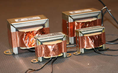

Do you see those four empty bolt holes in the core?
Thanks for the advice! But where would I get those bolts? The originals were very soft and easy to wreck, even with the right size screwdriver. I had to cut one off.
- keantoken
Hi keantoken,
Probably soft so they didn't retain magnetism. I'm not sure, but steel bolts trump loose laminations any day. Ask someone who knows transformers better than I do later on. The important thing is to support the lamination stack.
-Chris

I've been distracted, vacations and other stuff. Well my tube benefactor furnished me with some copper tape which allowed me to put some belly straps on all the trafo's (see attached - although OTs not shown they were also strapped).

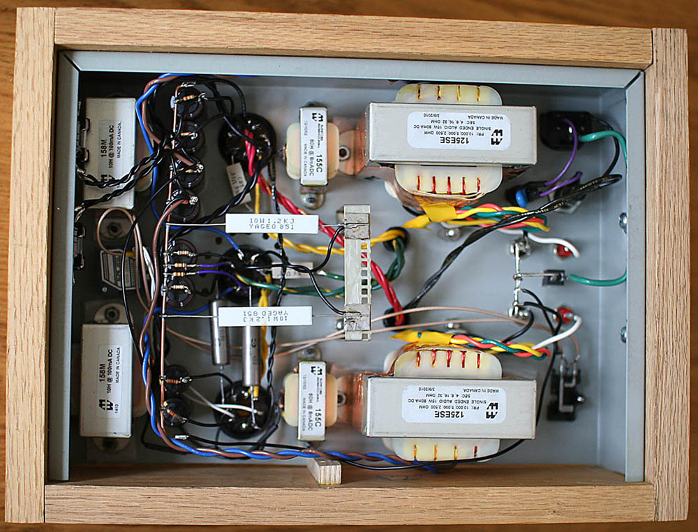

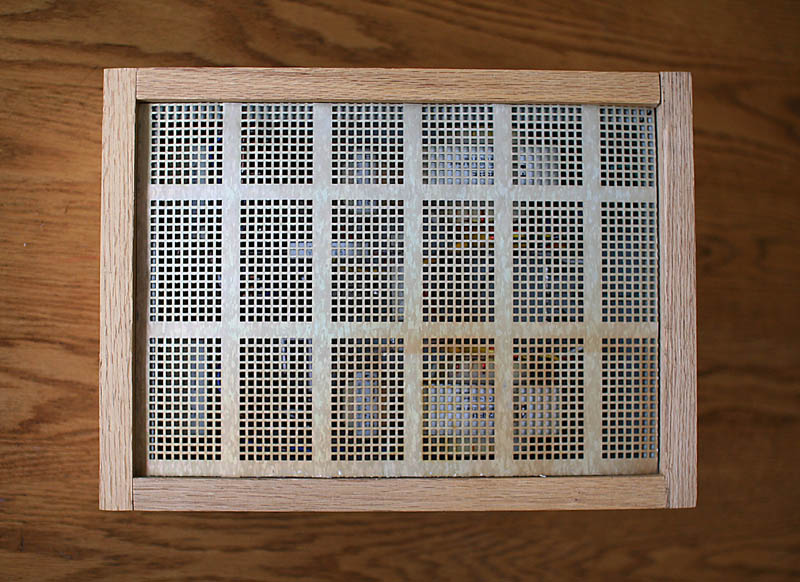

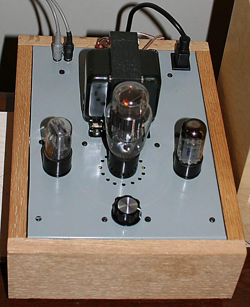

Well it was time to rip out the wiring and re-do it in order to make any progress. It was working but it was never going to fit inside the box properly. Put it down to beginners learning. I've added the Alps volume control and installed some new Russian PIO inter-stage coupling caps. I don't know how well the thermal management is going to work out yet, the cathode bypass resistors are held up in 'open space' away from other components and I've added ventilation holes around the power tube to help air flow inside the chasis.
However, I wasn't able to make it super neat or to a standard that I'd be happy with if it wasn't my first tube amp but I learned a lot that will make the next one all the better.
It's now playing in my living room, through my DIY Moon Onken speakers. I not only hear the violins, I hear the bow on the strings. Nice.
A couple of photos attached, the underside open, the underside with a safety cover and the top side. It still needs proper feet.

Hi Gareth,
Looks pretty nice. Not only that, but it's finished and working.
