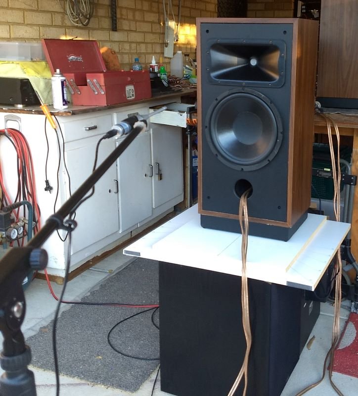

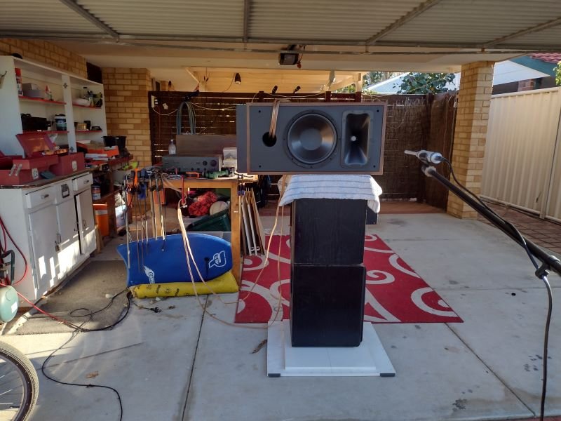

I built a turntable to do this along the lines of Dr Geddes DIY unit. Helps a lot!
These are some Econowaves I built this year for my niece. Doing horizontal and vertical off axis measurements....
Cheers.

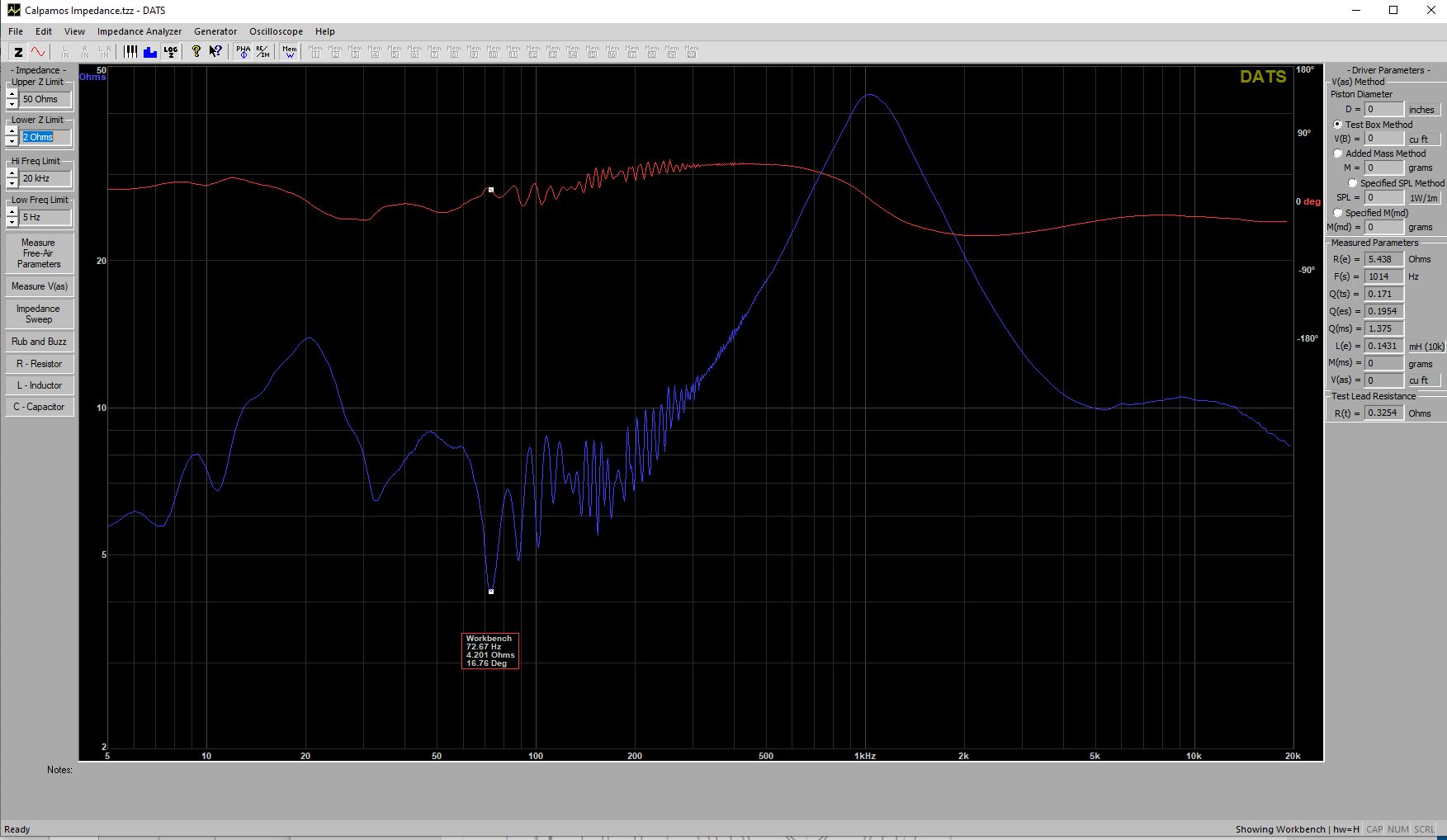

I am not sure if I did this entirely correctly, but I think this is an impedance graph of the Calpamos that I made with DATS. I had a bit of trouble getting DATS to function (at all) when connected it to my portable computer. I had to run it as Administrator and make a few changes to settings in the control panel in order for it to even pass its initial calibration of the test leads.
Anyhow, here are the impedance and phase plots. They aren't an exact match but they seem to follow the general shape of the ones Tony published in his PDF. I'm not sure what to make of the squiggles between 50 and 300Hz. When I measured my FHXL speakers, I got similar squiggles in that frequency range...
The impedance curve looks suspicious to me. If it is true, it implies your speaker is severely malfunctioning... which is obviously not the case.
if you have a resistor handy, measure it with DATS. if you still get squiggles, something is wrong with either DATS, the PC, or they way they are interfaced.
j.
j.
hifijim,
I would suspect the setup of DATS on the PC; the FH-XL is a single driver speaker, and hence no XO components to deal with - according to Eric the impedance measurement of the FH-XL also had the same squiggles...
+1
The squiggles might be a result of a low test signal / poor signal-to-noise ratio. Can you increase the signal amplitude?
Also, the Calpamos documentation shows the impedance maximum higher than 40 Ohm at about 1 kHz. Yours is quite a bit lower. This looks like either the xover or the drivers are behaving differently.
