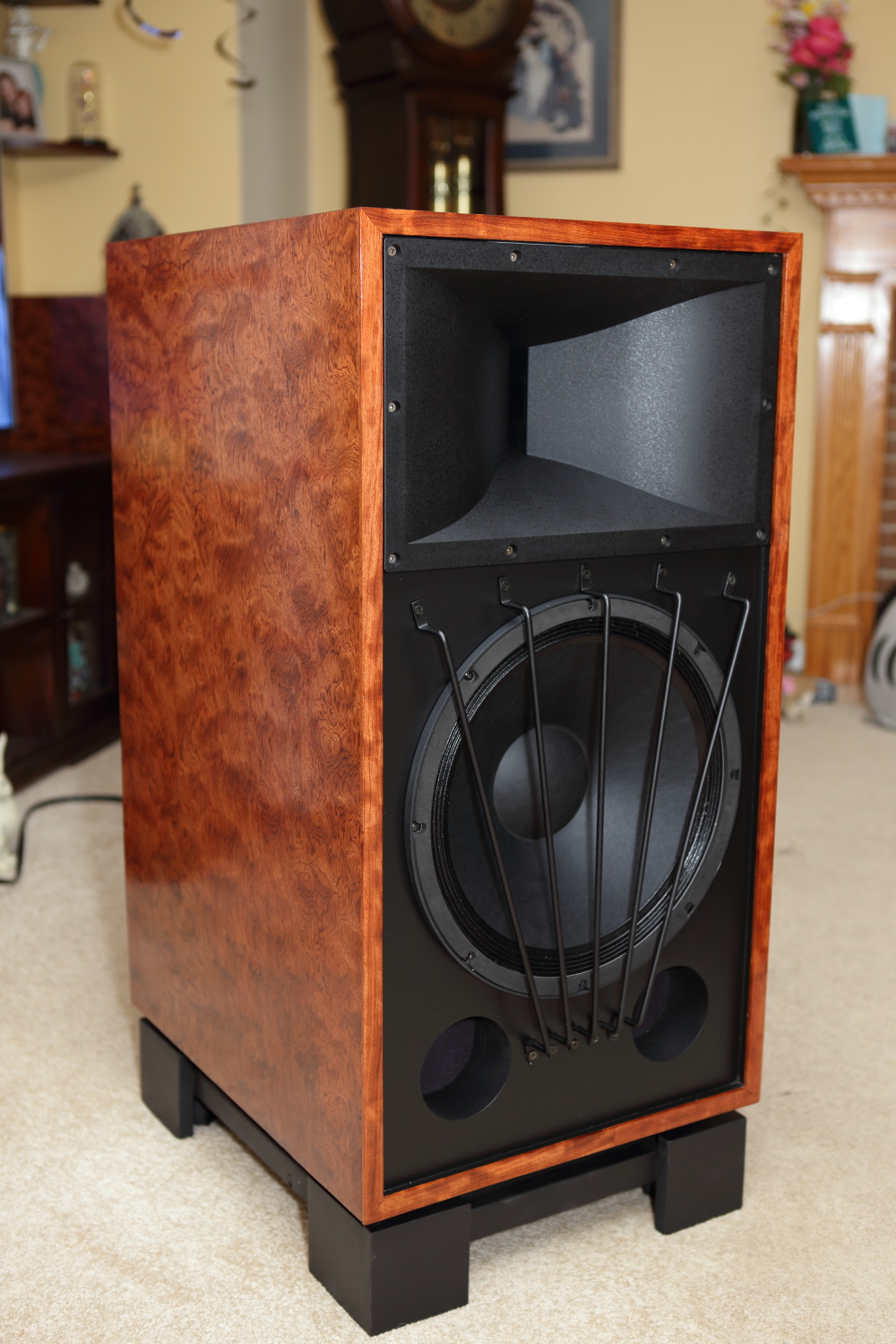

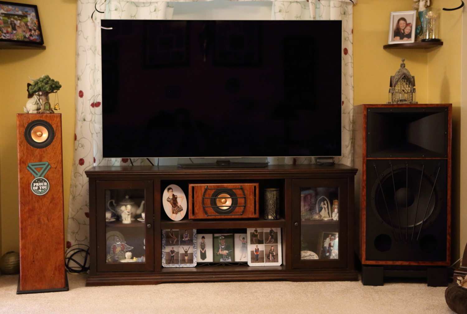

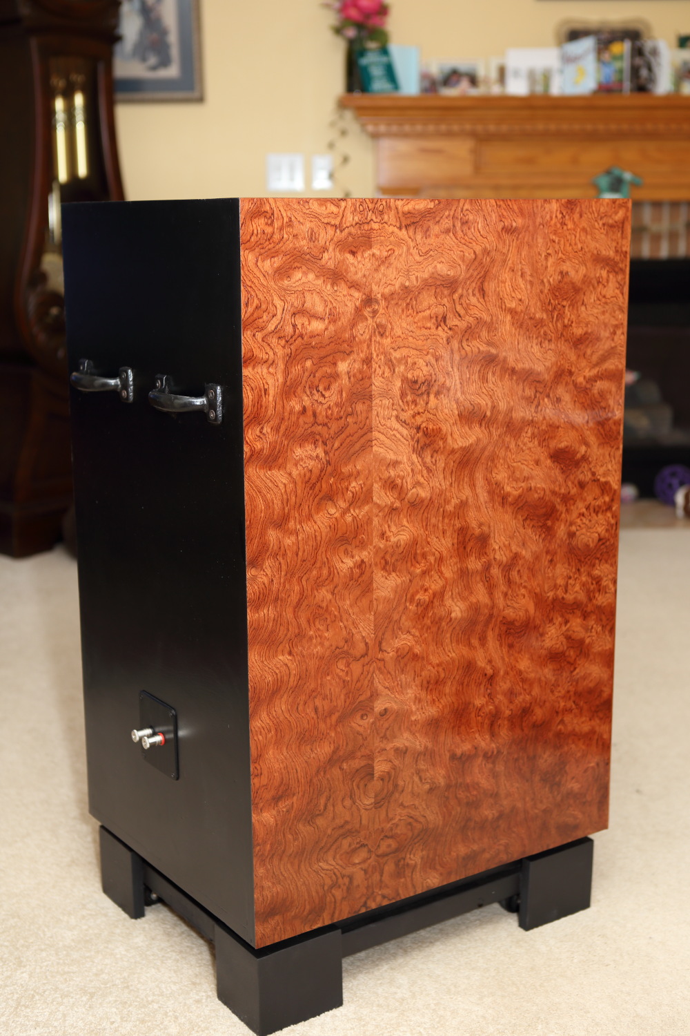

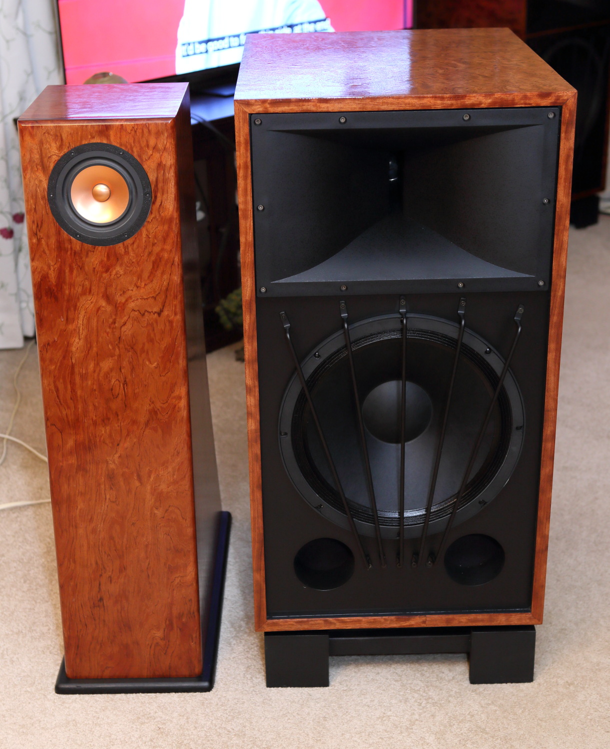

Here is one shot of the size comparison between my FHXL speaker on the left and the Calpamos on the right. It takes up more room, but doesn't eat up any more living space than the FHXL does. While the FHXL has a 24" deep footprint (same as the Calpamos) it also tapers toward the top, so it looks much smaller from the side. Probably not 100% ideal placement for either speaker, but the new one fits where I intended it to fit without having to rearrange the furniture.
Looks great, that veneer is beautiful !

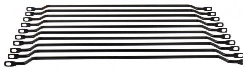

I see that you found protection grills for the woofer 🙂
Looking forward to hear your second WOW 🙂

Did you have any issues with the veneer rolling up or bubbling while the glue was drying? It never occurred to me to use wood glue for veneer. Great idea. I always use contact cement.

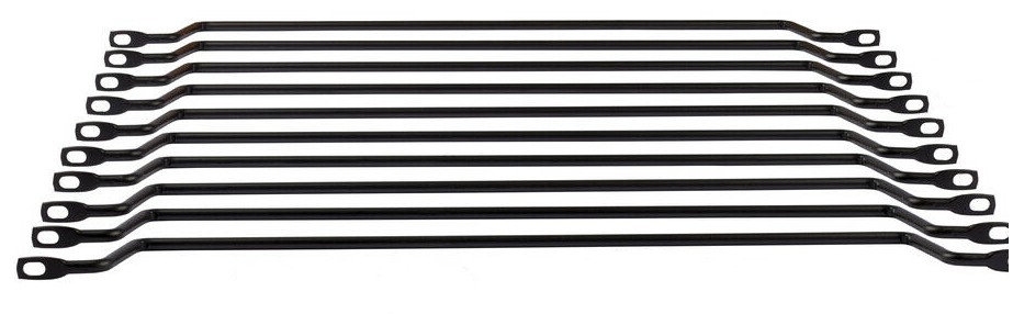

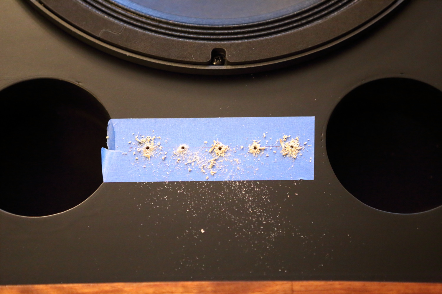

Here is what I used for a grille to protect the driver: Middle Atlantic LBP-1.5 Lacing Bars with 1.5" Offset for Standard 19" Racks 10 Pcs.. I arranged them so the are closer together at the bottom and fan out a little at the top. Paid only $25 for them on ebay.
Only had a single bubble pop up in the veneer, about the size of a $0.25 coin, near the back edge. Not sure why it happened, everything had plenty of glue…

In the event that the link above gets broken over the next few months, this is what I used for the woofer protection grille. It is a set of 10 lacing bars intended for cable strain relief for rack mounted computer equipment. The ones I used are made by Middle Atlantic, but there are a variety of manufacturers that make them. They come 10 to a pack, are 19" wide, and come with various "offsets" or depth of the bend in the bar. The ones I used have a 1.5" offset. This is enough to clear the woofer and still provide some additional protection space. Each woofer has five of them. I spaced them 1" apart from one another below the driver and about 3.5" apart across the top of the driver.

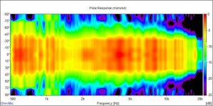

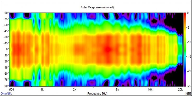

Anyone can take high quality measurements and visualise them as a polar for less than the price of a decent pair of woofers!
Measurements inside just need the appropriate windowing or gating to remove room reflections. REW is perfectly great for this.
See attached Jeff Bagbys white paper explaining how.
Here's my bedroom speakers ....
81425340_PolarMazLab.jpg.62dca93f1975032a84230f89a43b7879.jpg56.2 KB · Views: 576

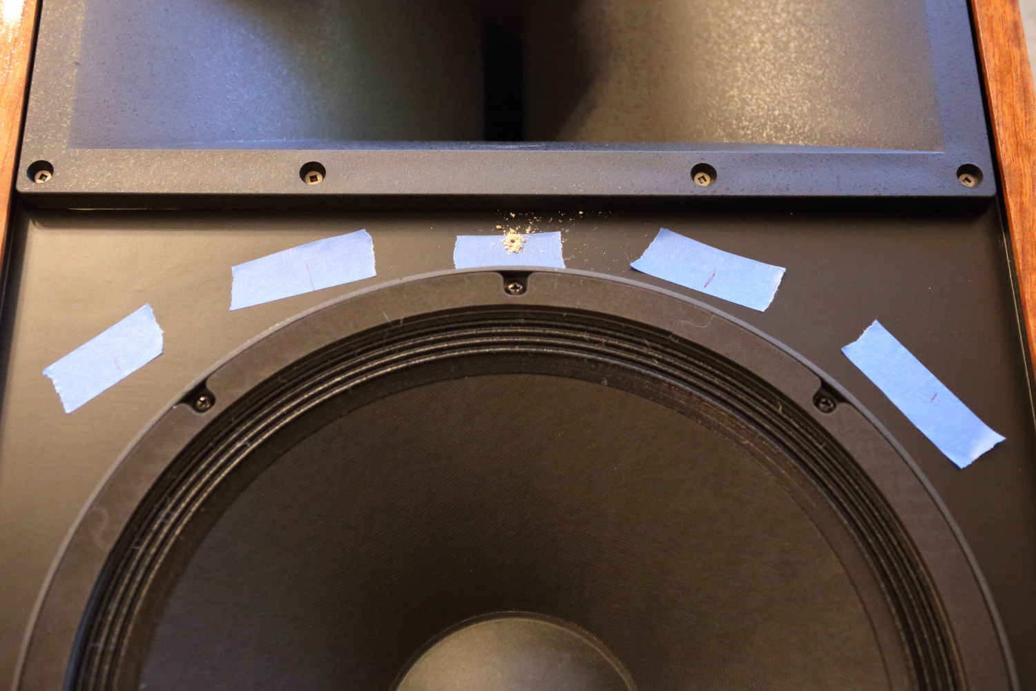

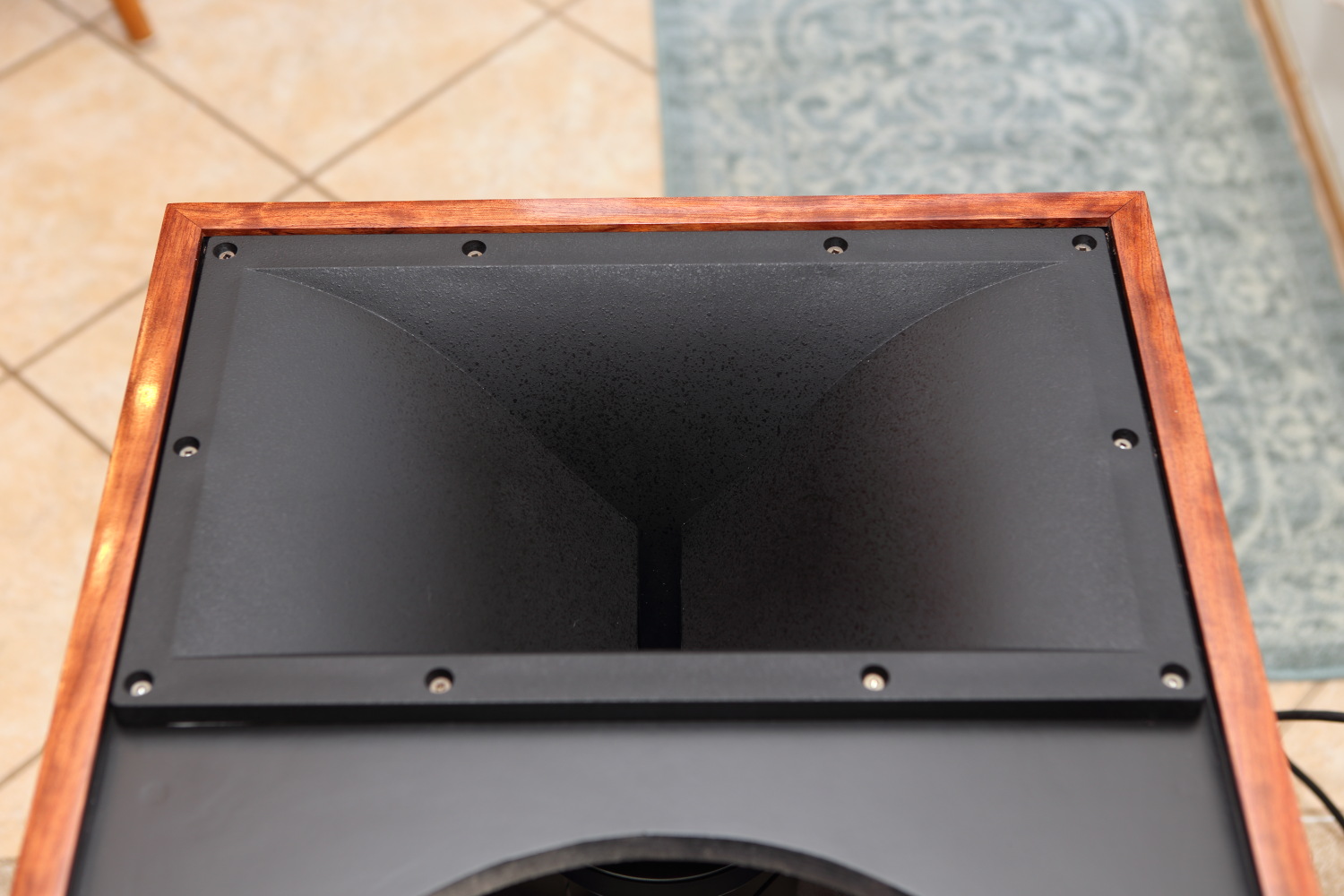

I'll eventually get around to making some measurements with REW, but it's going to take a little while as I have a bunch of weekend travel coming up.

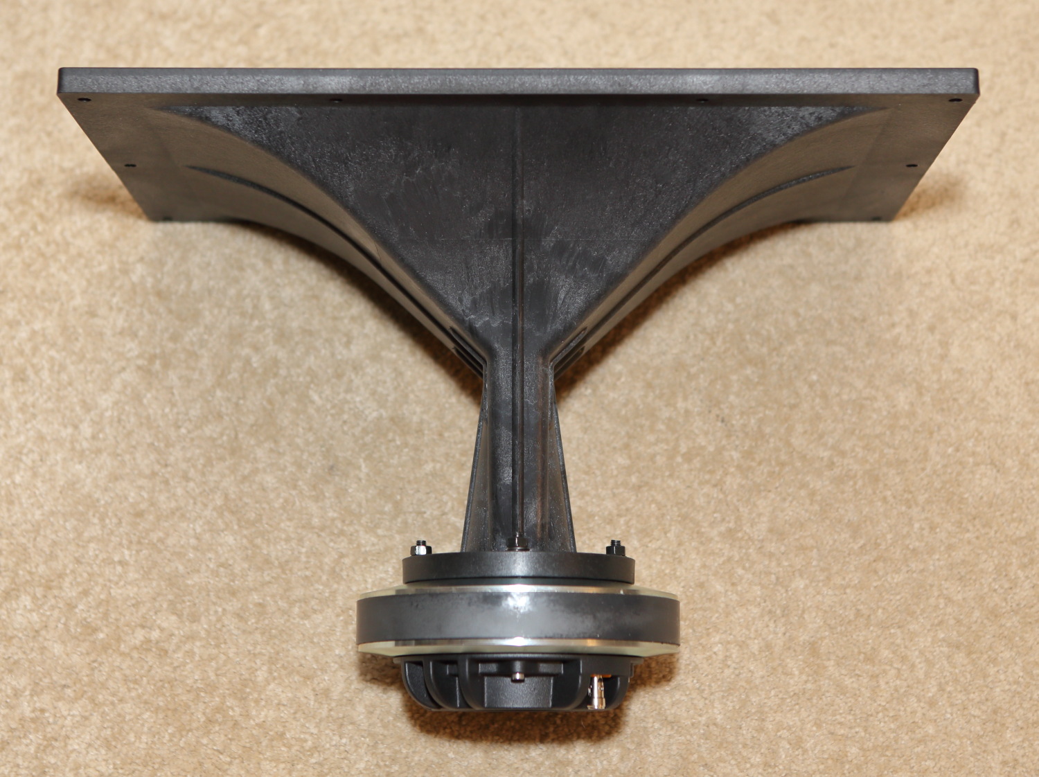

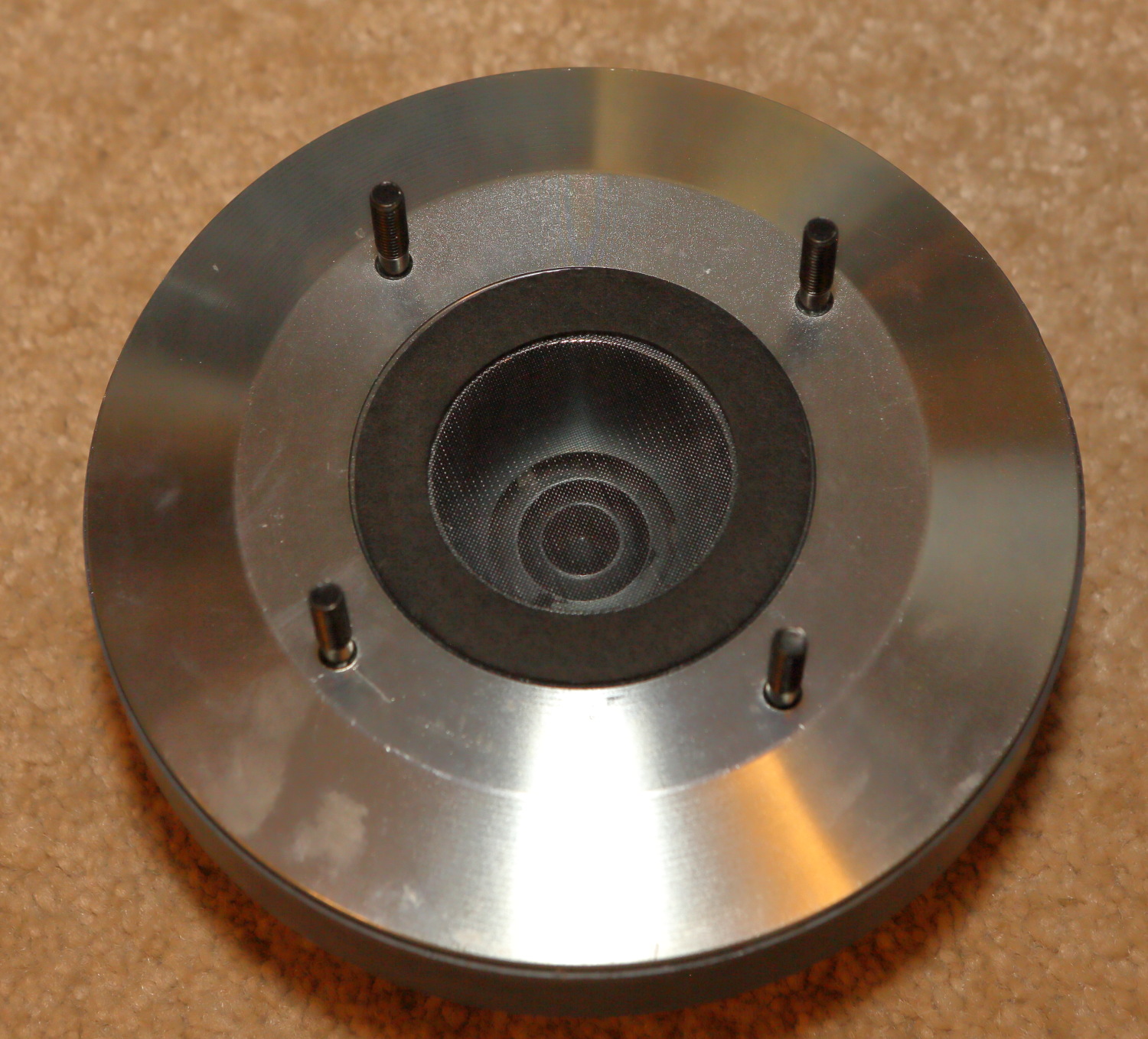

In the meantime, I have a few more images of the second speaker going together. I realized after I made these images that I forgot to add the small strip of hardwood under the tweeter horn that I put on the other speaker. Ooops...
These images are details of the tweeter installation, the bar grille to protect the woofer, the completed speaker, and a side-by-side of the FHXL and the Calpamos. The mounting lip of the horn and the woofer received some adhesive weather stripping before they were mounted to the cabinet.
From casual listening while spinning some CDs, the horns do what they are supposed to do - there is very little difference from sitting to standing and walking back and forth across the front of the speakers.
