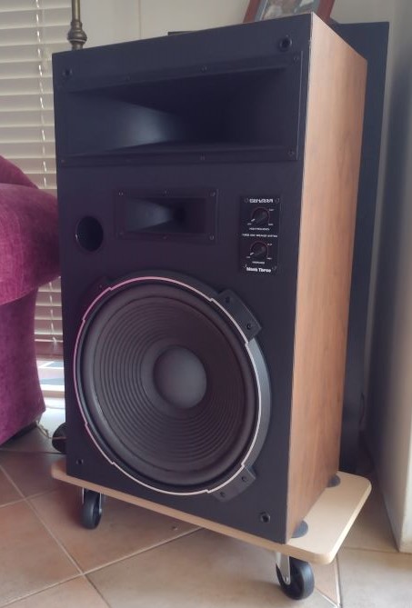

Great video, Mazza! Thanks for posting it. I have a little bit of room to play with, but not very much. The good news is that I already have each speaker on a dolly - I'd never get them into position otherwise at 150 lbs each. I can pull them out when no one else is around, and push them back into their original position otherwise.
I used the tape on the floor arrangement when I was positioning my open baffle speakers in my theater. It's a great way to experiment in a way that becomes repeatable.
