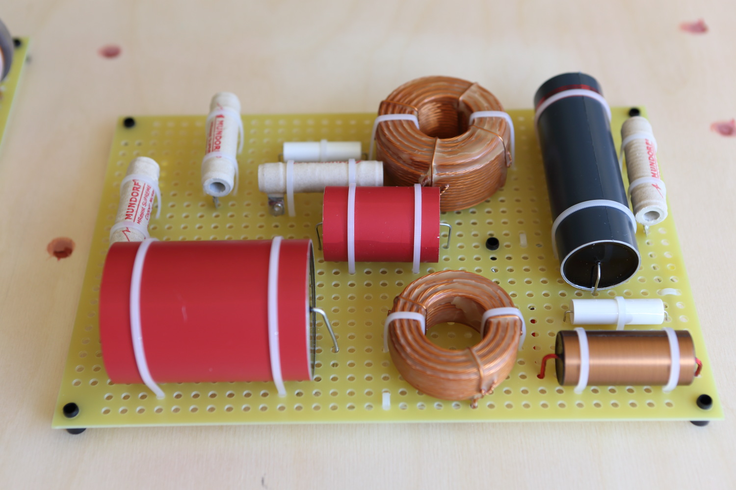

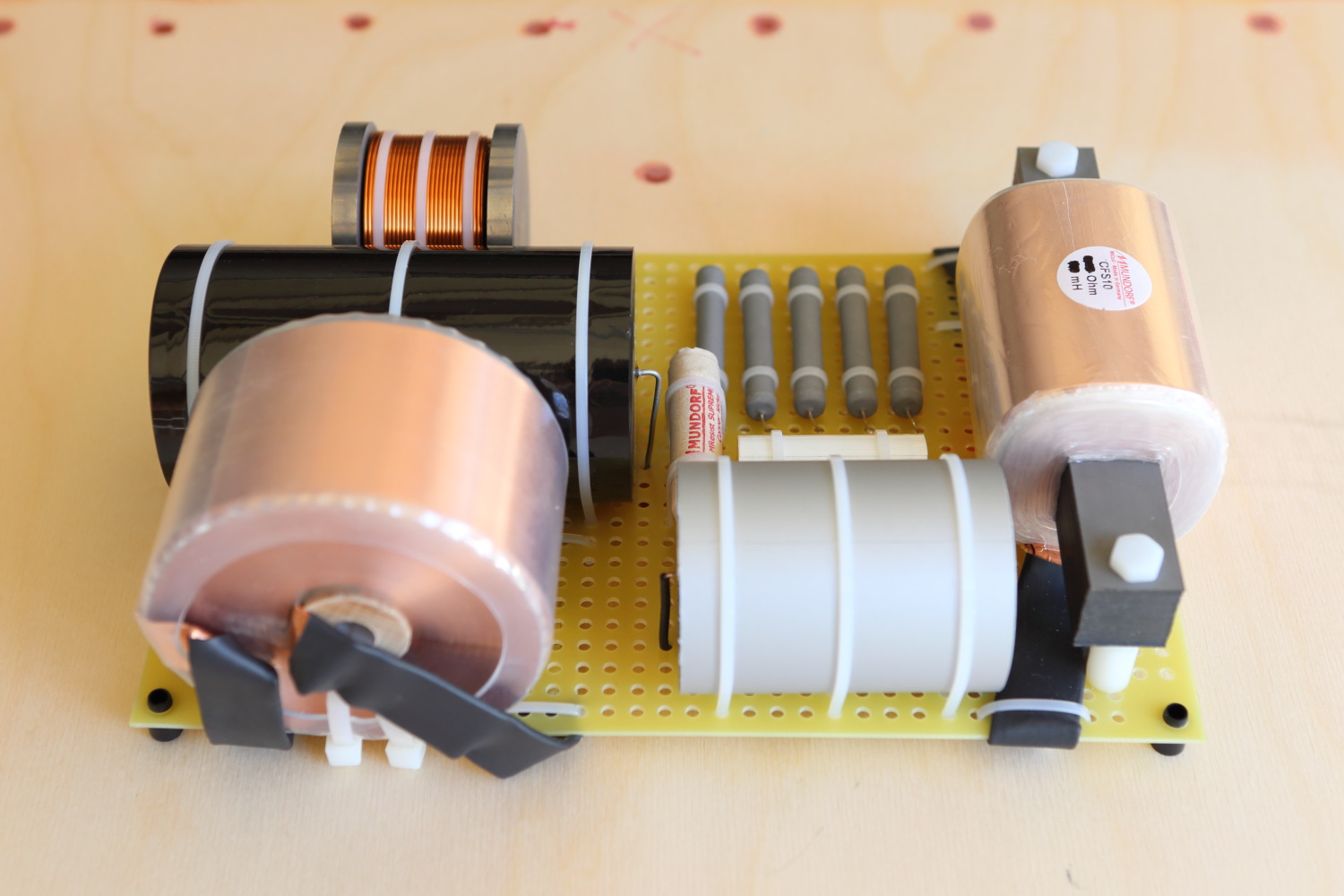

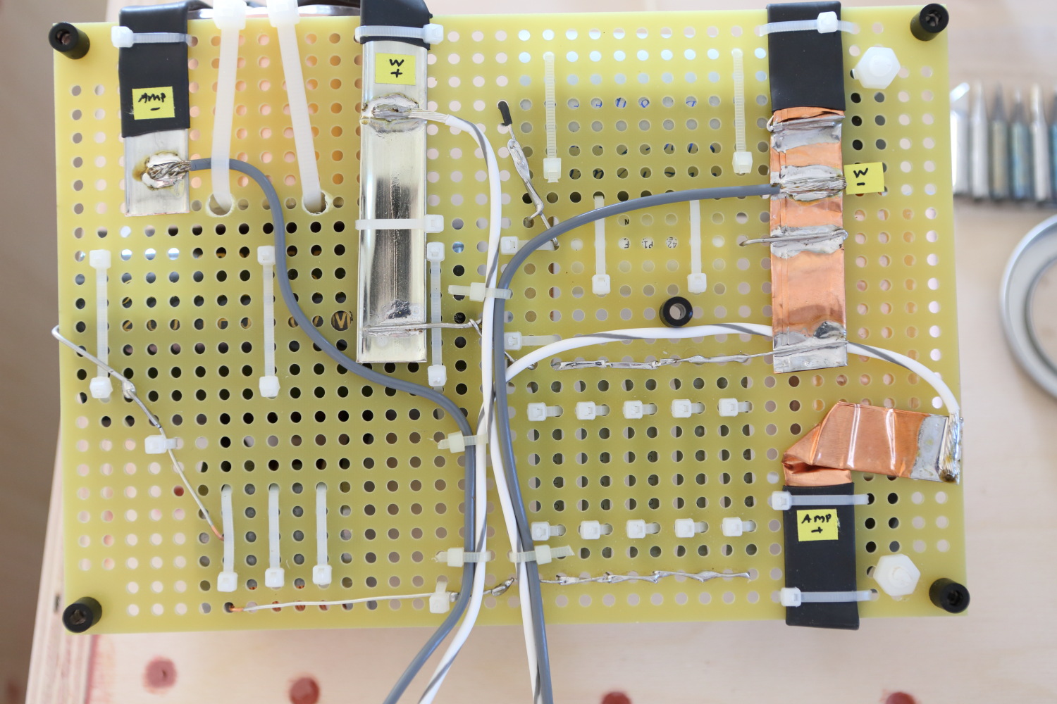

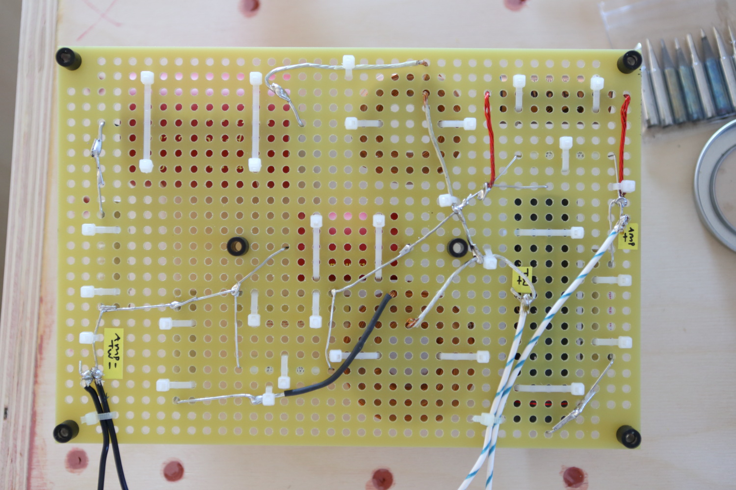

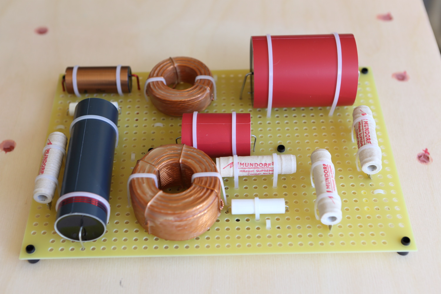

Somehow I recognized this problem very early on in my head and came up with a good way to mount the crossovers. Toni mounts spacer sleeves on the breadboards, but the circuit boards also sag considerably from the weight of the large coils. I also didn't really like the way Toni's crossovers were mounted in the Calpamos. After making small changes to the crossovers (positioning of components), I will use additional spacer sleeves in the middle of the circuit boards. I will install a mounting plate in the housing on which the crossovers will be mounted.Found it! The crossover is mounted on top of the dampening material. The dampening material has a heavy sheet of tin foil on the top that is coated with paint. The solder joints on the bottom of the crossover are poking through the paint and shorting on the foil, thus “removing” a few components from the crossover circuit.
With the crossover mounted in the cabinet, pressing down in a particular location created the problem. With the crossover removed from the cabinet, I am unable to duplicate the problem. I’ll add a layer of cardboard or thin plywood under the crossovers in both cabinets.
Problem solved!
When I rearranged a few components on the crossovers, I found a Mundorf resistor with a small flaw. They don't like being tightened too tightly with cable ties. I then checked the resistor and it was completely fine. It just looks worse than it is.I've examined the crossover and all that I can find with close visual inspection is this resistor leg that looks like the copper has corroded to some extent. I'll reflow all of the solder joints anyhow.
Does anyone have any commentary of the appearance of this leg of the resistor?
Pass DIY Addict
Joined 2000
Those are heavy crossovers for sure! My solution was to add a layer of corrugated cardboard under the crossover board as an additional physical barrier to keep the components from shorting. I haven't had any more issues with them since. Still REALLY enjoy these speakers!

To be fair to Tony, the parts quality of his crossovers is clearly top shelf. The coils include 8g and 10g from Mundorf and Jantzen in order to achieve low resistance. Some of the caps are silver caps and resistors are high power Mundorf. Then, he assembles and tests them before they ship. Completed, they weigh close to 30 lbs in total, so shipping across the ocean is a bit expensive as well.
