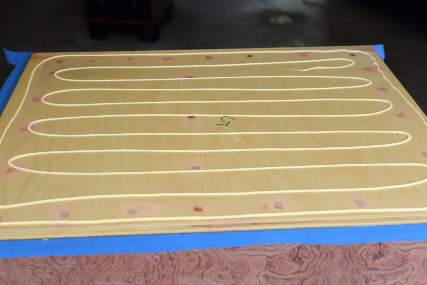

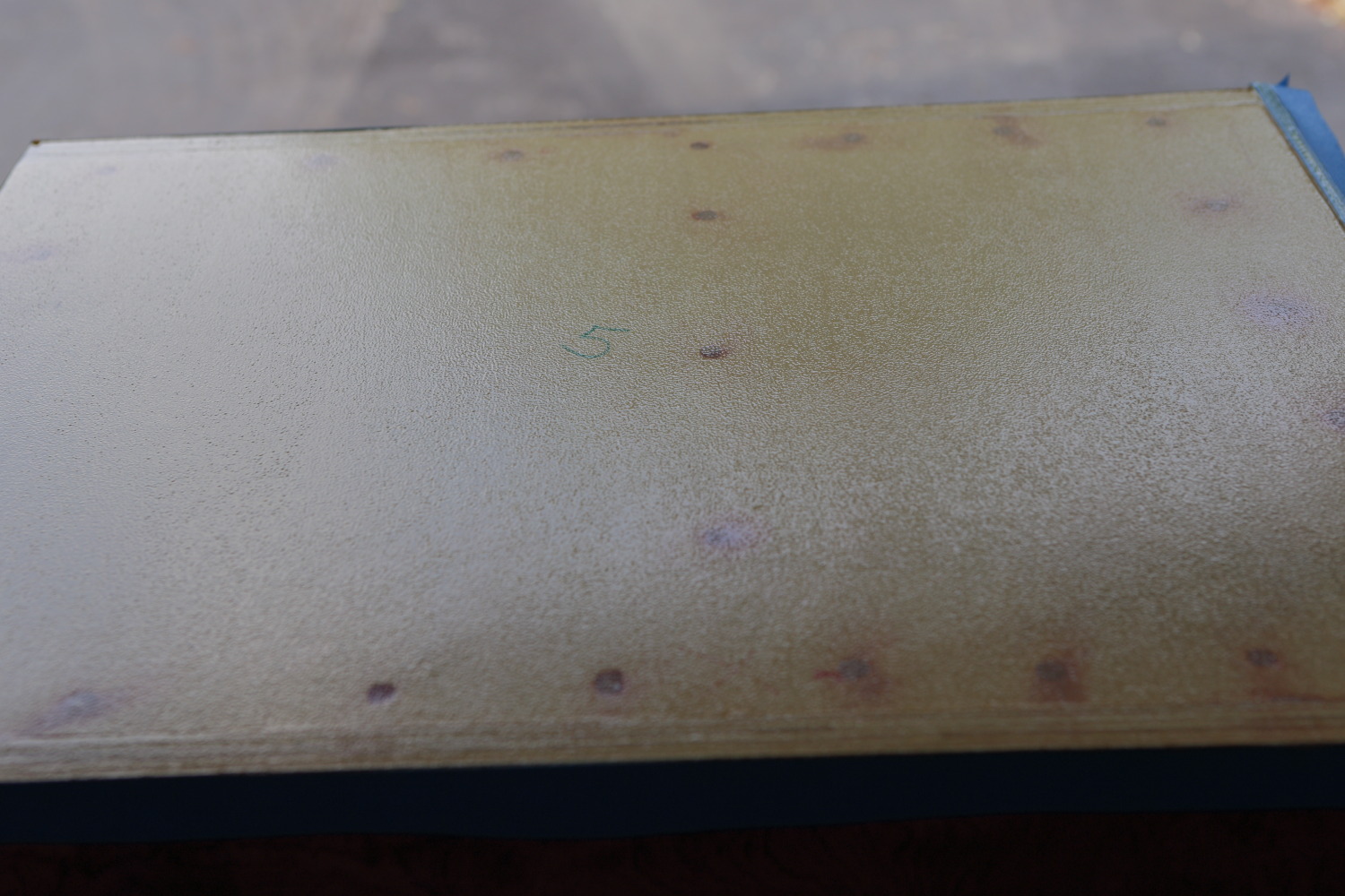

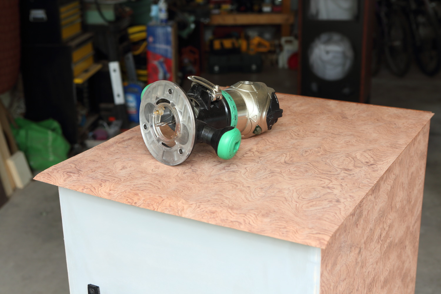

I finished up the veneer work today, finished painting the back of the cabinets, and put the first coat of oil on the veneer.

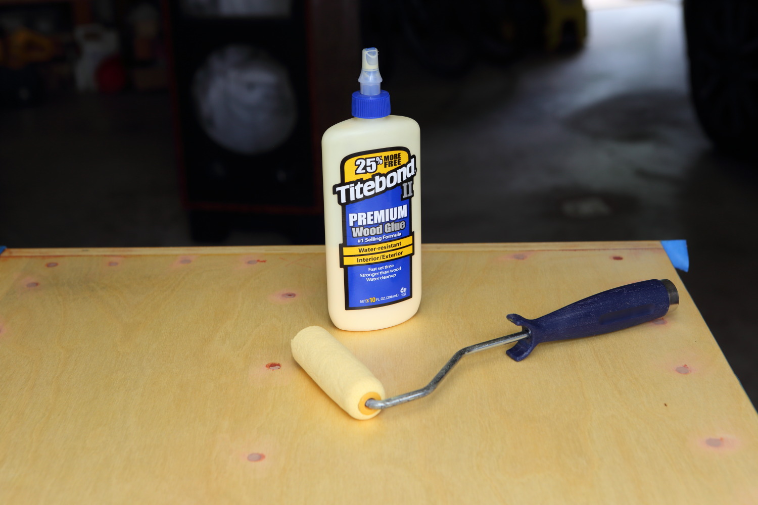

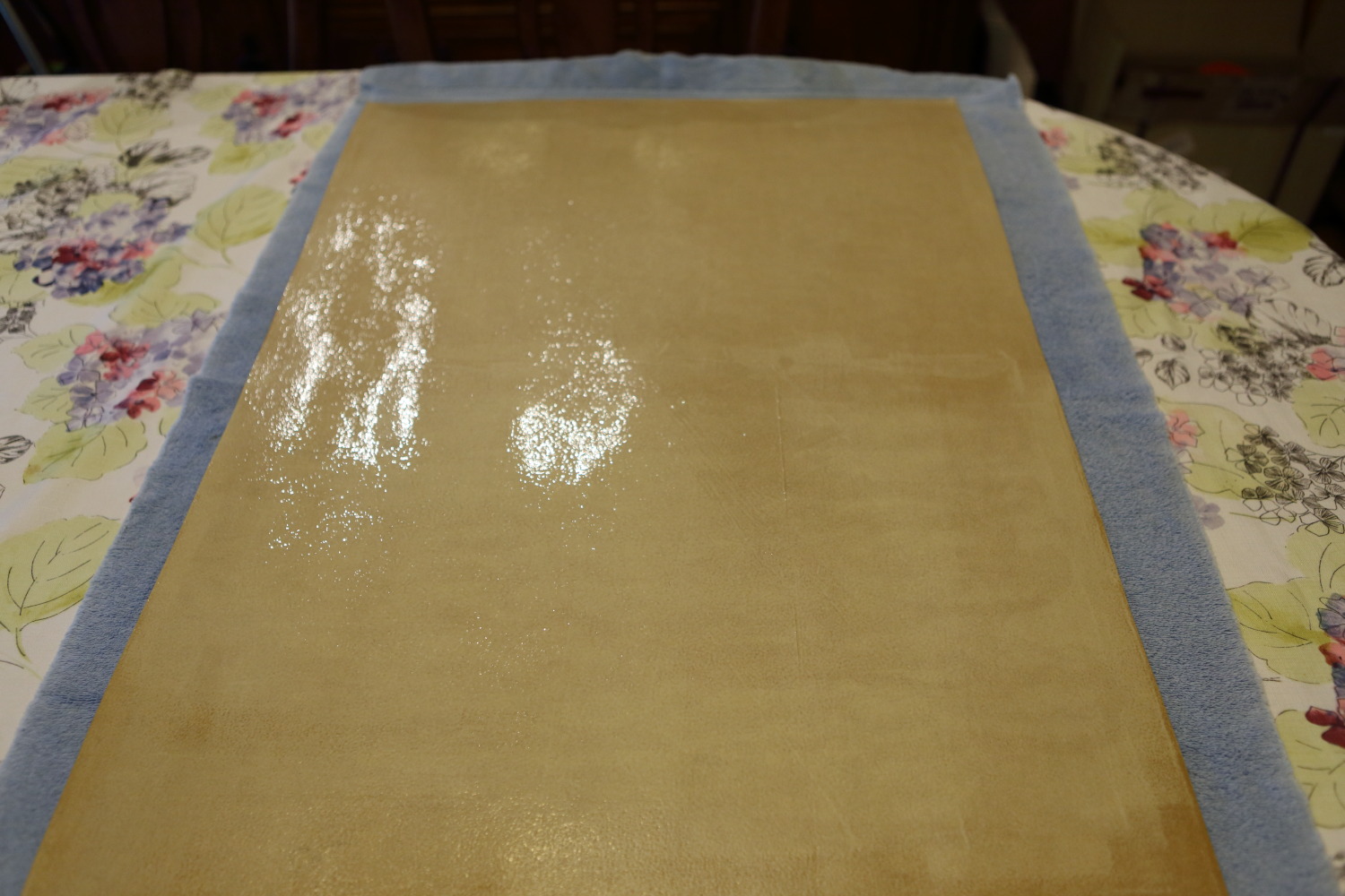

The veneer got one fairly heavy coat of glue and the cabinet got two coats of glue, allowing it to thoroughly dry between coats. I taped up the edges of the panel, laid down some glue, and then rolled it out with a 1" foam brush until the whole surface had a nice eggshell texture to it. After everything was dry, the sheet of veneer for the cabinet top was ironed down. For some reason, one or two spots around the edge didn't stick this time, so I diluted a little bit of glue with a drop of water and used a syringe to get it under the veneer and hit it with the iron again.
Next up, the rear of the cabinets got a few more coats of primer, followed by a gentle sanding, several coats of flat black paint, sanding before the last coat, and finally 4 or 5 coats of matte finish clear paint, again sanded before the last coat.

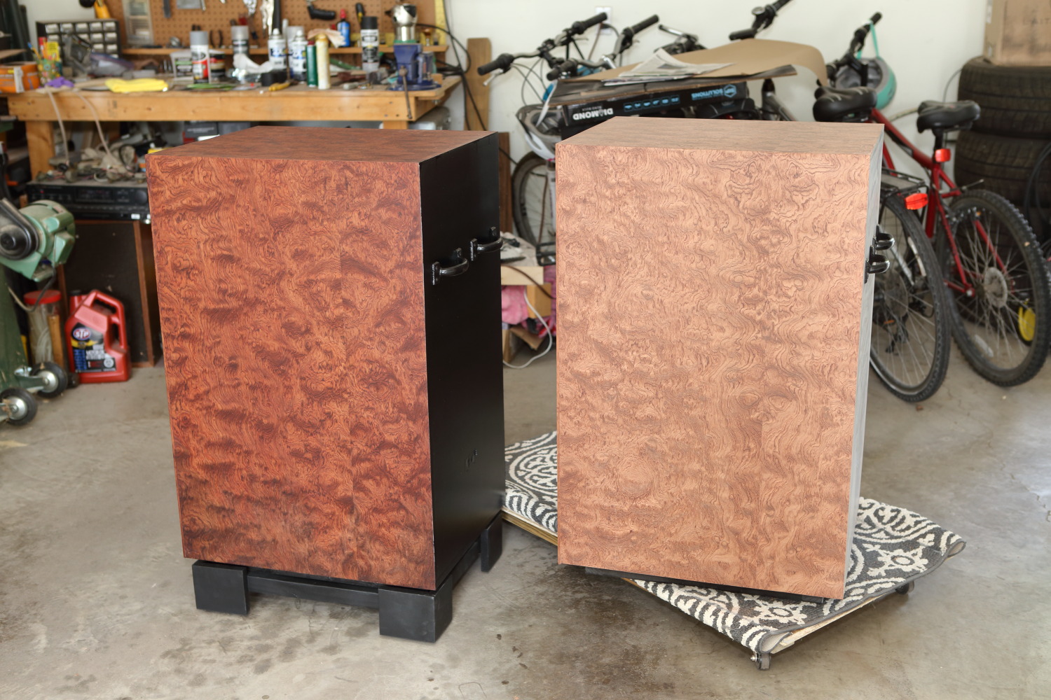

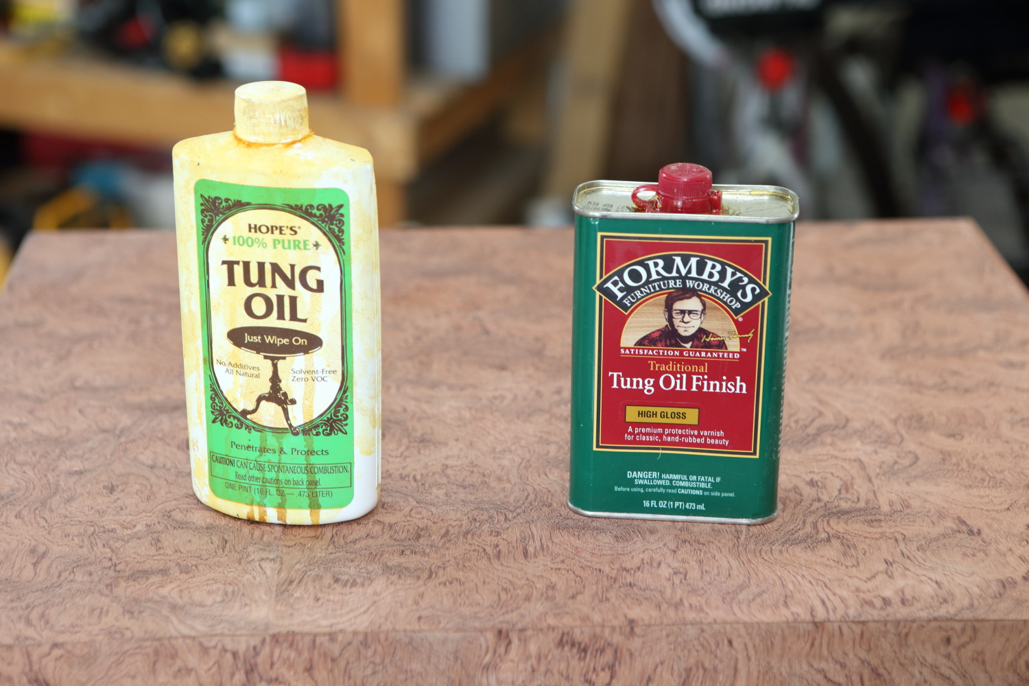

My goal is to make these match the center speaker that I already have, so I sanded the veneer with 120 and 220 grit paper and spread a coat of pure tung oil. Here is an image of one cabinet that has been oiled and one that hasn't so you can see the difference. The pure tung oil adds a bit of contrast to the grain. It doesn't really "dry" but after a few days it soaks in enough that it can be top coated with some Formby's Tung Oil Finish.
Ironically, I don't think the Formby's actually has any tung oil in it at all 😕 It builds up layer by layer and after 3-4 applications the grain gets sealed off and it starts to build a nice shine. For the final finish, I prefer the "low gloss" variety of Formby's, so I use the "high gloss" to build up the first few layers and seal off all of the pores, then I switch to the low gloss and add the final 1 or 2 top coats.

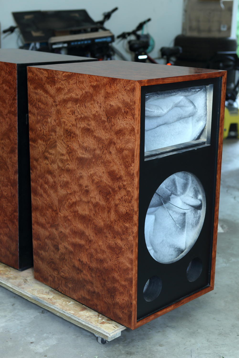

Hey Zman! One speaker needs two more top coats of finish, then I can install the drivers. It will need another few days to finish outgassing before they are allowed in the house. The second cabinet needs one more day of sanding, then the top coats will start. Maybe a week to a week and a half… Can’t wait to hear them!

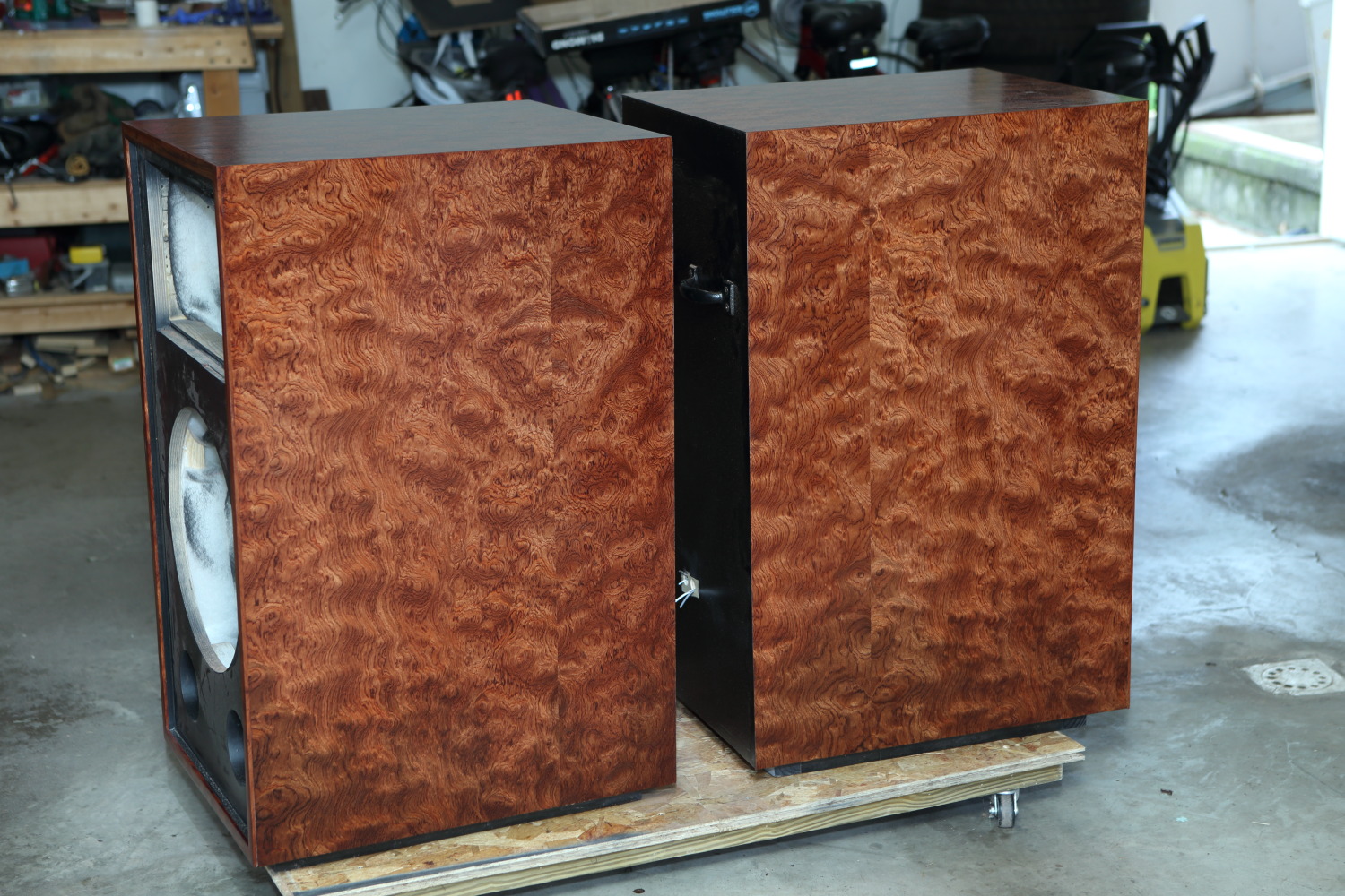

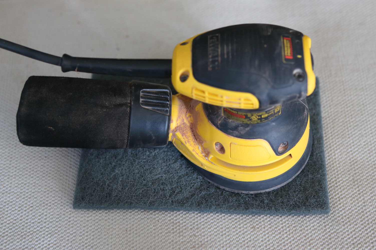

I'm still working on the finish and I came up with a new (at least to me) trick that I thought I would pass along. I'm using the Formby's Tung Oil Finish now to build up the coats of the final finish. The first coat or two tend to raise the grain a little as it soaks in, especially with the figured veneer. Also, some parts of the veneer suck up more than others, so the first few coats tend to be rather uneven when dry. I've tried a gentle sanding with fine grit sand paper, but that doesn't work so well as the paper quickly becomes clogged. So, I switched to using small pieces of abrasive "gray pad" to even out the finish. This works well, but is very labor intensive.
After working for nearly an hour and a half in the awful 95% humidity this morning to smooth out the finish by hand, I had a new idea that worked out GREAT! I stuck the 6in by 9in "gray pad" onto the bottom of my palm sander. The gray pad is a non-woven pad that is roughly equivalent to 600 grit sand paper and is about 1/4" thick. Because it is highly porous, it doesn't cause any problem with the air flow through the base of the sander and it sticks nicely to the velcro base of the sander.
This turned 90 minutes of work by hand into about 5 minutes of work with the palm sander. The resulting finish was smooth and even. A few minutes later, the cabinets were ready for another top coat. Now that the surface is nice and smooth, I'll add a few more top coats, repeat the sanding with a "white pad" (less abrasive than the gray pad), and then add a final top coat.

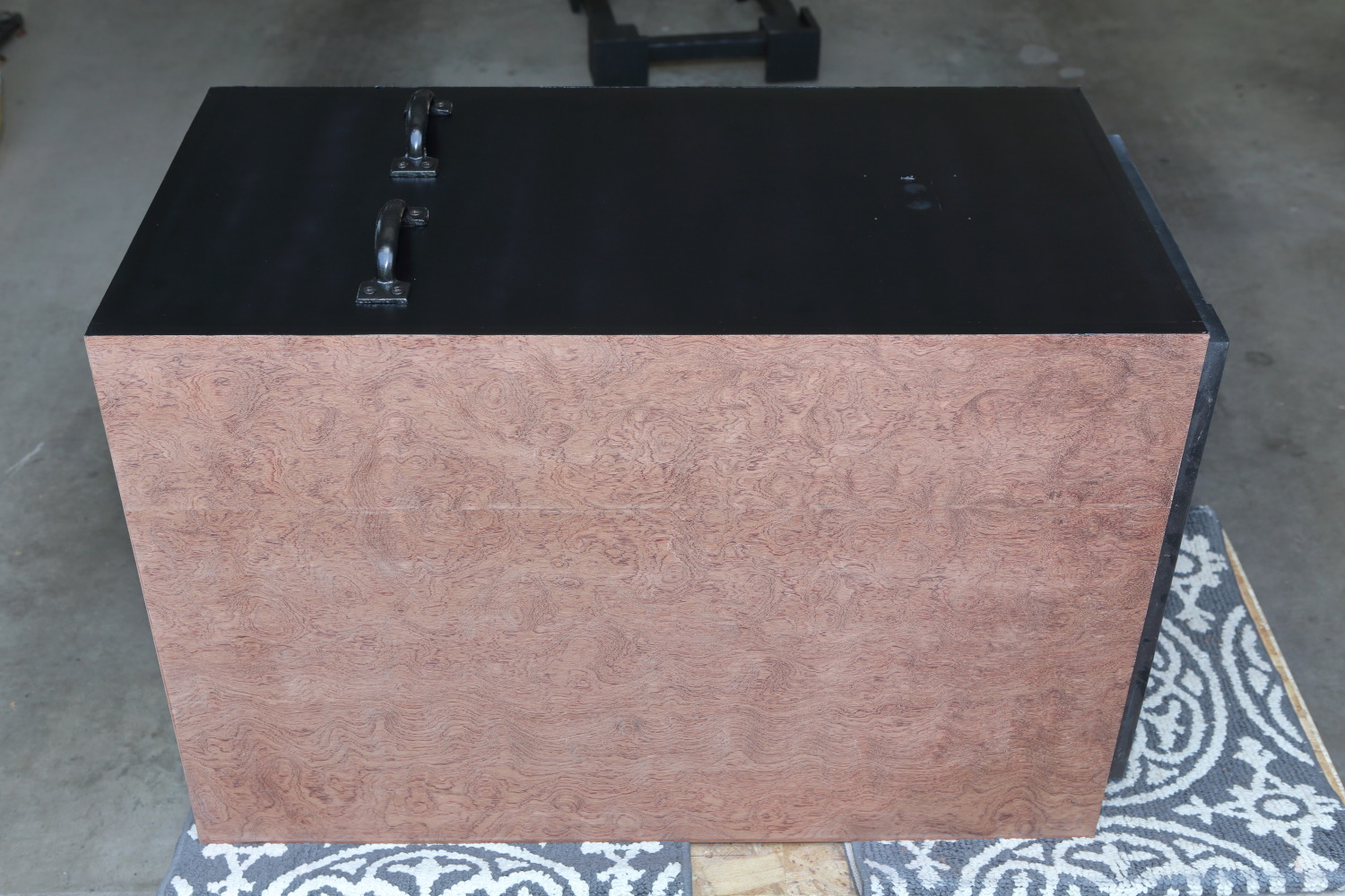

I managed to get the color/contrast to match much better after a great deal of work on one of the cabinets. Ironically, all of that work seemed to have the added benefit of acting like a grain filler for the pores in the veneer.
Still in need of more coats of finishing oil, but coming closer. One coat every 24 hours is just pure torture 😀

The veneer and finish is looking really good. I am sure the cabinets will look gorgeous after you've done the full job!
The hard work and the patience are yielding good results. 🙂
