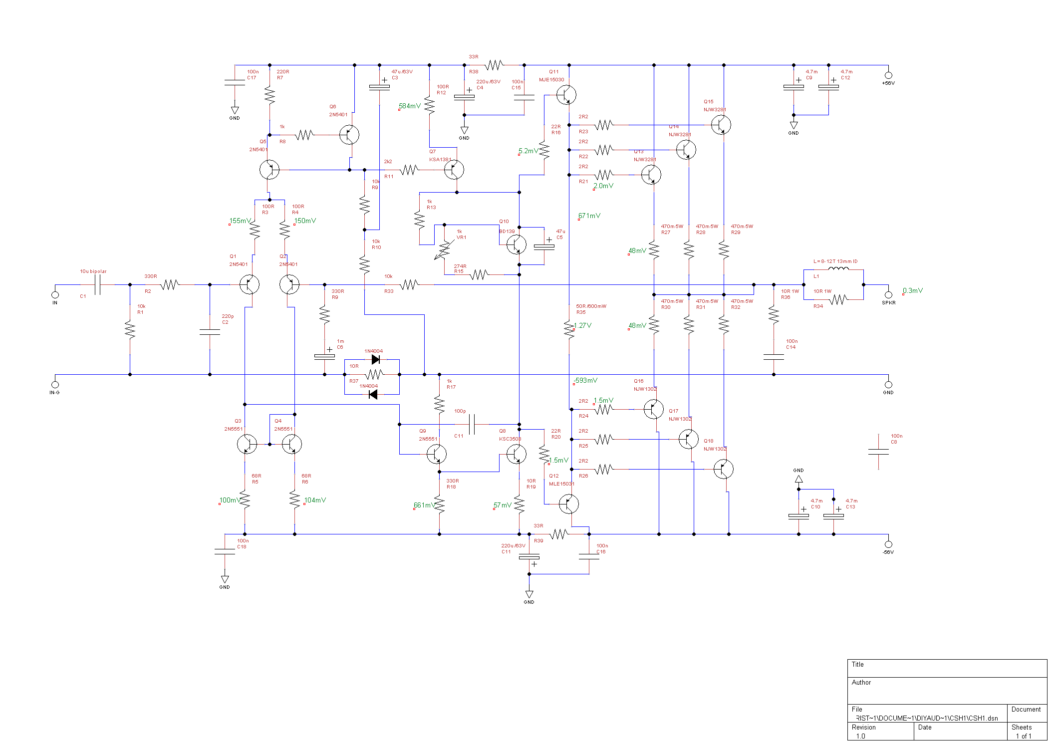

Over the past week I've assembled a second card, this time using 3 pairs of MLL4302/4281 outputs on 56V rails. The Vdrop across the driver base resistors is around the same at 0.9mV and 2.8mV. Halving R35 increased the Vdrop as expected however proportionally similar at approx 1.5mV and 5.8mV.
So I'm at a loss now... both amp modules sound great and the DC offset at the output speaker terminal is very low.
=AndrewT;3880196]Vr18 is typed wrong.
I can see the imbalance in the output stages and in the LTP.
I suggest two changes.
1.)
Increase the driver current massively. Try doubling by paralleling another 100r across R35. This will make the drivers faster and may require a small change to the existing compensation. If that works and the drivers are still cool enough, then try adding a third 100r for a tripling of driver current.
Note that the output devices are also showing a big difference in hFE. The sinking and sourcing into the driver circuit is not equal.
2.)
Add a trimming resistor across R6. Try 1k0 and remeasure the difference in LTP collector voltages. Estimate what trimmer value will give an exact balance of the LTP emitter currents.
The reason for the imbalance is that Q9 is not sinking the same current as the Q4 cb link and not selecting Q1, 2, 3, 4 for equal Vbe and nearly equal hFE at the operational current and temperature.
Finally,
Check that all the Grounds are connected to the ground trace to the right hand side of the R37 network. No exception, I mean ALL grounds.[/QUOTE]

I was hoping that the imbalance in driver hFE was mainly due to low driver Ic.
But your higher Ic is proving that the hFE is still imbalanced.
The effect this is having is that the upper driver is sinking much more current from the CCS/VAS string than the lower driver is sourcing.
This leads to a drop in VAS current even though the CCS is sourcing a constant current.
As the driver Ic increases, this sinking/sourcing imbalance will get worse. It could reach the point that the VAS is starved of current when high output currents are demanded by the speaker.
Can you remeasure Vr18 to see how close the VAS current is to the 5.53mA passing through the CCS? It should be ~ 5.33mA
Can you measure all the output emitter resistor and base stopper resistor Vdrops.

That indicates that VAS Ie is down to 2.06mA !Hello AndrewT
Vdrop across R18 is 680mV.
Is the post78 pic still wrong?
Where has all the 5.53mA gone?
Your stated measurements show just 0.2mA of imbalance in the sinking and sourcing to the drivers.
Attached is the voltage overlay with this new board with 3pr outputs on 56V rails and 50R between the driver emitters. R18 dissipation is extremely high!

R18 dissipation is 0.661^2 / 330 ~ 0.0013W = 1.3mW
Did you really mean R18?
Driver dissipation ~ 1.57W. If it stays cool with the existing flashing sink, then leave it as is.
If it is too warm, increase the sink dissipation.
If you opt to increase the driver bias current to >=50mA, then move them to the main sink.
The output bias voltage has been increased, Vre=48mV.
R10 current now 5.7mA
R12 current now 5.84mA
base current difference to drivers = 0.17mA
CCS current - base current diff = 5.67
The "lost" current is now down below measurement tolerances.
The gain of the outputs is part of the cause of the unbalanced driver base currents.
If the upper drivers and the upper outputs both have a lower hFE then the current the driver sinks from the CCS will be higher than what the lower Driver puts back in.
In the extreme this can starve the VAS transistor, which is designed as a constant current amplifier.
5% and maybe even 10% difference in hFE is tolerable, but it looks like some of your devices have an hFE that is more than 100% greater than complements that supposedly "nearly match".

Apologies for not having taken my own advice and read all recent posts more carefully.Hi Ian..This is not simulation, I've built and measured two boards!...
A couple of things come to mind and they have been mentioned already. The resistances around the VAS are unusually small but current low - something is amiss here. I would be looking to establish 6-12 mA bias in the VAS. You have 5.7 which is OK but the current should be gushing here with Re of only 10R.
R18 should not be getting hot, your voltage drop gives 2 mA, much as Andrew T replied. What is going on with measurements if it is hot? Is it really 330R? Are R17, Q9 functional?

Specifically the value for R18 may be too small, as AJT draws attention to it too. Some advice given early in the thread wasn't true of Self's blameless designs, at least. I think your first estimate was closer to the appropriate figure for biasing Q9 . Simulate first, I haven't estimated any particular VAS bias current increase.

Here you go...at my age I can't read the one posted above in post88!
- My Blameless
