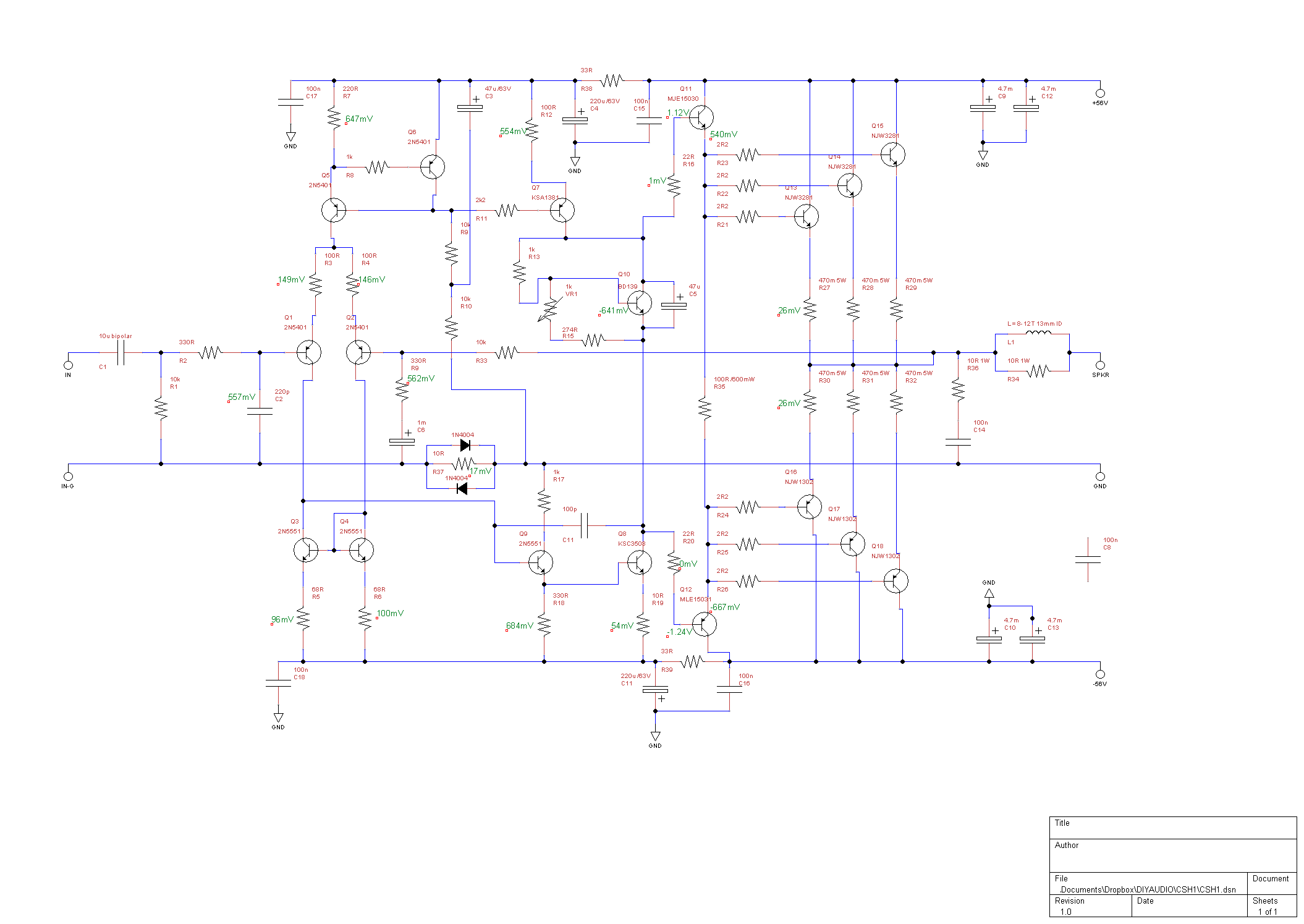

I believe there is a problem with my Vbe resistor values as the driver bases are unbalanced and increase/decrease as a function of the trimpot value.

Andrew, updated schematic attached.
The Vbe base voltage doesn't seem right to me. Can you give me a clue? I have a feeling you know the answer. Is there insufficient current through the VAS current source, or perhaps R13 needs to be reduced?

i think that by the looks of it you have a circuit that is good to go,
i do not see any major major problem should you decide to go ahead and build it..
I've already built a low-voltage prototype (1pr outputs, 35V rails) using a spare DX Blame MkIII board I have lying around.
I plugged in a speaker and hit the play button on my MP3 player. It plays music and sounds quite good 😀
I'd like to figure out why the output offset (perhaps bad matching of drivers or output transistors?) and then add another two output pairs and crank the rails up to 56V 🙂

Don't worry about small <10mV output offsets until the driver imbalance has been solved.
The updated sch voltages still show 0mV and 1mV for the driver stopper voltage drops.
These are not acceptable.
I agree, the ~80mV offset at the speaker out is concerning me more than the ~4mV offset at the LTP.
But how do I get more current through the drivers?
I will report back with the voltage drop across the driver emitter resistor, R35.
