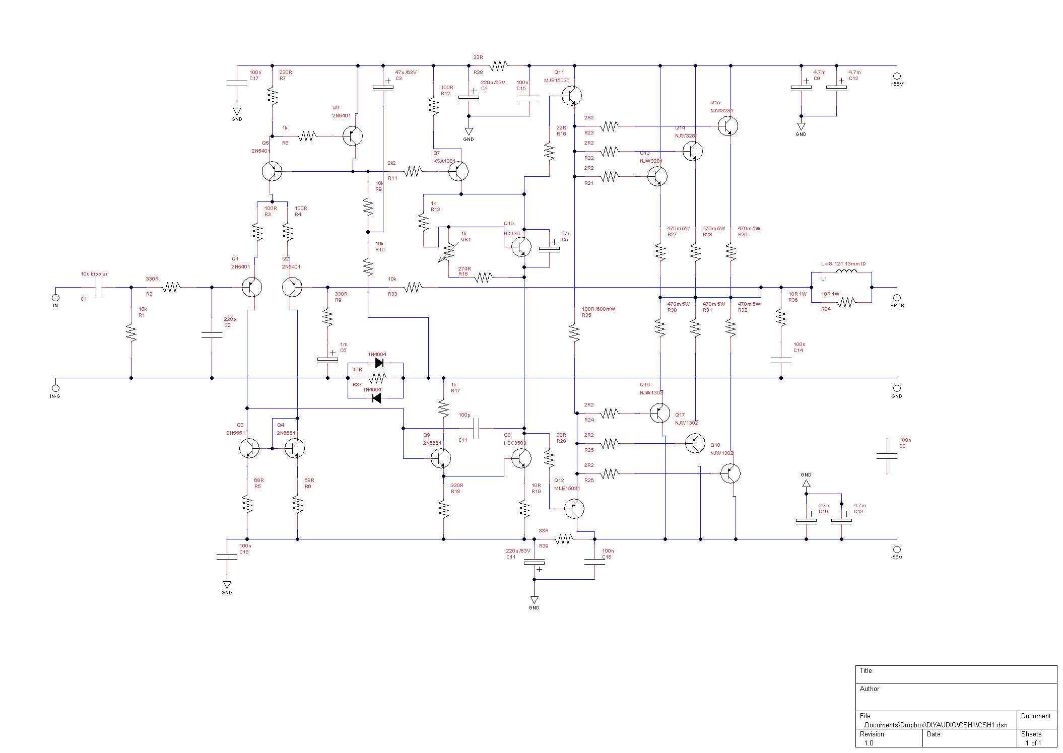

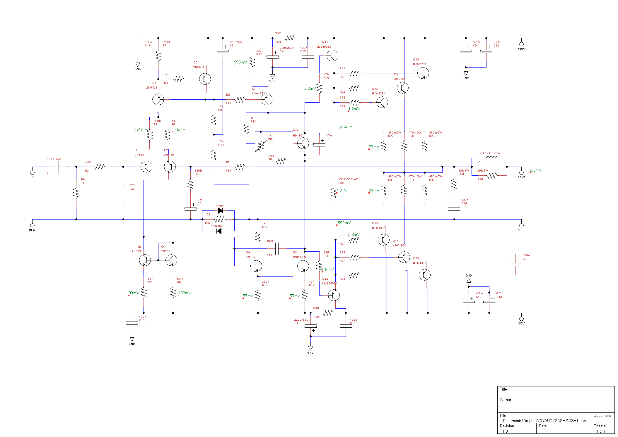

Could you now post your final schematic and add on the test measurement voltages for all to see.

seriously, if you want more current thru the drivers, decrease R35 from 100 ohms to say 56 ohms....

Last night before I went to bed I measured the Vdrop across the driver base stoppers. I'm still using a low voltage supply / 35VDC rails for testing.
NPN = ~2.2mV
PNP = ~1mV
Concerned about the huge imbalance between these complimentary pairs, I grabbed some MJE15030/31 samples from my parts bin and measured the gain. The NPN devices have a fairly tight gain distribution as do the PNP parts. But the difference between PNP and NPN parts is huge - I can hardly believe these are marketed as complimentary pairs! I think it would be virtually impossible to find a MJE15030 and MJE15031 that match within 10%
Thinking that I may have bad batch of MJE15030 or MJE15031 devices I did the same testing with some MJE15032 and MJE15033 and found the same with these.
Driver emitter resistor:
I've studied several Linn/Blameless circuits and this resistor is usually in the range 100R to 220R, with 150R and 180R as common values. I can't recall any with <100R in this position.
So I'm not against the idea of reducing this value on my circuit but curious why others haven't done this?

Carlos' schematic has a 220n cap across this resistor - but since I wasn't sure of its purpose I left it out of my schematic. Is there any way to calculate this cap or is the value based on empirical evidence?

Vr18 is typed wrong.
I can see the imbalance in the output stages and in the LTP.
I suggest two changes.
1.)
Increase the driver current massively. Try doubling by paralleling another 100r across R35. This will make the drivers faster and may require a small change to the existing compensation. If that works and the drivers are still cool enough, then try adding a third 100r for a tripling of driver current.
Note that the output devices are also showing a big difference in hFE. The sinking and sourcing into the driver circuit is not equal.
2.)
Add a trimming resistor across R6. Try 1k0 and remeasure the difference in LTP collector voltages. Estimate what trimmer value will give an exact balance of the LTP emitter currents.
The reason for the imbalance is that Q9 is not sinking the same current as the Q4 cb link and not selecting Q1, 2, 3, 4 for equal Vbe and nearly equal hFE at the operational current and temperature.
Finally,
Check that all the Grounds are connected to the ground trace to the right hand side of the R37 network. No exception, I mean ALL grounds.

Ranchu32,
I would add a high value resistor (>100 kOhm) connected to ground ahead of C1 to avoid possible big bang in the loudspeaker if, when the amp is on, you connect its input to a source
It is not recommended to plug input connectors when the amp is on because of possible sudden charges or discharges of this capacitor.
My initial blameless had not such a discharging resistor and I once blow up the output stage of one channel for this reason. It's the only failure which ever happened with it.
