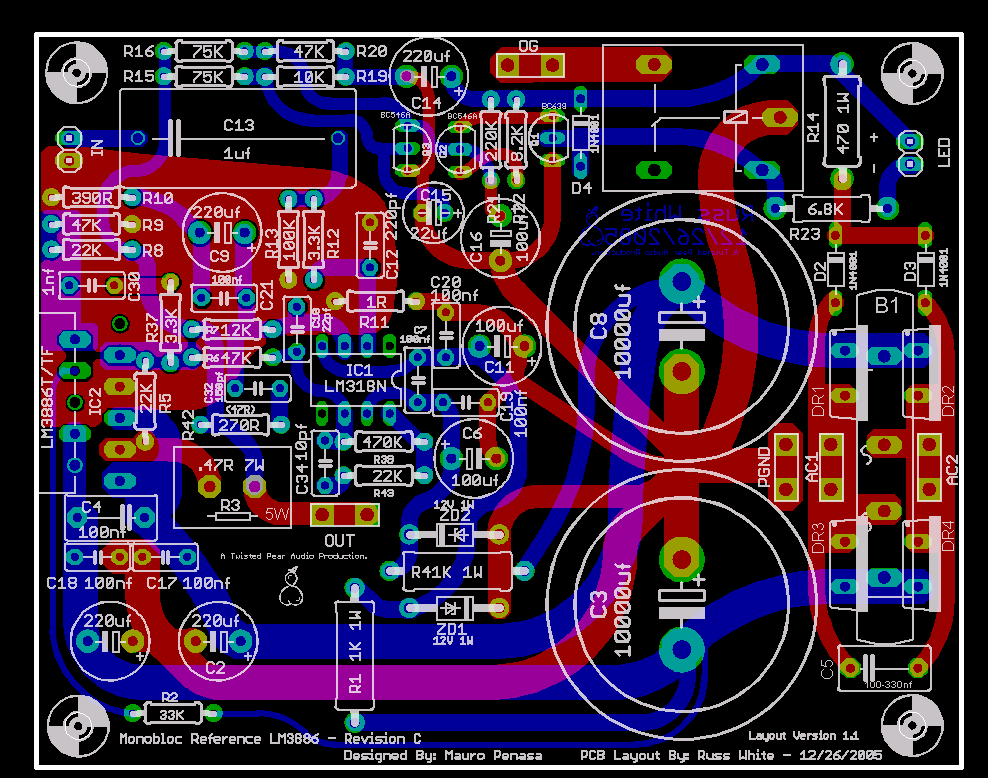

rabstg said:
AC1 and AC2 appear to be hole through joining different top and bottom traces.
Or am I missing something?
I am NOT critiquing, merely stating...
You are correct, just one of those those things that needed finishing. 🙂 Thanks for pointing that out. 🙂

Originally posted by Russ White [/ C version 1.1 based on new input from Mauro which has led to a few small tweaks for the PS (discrete rectifier diodes) and the input cap.
If there is interest I will share it.
Cheers and happy new year!
Russ [/B]
Russ,
Looking at this I see the discrete diodes, and it looks like the series input resistor is now 9.3K instead of 3.3K. Are there other changes that I have missed to this revised circuit?
Except for the diodes, I can make them to my still unstarted mono boards.
George
Panelhead said:
Russ,
George
Hmm the input resistor is still 3.3K, in fact the entire circuit is exactly the same (Revision C) except for the new input cap and the discrete rectifiers. 🙂
The layout is tweaked a lot though. I used a bunch of very cool trace calulators(thanks Mauro) to calulate trace heat, resistance, inductance, capacitance and RF frequencies, then I adjusted the PCB to get the values as close to optimal as I could right now. I am sure many could do better, but I am happy with it. 🙂
It is so easy to add an offboard recifier to this circuit that I did not bother to waste board space with double rectifers, as this qualifies as a ultra micro tweak. 🙂 Anybody who says they hear a major difference between single and dual rectifiers is probably one of those who also hears the sonic benefits of cable burn in. Frankly (though I don't wish to offend anyone) I just don't buy it. 😉 The change to a dual bridge PS is nothing earthshattering especially when PCB space is at a premium, which it is here. Yes, I have tried it, and no it did not impress me as any better at all, and it certainly would not warrant a change of the magnitude required to the layout. 🙂 But if you really want all those diodes, its easy enough to do. Just design a simple offboard PS and connect it with good wire to the amp PCB.
Most importantly I want the PCB to stay faithful to the schematic which Mauro designed. It is his amp. Those who want to can easily change all sorts of things even using this PCB. It is quite simple. The major changes to the PCB have originated from conversations with Mauro. I try not to project too much of my opinion onto his work. I try to let it speak for itelf, which it will, loud and clear. 😀
Cheers!
Russ

Russ White said:
Nordic, sounds like he has speakers which need much more power than MyRef can deliver.
This is a limitation of the LM3886 and the circuit, it would not matter which PCB,rectifier,PS, etc.. you used.
Russ, don't blame the LM3886 chip, because it can sound surprizingly good and drive speakers that you would never thought possible.
In this design there's a 0.47R resistor in series with the output, this does no favours.
Also, serious (and tight) bass IME starts at around 20,000uF capacitance per rail (unregulated), and some more is even better, or a regulated PSU.
This is not a critic at all, it's just that this implementation has some particularities, it will not drive difficult speakers. And difficult speakers are aplenty these days.
Carlos, I am not "blaming" anything. Just facing facts. It is this circuit and its implementation of the LM3886 which I said could not handle the load. The sense resistor is a necessary part of the design so I would not say it is a bad thing. 🙂 The only speakers I have had issues with using this design are pretty inefficient. Also you have to take everything with the view that you never know what conditions things were tested in, nor really how the amp being tested was executed or setup. 🙂 There are many variables.
I regularly drive my 4ohm three ways to levels which the neighbors would consider way too loud. 🙂 So I am confident in the amps abilities to drive most speakers. I am sure there are others with similiar experience.
