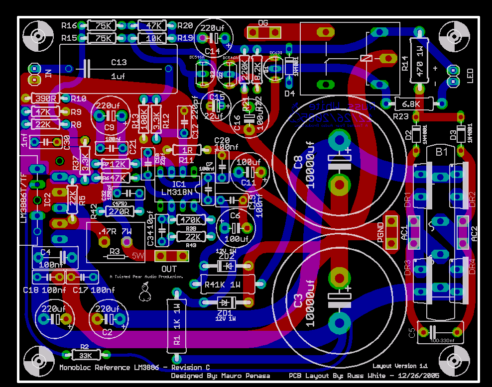

T., Which PCB did you use? I was not aware if you built the monoblocs which I layed out. There are some significant differences between that and Rudi's. Not that either is better, but they may indeed sound different.
It can be confusing to those reading the posts if they do not know which amp you built.
One thing to note, quite a lot has happened off the forum, including a new My_Ref Rev. C version 1.1 based on new input from Mauro which has led to a few small tweaks for the PS (discrete rectifier diodes) and the input cap.
If there is interest I will share it.

since I've built the REV A prototype and sounds great, I will make 3 more PCB's. I'm interested. If I will build more amps, the lastest version is what I want.
Thanks!!!!
Jorge.

Hi Russ,
I actually etched Rudi's mainly because of the dual rectifiers which would allow me to upgrade later although I first used standard parts as recommended on here, I also did not fit that resistor to the LM318 to start with so to keep everything as close to the original as I could, I then started to try different parts.
Your board may sound different to Rudi's but would there be such a big difference?
I've already tried a lot of mods,component changes etc including disconnecting all the psu and trying something else, I just stuck to what ever sounded best in my set up
No doubt all the parts I use would not suit everyone including the choice of rectifier diodes or coupling caps etc
I still have Rudi's new board to try too, I'm not sure how its going to compare against this RevC setup I have settled on but like everything else, I'll try it out because I promised a while ago I would
The RevC is still good but please do remember this is not the only amp I have built,infact I now have around several different diy amps to compare it against🙂
V. 1.1
Monobloc MyRef Version 1.1 🙂 Still a work in progress, but coming along nicely.

Absolutely there could be an appreciable difference, a layout indeed can make or break any circuit. In this case I seriously doubt the difference is huge, maybe not even detectable, but one would have to build both with the same parts and everything else being equal to know.
My only goal was to have people know which is which, since clearly the comparisons are not apples to apples.
