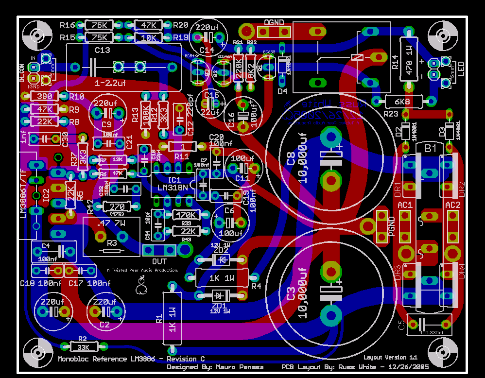

Russ,
Re: My_Ref Rev C Ver 1.1.
Would this board be directly interchangeable with the previous Rev C board?
That is, are the board mounting holes identical, and is the LM 3886 at the exact same location on the board, so that it will mount the heatsink at the same hole?

Good question.
Yes, this board should be a drop in replacement if you already have a production rev C. The mounting holes are the same, and the LM3886 is in the same spot, so your existing case and mounting hardware could be reused.
It will even directly replace the pre-production(beta test) Rev C except that the LM3886 was moved a bit to get it more centered when it went final. The PCB mounting holes are the same though.

Nordic said:I just remembered something about constructing my Rev C, the wire holes for the output cables were way too thin....
Thats because those aren't wire holes. Those are Faston pads for male faston connectors. And the input and LED connections are pin headers with pin header pads.
The pin spacing for the output fastons will allow for some types of screw down terminals too.
If poeple want them I can easily add holes for wire beside the connector(faston and pinheader) pads.

Thanks for all the good feedback. Here is what the new layout looks like right now. Just a few small things I want to do on the silk screen and it will be done.
Notice I added wire pads for the power in,led +, led -, out, out gnd, in, and in gnd. For the input and led connectors I used 5mm spacing to allow for 5mm type screw down terminal blocks.

Very nice. It just stuck me that you can use a componet BR or descrite diodes... Very nice indeed.
One note, not even a suggestion, is that you "could" make the ground plane under C3 and C8(?) larger such as the area under C9.
Just a note, I don't know how that would affect the different analysis you have done using the trace tools Mauro pointed out.
