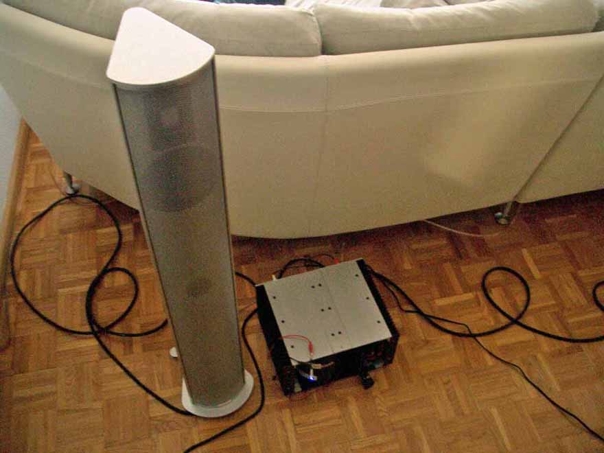

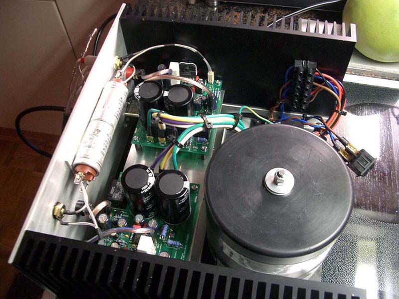

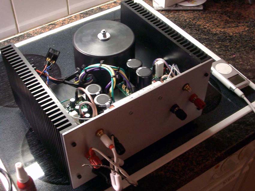

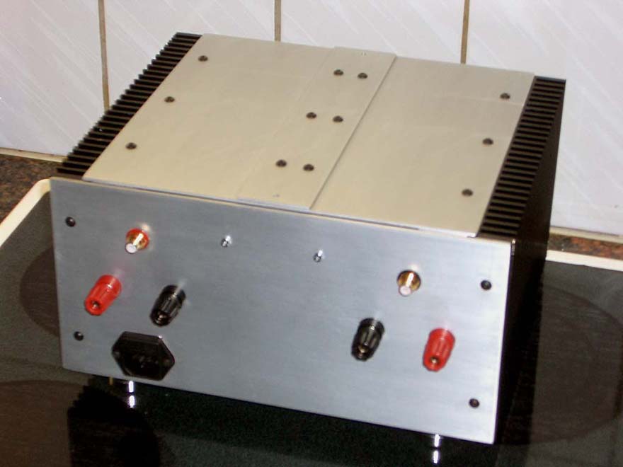

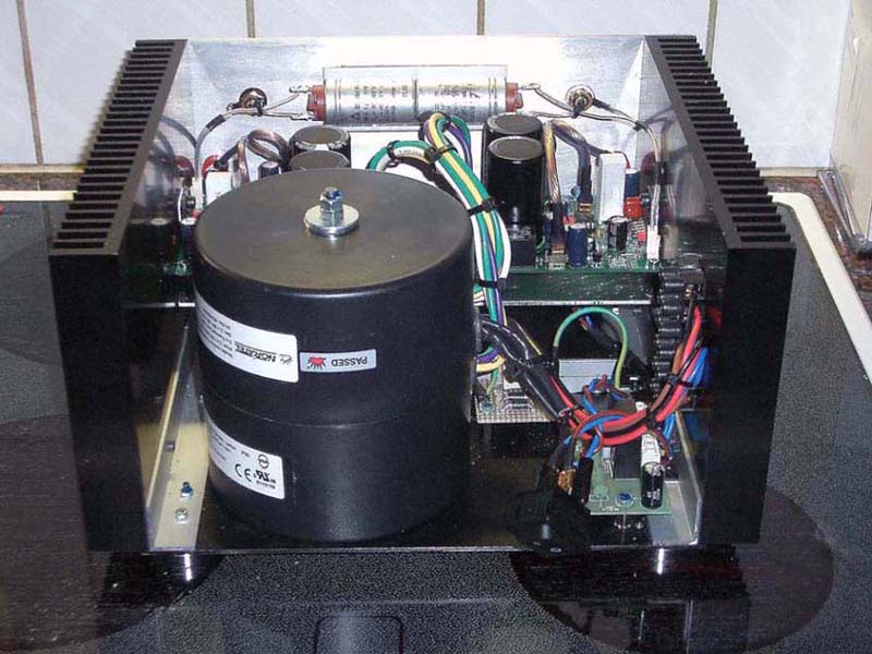

The KTA -"kitchen table amp"....
This is my first post to this forum, although I was lurking in the background for quite a while. After having completed the Twisted Pair MyRef_C kit some time ago, I think it is about time to give this thread a bit of momentum back, or let’s say positive energy! I was tempted to build the MyRef_C amp because the usual GC iterations start to get really boring to look at, if not to listen to (uhoh!)... Recently I do see some MyRef_C builds suffering from assembly/soldering problems – so I can simply reconfirm this amp has worked flawlessly from the very first second after power up – no DC offset issues, switch on thumps and/or other nasty things to deal with.
A big thanks to Mauro Penasa to offer his brilliant design to the DIY community. It detours some of the usual pitfalls seen with several GC variants, yet this isn’t a gainclone - - but stunningly – I think it brings out the best the LM3886 chip has to offer sonically..... Further praises definitely go to Russ and Brian for their RevC kit offering, which can be considered to be complete, as well as quick and easy to whip up.
Here we go:
The heatsinks I have chosen, which are an integral part of the “enclosure design”, are somewhat overdimensioned not only to sustain good cooling. The sinks feature 25 x 15 x 3cm dimensions since I wanted to go for a small footprint amp with less than the width and depth of commercial 19” rack type enclosures. The taller build structure looks better for my eyes, and was necessary because I wanted to deploy two 300VA trannies. As for the parts changes that deviate from the TP kits, I used Rubycon ZA 220uF as C19 feedback caps (slightly lower E.S.R. than Panasonic FCs). Since Russ’s PC board design was optimized for a small footprint, I went along to have the input coupling capacitor mounted externally, just to be able to mount something physically larger than a standard 1uF MKT/MKP. In the end I settled for a Siemens MKV type, I had those lying around anyway.... Furthermore the amp houses an LC Audio inrush current limiter and a small perfboard, that carries a ground loop breaker circuit (two diodes, a 10R resistor and a 0.1uF 400V cap).
Everything else is pretty much standard as delivered with the TP kits. As with most amps and preamps, the mechnical work involved is the most challenging and time consuming part.
One thing to mention: I had to route wires from my ground breaker circuit to the P-GND terminals on the PCB, to get the amp quiet. It had a clearly audible and annoying ground loop induced hum without this connection.
So as for those that still wonder how the MyRef_C sounds, I can keep it short: Stunning! Tonal balance is neutral with good bass extension and balanced treble – while one thing really impresses me the most: The sound stage is huge and totally stable, with pinpoint accuracy (the often misused word “palpable” comes to mind...).
Cheers
Andre
PS: The front plate is not on yet, because it needs to be chopped off on top and it is 12mm thick on the sides....
