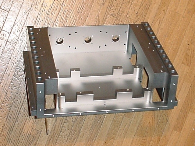

...had to change over to IE5, as I get kicked out after about 1 minute of typing. No clue what this might be - the moderator watching us getting more and more off topic???
For a cast and CNC machined housing as seen in the attached pic - well one thing for sure it does add a HEAVY dollar charge on top of the product BOM cost. Not that this would play any role for products in the price class of a Lyra preamp. Net margin is going to be lowered a tiny bit, but one can still make a good living I suppose..... For those that demand the best, price plays a secondary role haha!
Of course the wooden enclosure looks more "organic" and maybe - thinking as a potential buyer - this implies a more analog sound....? If it wasn't to obtain a bettter sound quality, it surely makes a good score on the list of things to have for marketing.

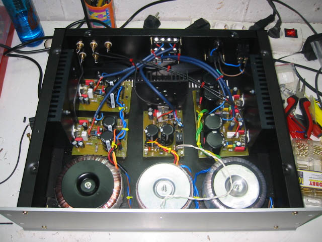

After some months of reading this huge thread i decided to build a 5.1 amp for my pc and here it is:
The 2 rev_c is used for the 2 front chanels, the rev_a is for the rear chanels and one rev_c for the center. 300VA trafo for the fronts, 160VA for the center and 200VA for the rear chanels 😉
