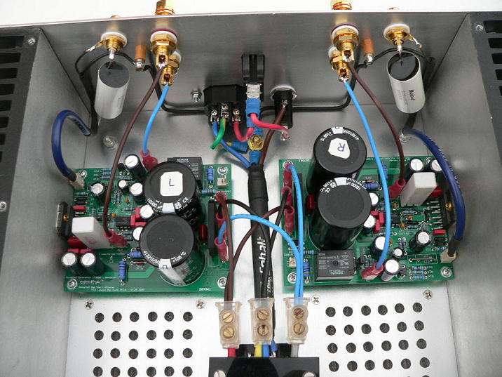

Finally have my TP Ref C Amp built and am in tte middle of burning it in.
With the variac set to 238v rms, the T/F sec.volts are 26v. The DC rails are +/- 35V.
The DC offsett is -1mv, with or without the preamp connected.
With an average 10W music signal at the 8 ohm dummy loads, the DC offsett mainly stays at a few -mv ,with momentary peaks to around -10mv.
I have upgraded a few components of the Twisted Pear kit:
Bridge Rectifier -- General Semiconductor GSIB2540 (25A,400V)
C9 --- Rubycon ZA 35V, 220mF
C21 --- Vishay Roderstein MKP 0.1mF, 160V
C13 --- Rel-Cap Multicap Film & Foil Polystryrene 1mF, 100V
All going well I should connect speakers tomorrow.
I'll attach some photos
Audie.

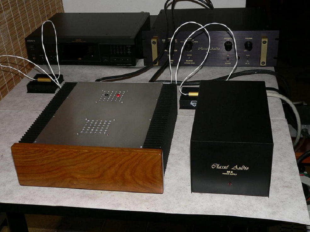

Russ,
Thanks for the kind words.
I wanted laser cut anodised panels, but the cost was excessive.
Hand finished plain aluminium still looks acceptable though.
I know I am going to enjoy Mauro's "My Reference".
Mauro's meticulous design work and your execution of a great kit, ensures it.
Thanks,
Audie.
I slipped up-again. I have both Brian and Russ to thank for providing the kits. Thanks guys.
Great implementation billabong!
I did my RevA with lasercut panels, and it turned out pretty well, but I like yours better 🙂 Mainly because the layout with the heatsinks on the side makes for an un-cramped rear panel.
What timber is the front panel?

Thanks maf_au,
I liked the idea of heatsinks for the side panels as it saved me work and provides a mounting for the remaining panels.
It looks good as well. No problem identifying it as anything other than a power amplifier.
The front panel was cut from my wife's 22mm thick dark Teak cutting board that she had rarely used.
If I should ever build the Kookaburra Preamp and the subwoofer active crossover, there is some left over for those too.
Audie.
