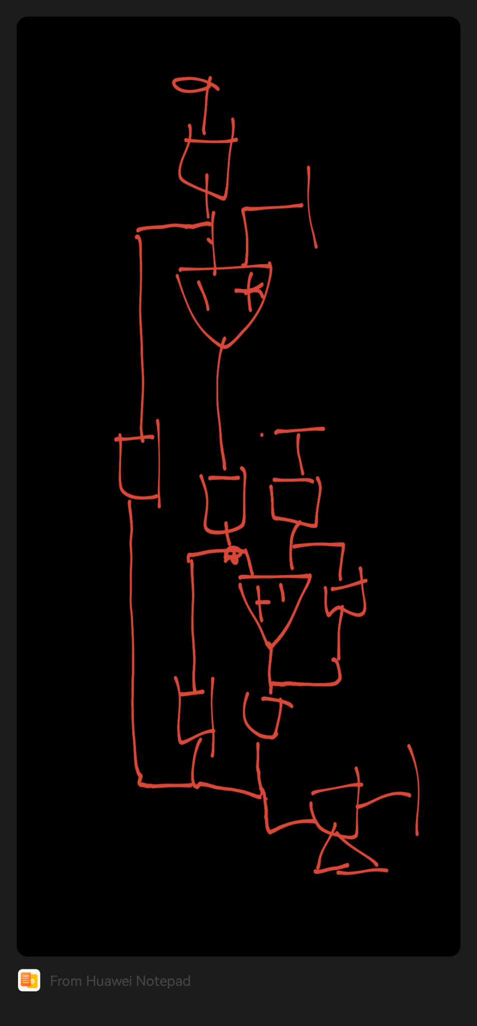

Is there a benefit in running the current pump in inverting mode or using an inverting output stage, thus switching the driving opamp input pins?
I'm ok with 'it sounds better', but if there's a technical reason to it I'm curious to know. I couldn't find a satisfying answer in this thread or Mauro Penasa's documentation.
1) that would make no sense at all.
2) You can't do that. If you reverse the phase of the current pump, you'd make the overall feedback positive instead of negative... BOOM!

in the second point he very probably points to the input common mode surpression capability of the opamps.
In my personal opinion, the worst offender in this sense is properly the LM3886. It's parameters, like PSSR for negative supply, and CMMR at the input are orders of magnitude worse than that of the input opamp. Using it in inverting mode eliminates the common mode component on it's inputs, and thus helps greatly to achieve the final very good distorsion values of the composite amplifier.
I agree that the PSRR of the controlling opamp is responsible for the good performance that can be had from a composite amp and also that the PSRR of the LM3886 could be better. I further agree that you can eliminate or reduce CM distortion by using the LM3886 in inverting mode. However, if you normalize the gain (i.e., use -20 V/V in the inverting amp and +20 V/V in the non-inverting amp) the difference between inverting and non-inverting is actually pretty small. I doubt you'd be able to measure a difference between two well-designed composite amps where one uses the LM3886 inverting and the other non-inverting. After all, the distortion of the LM3886 within the composite amp is reduced by the AVOL of the controlling opamp; so by 120-140 dB if you use a modern opamp.

Yes, the influence of the common mode errors at the input depends on the common mode voltage excursions present at the inputs. In case of less common mode signal the errors are less. In the general example that You brought up with standard, ~higher gain in the output stage (20V/V) --the input signal is lower, the problem of common mode errors are minimized. So there is no big difference between inv/ noninv. configuration.
But, let's have a look at the actual case of the MyRef topology. The output stage is a current pump, with a Gm close to 1 (by design) .. So the actual 'Voltage Gain' in the stage is dependent also on the Load, let's say 4ohm (like in my typical case..).
The Gain of the stage is:
Vout =Vin* Gm* Rload
A= Vout/Vin = Gm* Rload; if Rload =4
then
A = 4 in case of MyRef Classic
A = 6 in case of FE config
What I wanted to point out is that in this topology the output stage have less gain than what You supposed to have. So common mode is more of a problem. Difference between inverting/ noninverting output stage could be more relevant.
Last part is that in certain variations (Rev C..) there is some open loop gain limiting applied as compensation, for the LM318. And anyway, LM318 is not properly the same capability (Aol) as the latest modern chips..
So the original reasoning of Mauro definitely had it's good foundations with the applied inverting/ inverting topology..
All the best, George

As Tom pointed out above, the CM errors of the current pump make little difference because the current pump is inside the global feedback loop, and the upstream opamp provides loads of gain to correct these errors. Also, In Mauro's schematic, the current pump's opamp (the 3886) sees equal impedances on its inverting an non-inverting inputs, which minimizes the CM errors before the global feedback is applied.in this topology the output stage have less gain than what You supposed to have. So common mode is more of a problem. Difference between inverting/ noninverting output stage could be more relevant
Where CM errors do matter, however, is at the MyRef's input. While the 318's differential input signal is small, its CM signal is basically the amplifier's input signal. One way to deal with it is to make MyRef inverting. Another is to use a "better" opamp (e.g. with a cascoded input stage like OPA627, or something like OPA1641 which minimizes CM errors in a different way) instead of the 318, but this would require a different frequency compensation.
Yes, valid notes and in my case - I had started to fit more modern opamps years ago.. (OPA140 right as a start, then OPA627, ADA4627, OPA827..my present favorite is the OPA828, until/if it won't be de-throned by the OPA1655)
(We discussed a lot about the compensation with these chips in the FE building thread - and I feel it starts to converge lately, and not that hard to do)
The OPA828 is nice indeed. And unlike the OPA627 I don't have to remortgage my house to buy one, though it is still on the expensive side.

How would you do that? 🤔One way to deal with it is to make MyRef inverting.
I would say that one can play with this configuration, but maybe it would be useful to declare what kind of result should be achieved..
