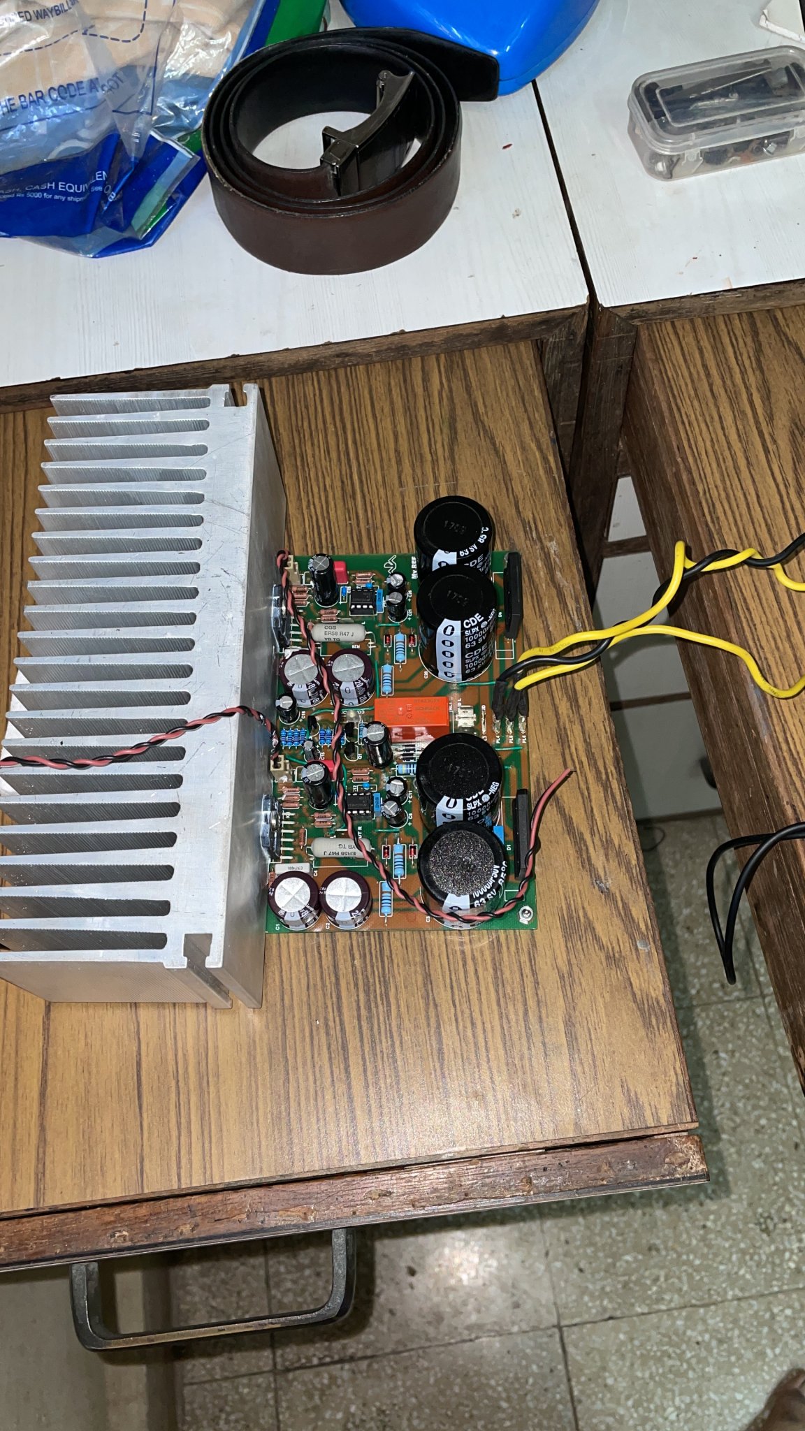

After years I've decided to build the RevC. last year, thanks to recent mandates. I'm not a pro, just the basics. But I have a very uncommon issue. I have a 180 degree phase shift between amps. It's very obvious, no doubt. Over software I shift the phase of one channel and we're back in business. Interestingly this shift is not present with a 4ohm load, different speakers per se. But 8ohms, phase shift! It's almost perfect to where I can flip the polarities of one speaker. Other than this discreetly the amps work just fine; no hum no noise, just perfect. By Mauro's (RIP) pdf's I'm guesstimating it's one of the compensation networks. All resistors are .1, caps are far from perfect. I'd be glad if someone can point me into the right direction before I start flipping parts.
Nevermind, thought I've checked the cables gazillion times from the board to the chassis, wondering how a perfect phase shift could even happen by compensation... but I had nothing left. One of them shrodinger moments.After years I've decided to build the RevC. last year, thanks to recent mandates. I'm not a pro, just the basics. But I have a very uncommon issue. I have a 180 degree phase shift between amps. It's very obvious, no doubt. Over software I shift the phase of one channel and we're back in business. Interestingly this shift is not present with a 4ohm load, different speakers per se. But 8ohms, phase shift! It's almost perfect to where I can flip the polarities of one speaker. Other than this discreetly the amps work just fine; no hum no noise, just perfect. By Mauro's (RIP) pdf's I'm guesstimating it's one of the compensation networks. All resistors are .1, caps are far from perfect. I'd be glad if someone can point me into the right direction before I start flipping parts.
