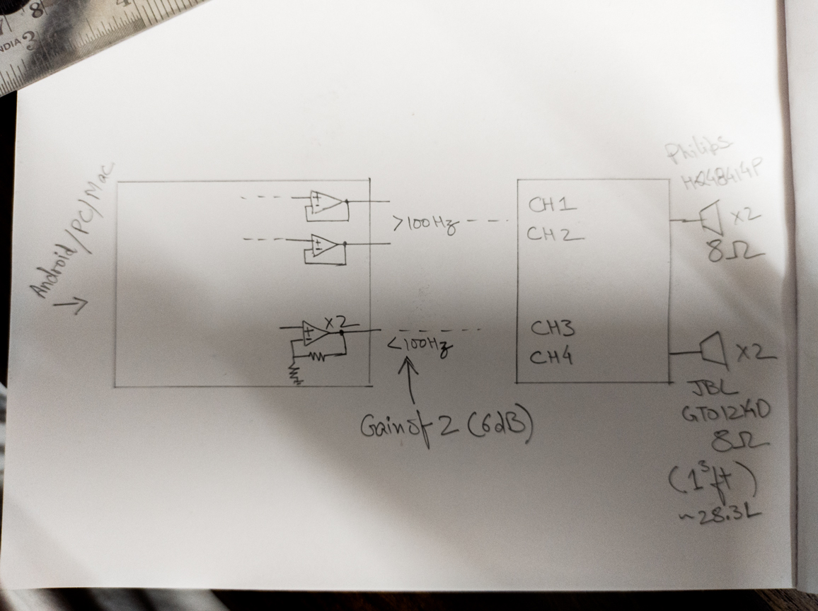

My "audiophile" LM3886 approach
Android connected to 2-way Crossover (100Hz)
Lowpass output buffer has a gain of 2 (~6db)
Myref_C coupled via 1uF input cap.

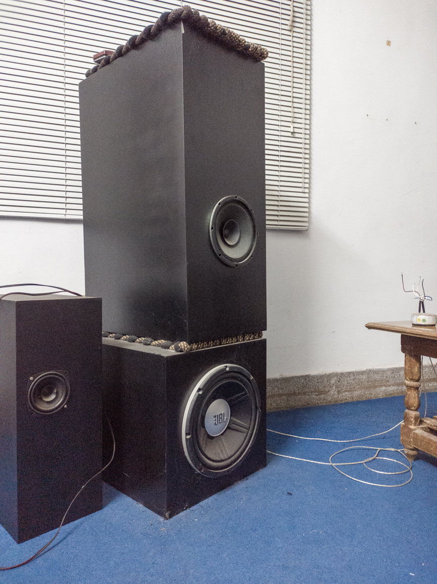

FullRangers: Philips HQ48414P 8 ohms (x 2)
Subs: JBL GTO1214D (x 2) 8 ohms housed in a 1 cu ft. sealed box.
I have a spare crossover which I think is 200Hz. Not sure if JBL can handle that high-end.
Since this amp is never going to be used with another pair, I can add the required boost to the subs. JBL rates them at 93 but at 2.83V which is equivalent to 86.71 W/1M as per WinISD (thus the 6db boost in the xover for subs).

Given that the LM318n is running at +/-12Vdc, does it mean I can use an input signal that swings at a theoretical max of +/-12Vdc to hit the full blast?
NO. The LM318 will only swing to within 2 volts of the supply rail, according to the datasheet. IMO, it is a poor choice for a crossover IC. These days, an LM4562 is only ~ $1.40 (qty 10) and is orders of magnitude a better opamp.
In a myref_C LM318-N is not used for crossover, neither is it a point of debate anymore. Please refer to the initial pages of this thread for the discussion.
My crossover uses LME49720 (removed OPA2134).
My suspicion is:
A. The room is too big for JBL GTO1214D. I'm in a 12' x 15' hall connected to a 10' x 20' gallery. My kinds on the top floor complaint of things shaking at 40Hz. However 2m away from the sub, there's little to write back home about.
B. The Philips HQ48414P doesn't go down to 100Hz.
C. Android headphone-out has a poor low-end. Because coupled with a Bluetooth received hooked to myref_C the bass is clearly audible. Thus my assumption of a pre-amp to bring up the levels at least to a reasonable level before feeding it to myref_C.
