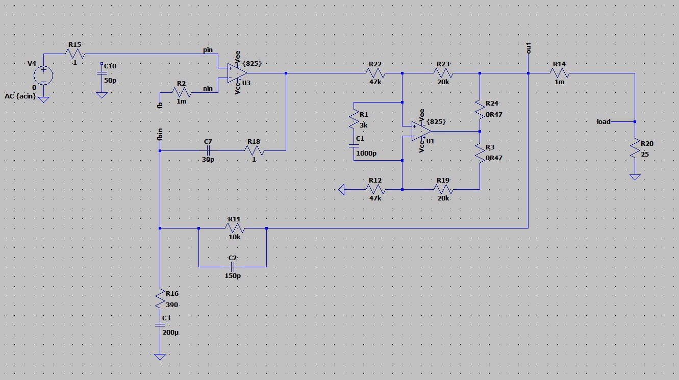

I vaguely agree with point 1. With the exception of C10 (which isn't used anymore if I'm not mistaken), there's no apparent difference in compensation between a double inverting or double non-inverting scheme.
I don't understand point 2. The common mode voltage on the driving opamp is the same in either configuration (as mentioned by alexcp). I was curious if something else could be meant by Mauro, which could only be understood by looking at each opamp internals.
I don't understand point 3 in terms of the difference between inverting/non-inverting current pump. Maybe a language barrier.

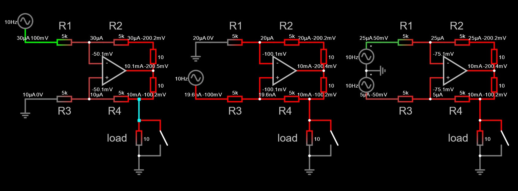

Is the common mode rejection of the LM3886 its limiting distortion mechanism? The current pump is a differential amplifier. Running it purely inverting halves the common mode voltage compared to the purely non-inverting configuration. I take that 3dB if that's a limiting factor. Having a larger input than feedback resistor as in the my_ref makes it overall worse, though.

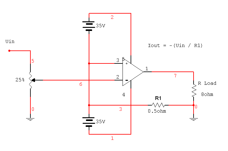

I like the idea of trying a current pump instead of the classic output buffer configurations. I guess there's nothing wrong running a configuration as attached? (I don't have a running LM3886 model in LTSpice yet, so bear with me. I only want to understand the overall topology at the moment)
Since this equals the classic composite amplifier configuration virtually any opamp could be used, I suppose. And eliminates any vagueness when compensating an opamp with its inputs swapped. Even though I find that insightful especially with the additional 1k input resistor as recently proposed by Joseph K and being discussed in the FE building thread.

Yes, you can do obviously also in this 'classic' double non-inverting configuration. Also I had played in these days with some thought-tests. Both this double non-inverting configuration and the input-inverting config brought up before can be massaged into work.
With inverting input there are loads of unconveniences, the only trustable way to make it working correctly is with an extra input buffer stage. And even then, it still inverts.. and all that only for that slight advantage of using the input opamp totally common mode signal free, in place of using it with a small level common mode signal. For me not really worth it.
The double non-inverting config is OK, classic. Using both stages in a less efficient mode, but OK as we had seen it.
Still there is a point: in the Myref arrangement at the ' Pin -In' the local FB loop is handled, at the ' pin +In' the global FB loop. So the respective compensations are working on separated nodes. Add to this the separated function for the input RF filter, (my latest mod) - and it results in a system nicely managed in separated blocks.
In the 'classic' double noninverting config (your sketch) the global/local compensations are all working onto the -In Pin. (The same for the config with inverting opamp input..) And I have noticed in the sims this less favorable condition. (the modded Myref Config is more 'efficient').
Not a big problem, difference, it will obviously work, one notes the difference only in direct comparison.
Yes, drawn on paper it looks so nice. Both for the input stage and the current pump. For the input stage as you described it and for the current pump it looks as if the input signal is handled by the negative feedback branch and the output signal by the positive branch. But I'm not sure if it is only the brain which forces you to think this way, because it is drawn that way, or if there's an electrical point to it. At least global phase response looks slightly different.
Hmm, my crude opamp simulation seems to prefer the double noninverting config for HF phase response... until I add small series resistances to the feedback capacitors. (No undamped series capacitors with me.) There certainly is a benefit in isolating the local feedback from the global feedback. Be it by the my_ref configuration or by isolating the local from the global feedback point be several kilo ohms at the cost of error correcting feedback. At least loopgain and transfer function look prettier that way, but who knows if that is audible.
